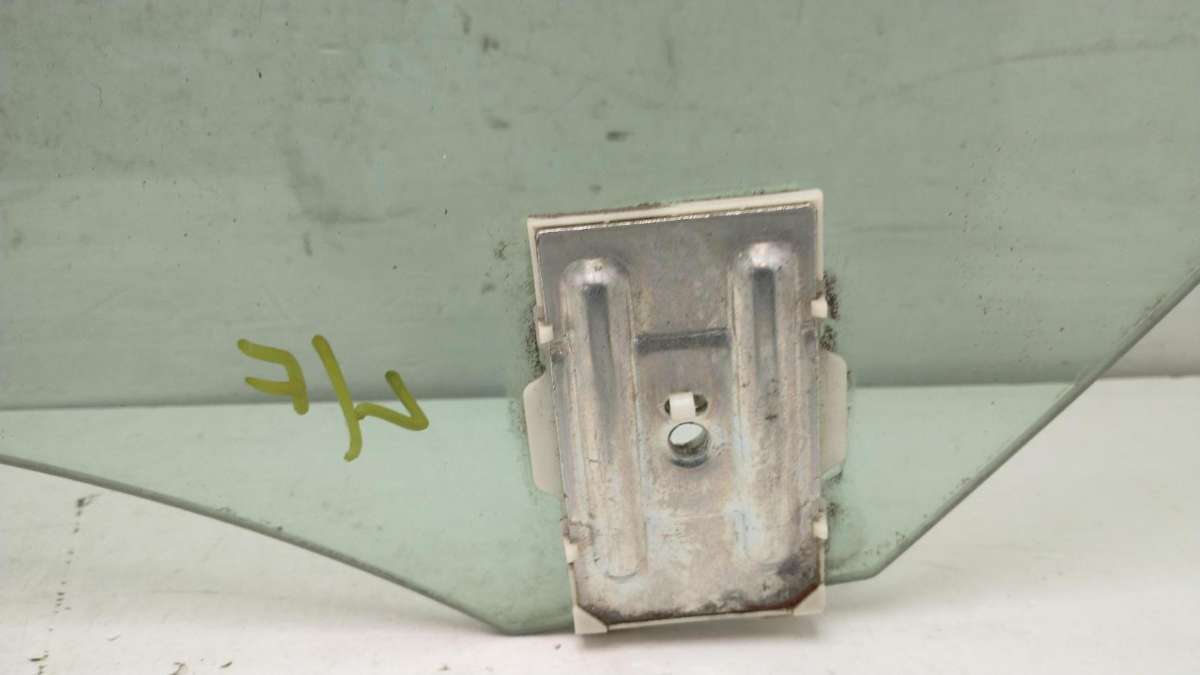

I've been working inside of the door panel to fix an issue with my passenger door latch and noticed that the clip used to grip onto the window is cracked to where only pressure from the screwing the bolt in holds it on. It doesn't seem to be too problematic but I noticed the glass is a tiny bit more loose than the drivers side and can moved up/down when the door is open. It still goes up and down fine with the motor and seals when the door is closed but not sure if that bit of play is going to be a problem.
This is the part I'm referring to (picture taken from Google, not my car):
What do you guys think? Should I try to find a replacement part?

Unfortunately it looks like this isn't sold by Nissan seperately, the diagrams show it being part of the window/glass assembly and it doesn't have its own part number. The only way to replace it would be to find some sort of similar aftermarket alternative on the likes of eBay or fix the existing clip. Alternatively you could try someone breaking a Z but it's highly unlikely they'll want to sell you that clip without you purchasing the whole window from them.
