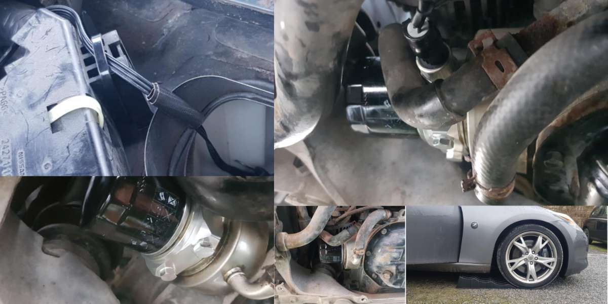

It is a tight squeeze in there! Barely could slide under the car with the small ramps but managed, couldn't even fit a torque wrench to fasten the sandwich plate with the factory cooler in place, had to trust the feeling and thread lock to do the job but so far so good. After warming up the engine no leaks found and shows over 20 psi at idle and 50 psi at 2k RPM which is satisfactory. Took it for a test drive, going to check for leaks again tomorrow and put the undertray back. Pulled the cable around the back of the engine and through the cabin filter behind the glovebox, the cable length was just enough, still have to power it but for now putting bare cables into a lighter socket works :lol:
