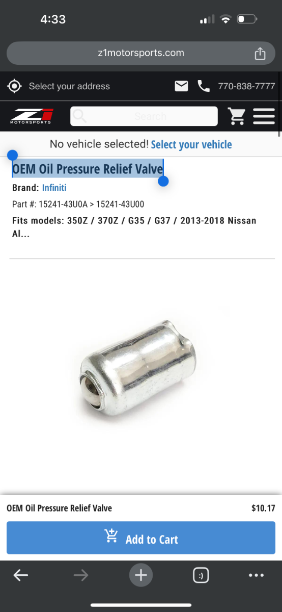

Vq.zzx Posted October 22, 2024 Posted October 22, 2024 Hello im having a bit of a problem i had gotten my engine rebuild but the shop forget to put the new oil pressure release valve in the upper oil pan does anyone know how to get it in the upper oil pan Quote
Vq.zzx Posted October 22, 2024 Author Posted October 22, 2024 This is the oil pressure relief valve if need I can take a pic of where it goes Quote

Vq.zzx Posted October 22, 2024 Author Posted October 22, 2024 How would you go about putting it in and can I run the engine with out it in case I need it take it to a shop i know it dumb to ask as if probably helps hold the oil pressure Quote
ZMANALEX Posted October 22, 2024 Posted October 22, 2024 Why not take it back to the shop that built your engine as they are the ones that messed up? In answer to your question, you can not run without the valve. Why do you want to change the valve? Quote
Vq.zzx Posted October 22, 2024 Author Posted October 22, 2024 1 hour ago, ZMANALEX said: The image in the schemati 4 minutes ago, ZMANALEX said: Why not take it back to the shop that built your engine as they are the ones that messed up? In answer to your questionyou can not run without the valve. Why do you want to change the vachange it I I don’t want to change it the shop forget to put it in so I’m trying to get a understanding of how to put it in so that why I can get the motor started for the first time Quote
ZMANALEX Posted October 22, 2024 Posted October 22, 2024 So are you saying that the shop built the engine and forgot to fit the valve? In that case, simply tap the new valve into the hole where the valve is meant to be. INSPECTION AFTER REMOVAL Oil Cooler Check oil cooler for cracks. Check oil cooler for clogging by blowing through engine coolant inlet. If necessary, replace oil cooler. Relief Valve: Check relief valve for movement, cracks and breaks by pushing the ball. If replacement is necessary, remove relief valve by prying it out with suitable tool. Install a new relief valve in place by tapping it. INSTALLATION Note the following, and install in the reverse order of removal. ● Make sure that no foreign objects are adhering to the installation planes of oil cooler and oil pan (upper). ● Align cutout on oil cooler with protrusion on oil pan (upper) side, and tighten connector bo 1 Quote
