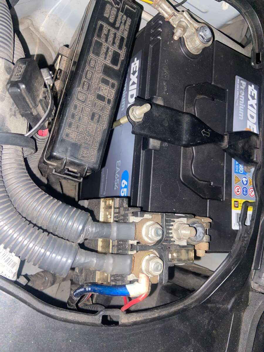

mr v6 Posted September 19, 2024 Share Posted September 19, 2024 Make sure your battery connections are tight! I had this exact issue a few times when I first bought mine, clocks would light but, but nothing on cranking, try again & it was fine. Turns out my battery connections were not tight, nipped them up & the issue went away. Quote Link to comment Share on other sites More sharing options...
miller_350 Posted September 20, 2024 Author Share Posted September 20, 2024 Thank you. Hoped that would be the case with new battery recently but all seems fairly tight unless you can see anything in the picture? Quote Link to comment Share on other sites More sharing options...
