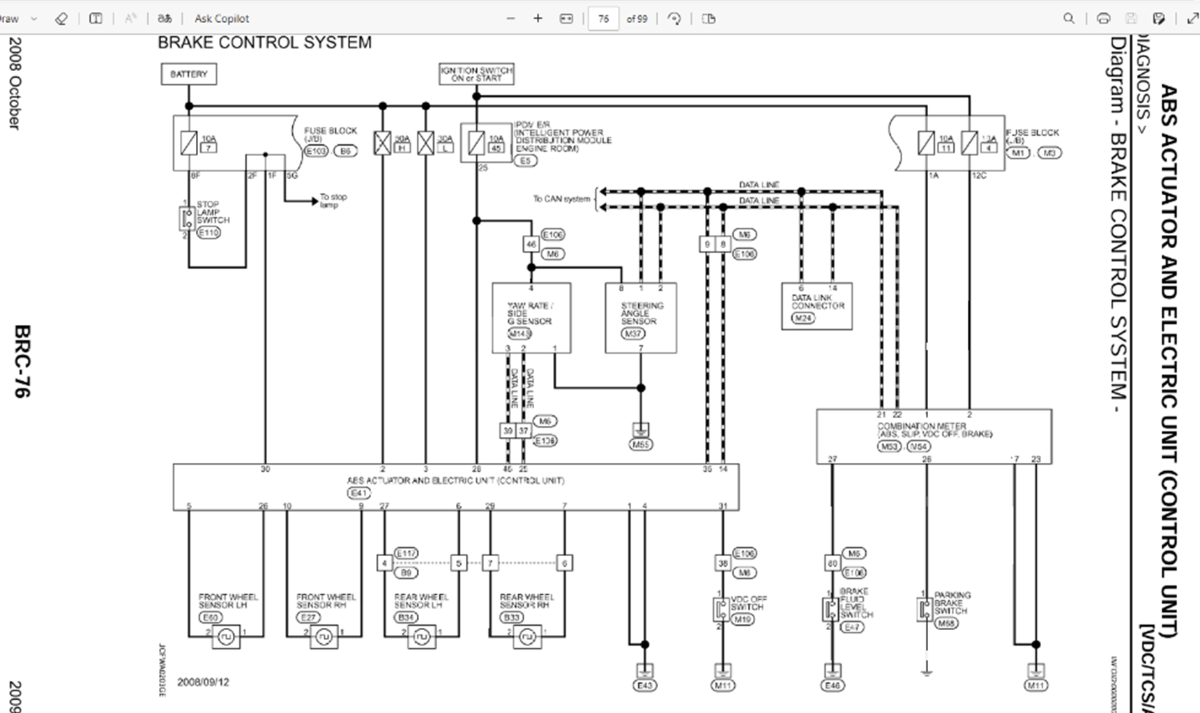

Keith D Posted November 11, 2024 Share Posted November 11, 2024 Sounds like the car thinks one wheel is continually slipping. I'd stick a multimeter on the wheel speed sensors, first check they have battery voltage, then disconnect and check resistance across them. If its not the same left to right or resistance is zero, its a fault with the wheel speed sensor / wiring. If its not at battery voltage to begin with its a fault upstream, maybe in the ABS module. Quote Link to comment Share on other sites More sharing options...
da.murf Posted November 11, 2024 Author Share Posted November 11, 2024 58 minutes ago, Keith D said: Sounds like the car thinks one wheel is continually slipping. I'd stick a multimeter on the wheel speed sensors, first check they have battery voltage, then disconnect and check resistance across them. If its not the same left to right or resistance is zero, its a fault with the wheel speed sensor / wiring. If its not at battery voltage to begin with its a fault upstream, maybe in the ABS module. thank you input and thoughts, if it was the ABS module would the ABS light also not be on? Quote Link to comment Share on other sites More sharing options...
Keith D Posted November 11, 2024 Share Posted November 11, 2024 (edited) Not necessarily, depends on the fault. If the speed sensors check out I'd probably next do a continuity check between the speed sensor plugs and the ABS module plug to rule out that part of the harness (loose plug, pins, broken wire etc). Then personally I'd move on to testing the yaw rate sensor and the steering angle sensor. JMHO others might have a different approach. Edited November 11, 2024 by Keith D Quote Link to comment Share on other sites More sharing options...
