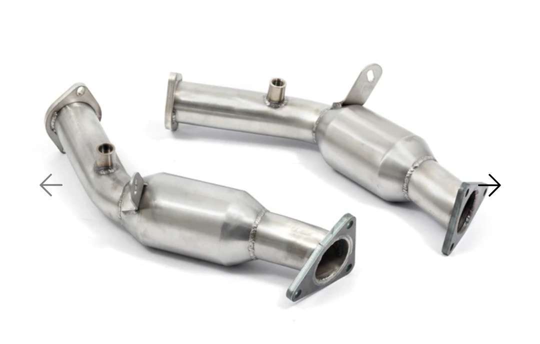

stetrigger Posted July 9, 2024 Author Share Posted July 9, 2024 Mine are definitely not OEM then. They look more like this. Only not as shiny. Quote Link to comment Share on other sites More sharing options...
ZMANALEX Posted July 9, 2024 Share Posted July 9, 2024 As I previously have said, may be de-cats/test pipes or sport cats. Quote Link to comment Share on other sites More sharing options...
