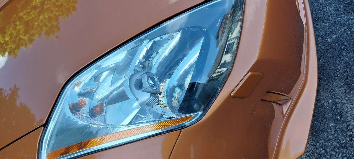

neo Posted June 21 Share Posted June 21 (edited) My 370z Passenger headlight was getting a little cloudy so tried some Autosol metal polish rather than buying a kit, only put a small amount on each time to check the cleaning progress, did 3 passes using a small rag (cut up sock 🤣) to apply then polished with a microfibre  Came up a treat, looks much better now, dunno how long they will last but when i clean the car i'll use whatever wax/detailer i have to hand to slap on it Edited June 21 by neo 5 Quote Link to comment Share on other sites More sharing options...
Andy_Muxlow Posted June 21 Share Posted June 21 They look loads better. You would be better getting some 2k clear coat and applying that instead of just wax, or even having a ppf film added. 2 Quote Link to comment Share on other sites More sharing options...

mr v6 Posted June 22 Share Posted June 22 Have tried Autosol myself & it worked ok. I went onto Autosmart EVO & it did the job too, but my bottle of that has long since expired. I now use 3M & found it corrected the light much quicker. This is something I do every 6 months, so you'll no doubt be doing it again by the end of the year / start of next. Looking good though. Put a bit of hard wearing wax over it. 1 Quote Link to comment Share on other sites More sharing options...

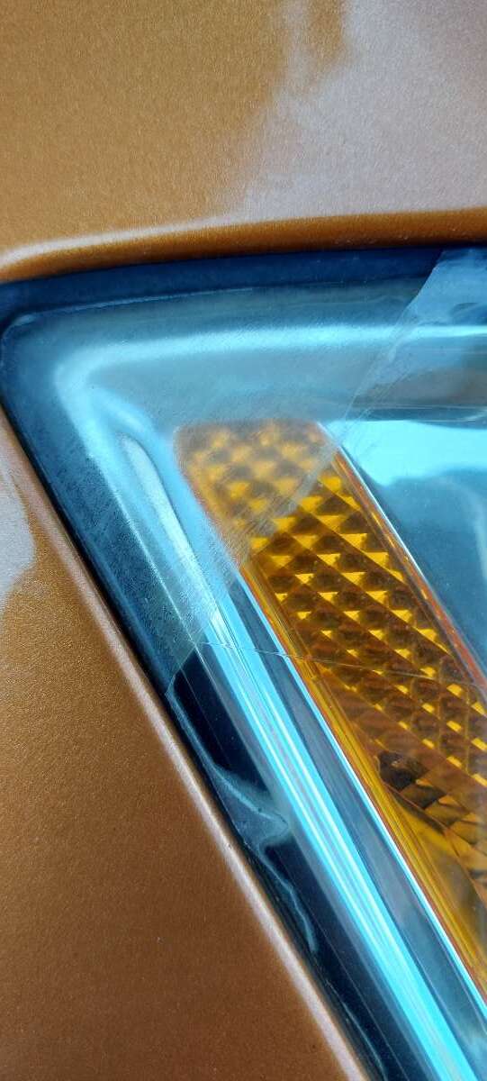

HEADPHONES Posted July 8 Share Posted July 8 I did mine August 2021. Then I wrapped them with clear PPF. Over the years a corner of the PPF came off. You can see how this corner re oxidizes but the wrapped part is still fresh 1 1 Quote Link to comment Share on other sites More sharing options...
neo Posted July 8 Author Share Posted July 8 Thanks for the pics, PPF really does its job Quote Link to comment Share on other sites More sharing options...
