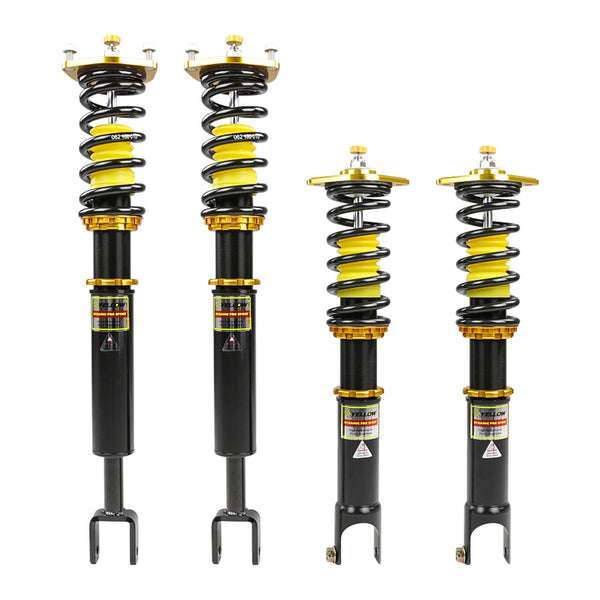

flexy97 Posted May 27, 2024 Share Posted May 27, 2024 Im looking to buy coilovers for my 350. My choices are MeisterR CRD, BC br, Tein flex Z and HSD Monopros and YSR (yellow speed racing). From my research :MeisterR are good and good customer service,but they are not true rear style which i wanted initially. Tein are bad from what i heard + they tend to leak and awful customer service BCs are taiwanese crap that is overrated by youtubers YSR : well,i got nothing for them HSD:rusty,bad customer service from driftworks + i saw a couple of guys with front shocks literally failed(bent where they mount to the control arm) + from what i saw rears dont go lower than stock height ? which is absurd. Any info would be highly appreciated from people that actually have driven on track. For what i will use the car: 70% track driving,other 30% motorway/city driving. and yes,the car is polybushed in the front,partially in the rear + yes,i have rear toe arms(to delete the buckets if i decide to go with true style coils). Initially whats important to me is,if something goes wrong like leaking i want to get replacement now, hence i dont want to import something from USA and if something goes wrong i have to wait for shipping from usa to europe. Quote Link to comment Share on other sites More sharing options...

flexy97 Posted May 28, 2024 Author Share Posted May 28, 2024 BC is out of picture,spoke with enough people in the motorsport,not one said that BCs are worth anything and i wont risk it. Im looking right now at yellow speed, they look exactly the same like your WAT ones,i wonder are they made in the same factory Quote Link to comment Share on other sites More sharing options...

davey_83 Posted May 29, 2024 Share Posted May 29, 2024 14 hours ago, flexy97 said: BC is out of picture,spoke with enough people in the motorsport,not one said that BCs are worth anything and i wont risk it. Im looking right now at yellow speed, they look exactly the same like your WAT ones,i wonder are they made in the same factory Yellow speed I don't think are a bad bet either, however don't look the same as WAT Racing. The later has forged ally lock rings, top and lower mounts with 40 way damping. Quote Link to comment Share on other sites More sharing options...
flexy97 Posted May 29, 2024 Author Share Posted May 29, 2024 @Coz@TORQEN Spoke with main man in motorsport from where im from, they refurbish suspension components and to say the least he said absolute NO NO for BCs, keep in mind our roads are no comparrison for good UK roads(yeah,they are good in comparison with some other ..) as for TEIN,i will go for TEIN flex Z for sure if i cant find true coilovers alternative(MeisterR or maybe D2),as tein arent unfortunately true style coils. @davey_83meh they kinda do xD, jokes aside saw a thread from years back in a different forum, one guy dismantled YSR coilover just for the sake of it, he said he is not impressed at all, poor quality, dont know if anything changed till now but wont risk it.Now im looking either at MeisterR if they can make me true coil set or D2 coilovers as i saw they actually sell them from France.Last resort is TEIN as its not true coil style unfortunatelly. Quote Link to comment Share on other sites More sharing options...
