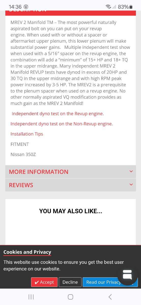

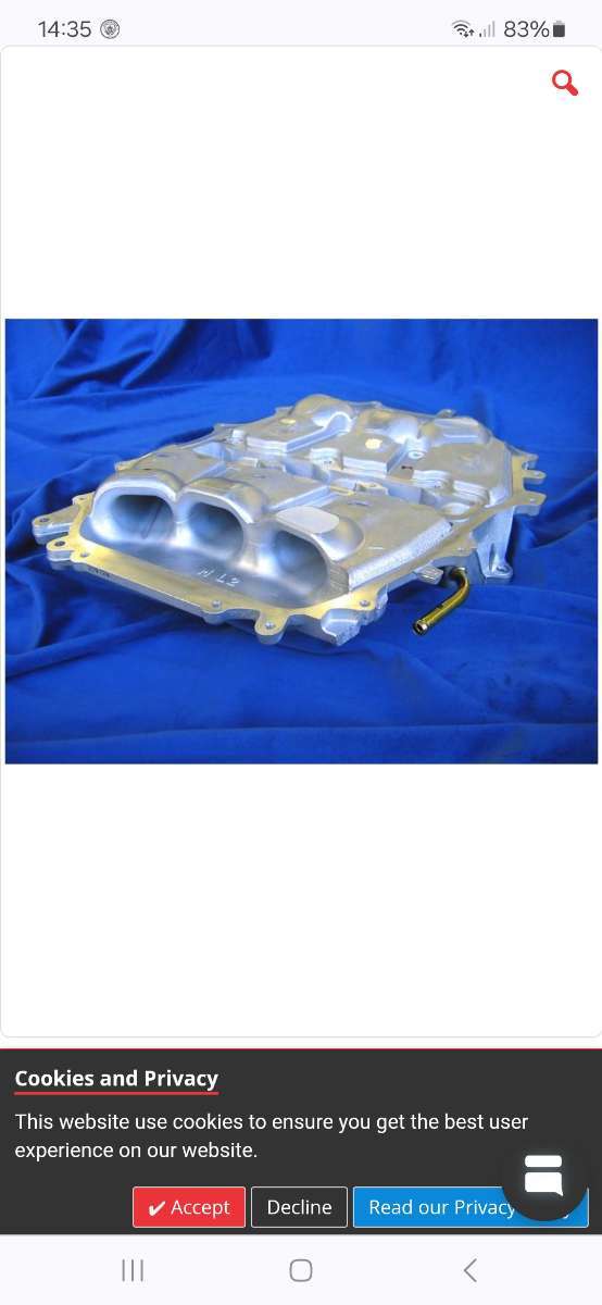

davey_83 Posted February 5, 2024 Share Posted February 5, 2024 12 hours ago, MONKEYSOCKS said: Hi mate, thanks for that. Getting mrev2 spacer fitted soon when I get remap so I'm sure they'll spot if there is oil where it shouldn't be. 👍 Nice one fella, got a picture of the mrev2 spacer? Never heard of it before Quote Link to comment Share on other sites More sharing options...
SWoMP Posted February 5, 2024 Share Posted February 5, 2024 22 hours ago, davey_83 said: There are plenty of UK non GT spec 350z, they're called Touring model. These came with cloth seats, no Bose or cruise control. I would say the GT4's had the same engine as the facelift cars, no reason to think otherwise. I've checked my notes and with a couple of friends who had early cars, and I was wrong - sorry! There was a base model and one of the differences was they didn't have Rays wheels. However (I'm told) they did have Brembos, unlike the rest of the world Base models which didnt. And, fwiw, the GT4 was the first to get the Rev-up engine, which later in 2005 was adopted as standard. Quote Link to comment Share on other sites More sharing options...
MONKEYSOCKS Posted February 5, 2024 Author Share Posted February 5, 2024 5 hours ago, davey_83 said: Nice one fella, got a picture of the mrev2 spacer? Never heard of it before Quote Link to comment Share on other sites More sharing options...
MONKEYSOCKS Posted February 5, 2024 Author Share Posted February 5, 2024 Just now, MONKEYSOCKS said: Don't think I'll get anything like the gains that they say, even with the 5/16 motordyne which I also have, but with the Map I'll hopefully get a bit more midrange torque. Quote Link to comment Share on other sites More sharing options...
