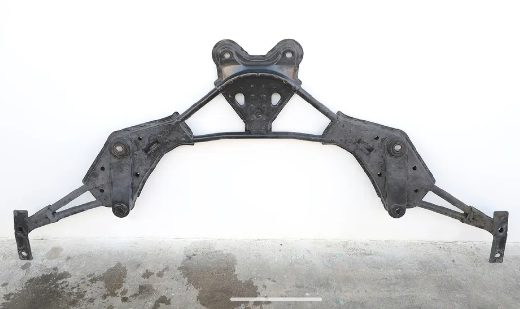

davey_83 Posted November 20, 2023 Share Posted November 20, 2023 (edited) That's the front brace, bolt on/off item shown below - 8 bolts. Forums are great places for info on these cars. Aftermarket item available also. https://www.tarmacsportz.co.uk/ultra-racing-nissan-350z-front-lower-brace-1.html?gad_source=1&gclid=Cj0KCQiApOyqBhDlARIsAGfnyMrqkQNS8Fldolt1RdMPqpKMemXw01_fW4o9kOmqqnN8QBJh2BpEBDwaAoHoEALw_wcB Exhaust wise, a used stainless item can be had cheap - all ideas and yours looks a lovely example otherwise. https://www.ebay.co.uk/itm/225874197418?mkcid=16&mkevt=1&mkrid=711-127632-2357-0&ssspo=DkkyrK2JQ5C&sssrc=4429486&ssuid=UVSJOLRJSwe&var=&widget_ver=artemis&media=COPY Edited November 20, 2023 by davey_83 1 1 Quote Link to comment Share on other sites More sharing options...
Cosmic73 Posted November 20, 2023 Share Posted November 20, 2023 I've just removed the front brace from a 2006 Z and it was very simple to do. Just spray the 8 bolts with wd40 the day before and use a bastard big breaker bar to crack off the nuts. Even the front subframe wasn't too bad, again loads of wd40 and a breaker bar. My Winter project post describes in more detail. Both parts are getting powder coated. It's a shame to scrap a stunning car that's served you well for the sake of a few bolt off parts. 1 2 Quote Link to comment Share on other sites More sharing options...
