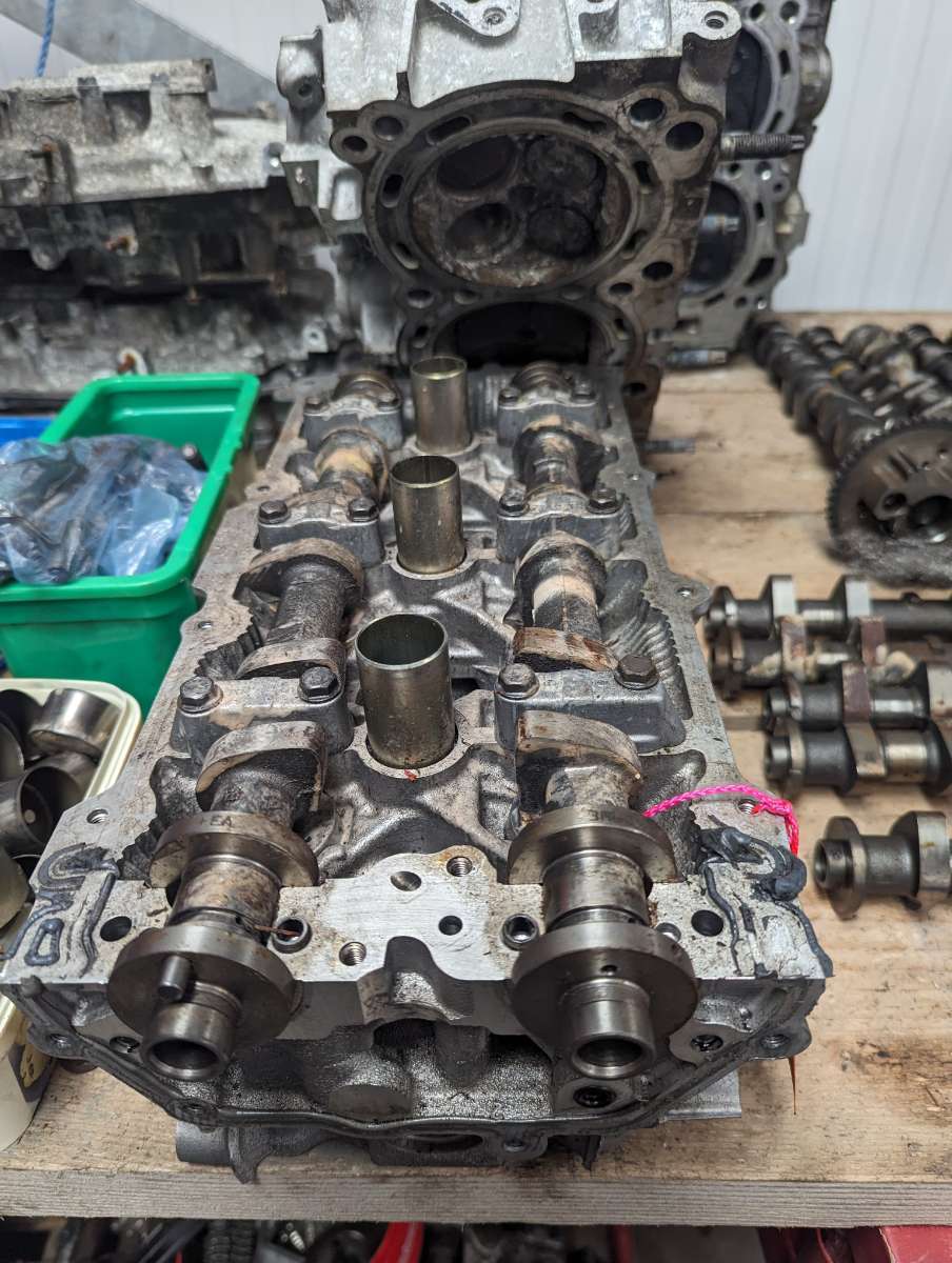

angelsanzbriz Posted October 21, 2023 Share Posted October 21, 2023 Has anyone had water getting into coil pack no 2 it's definitely coolant emptied it out 1000 miles ago now got some in again but its that small a leak I can't find it only 2 hoses near and above this are the heater pipes to the throttle bodies but I can't see a leak in them just wondering if anyone else had this when wet it causes a slight misfire Quote Link to comment Share on other sites More sharing options...
angelsanzbriz Posted October 22, 2023 Author Share Posted October 22, 2023 Please can someone tell me can this be from a cracked head I can't find any hose leak I have left covers off today and drove all day I can't find a leak anywhere from up top.the car drives fine definitely no oil in water and no water in oil. But I can't see how this coolant is getting very slowly into coil pack no 2 first one on the right.it takes about 1000 miles before there is enough to start a misfire. I can see I rubber seal down between rocker cover and head but this I am sure is an oil seal . Any help any ideas really appreciated Quote Link to comment Share on other sites More sharing options...
ZMANALEX Posted October 24, 2023 Share Posted October 24, 2023 Please confirm if this is a 350 or 370. I have had this once on a 350 but not a 370. The area below the coil pack tube was porous (not cracked) around the spark plug area. The head is internally cooled by coolant passing either side of the coil pack aperture and below the aperture. Heads for 350 and 370 are in stock if required. 1 Quote Link to comment Share on other sites More sharing options...
angelsanzbriz Posted October 24, 2023 Author Share Posted October 24, 2023 It's a 370 Quote Link to comment Share on other sites More sharing options...
ZMANALEX Posted October 24, 2023 Share Posted October 24, 2023 1 minute ago, angelsanzbriz said: It's a 370 370 heads complete with valves and cams are in stock if required. 1 Quote Link to comment Share on other sites More sharing options...
angelsanzbriz Posted October 24, 2023 Author Share Posted October 24, 2023 I'm doing some more investigation at the weekend with an endoscope and presure tester to try and confirm what kind of money are we talking about ohh and thanks for the reply Quote Link to comment Share on other sites More sharing options...
angelsanzbriz Posted October 28, 2023 Author Share Posted October 28, 2023 Head gasket fine head leaking coolant up around spark plug Jesus bad news what to do now Quote Link to comment Share on other sites More sharing options...
