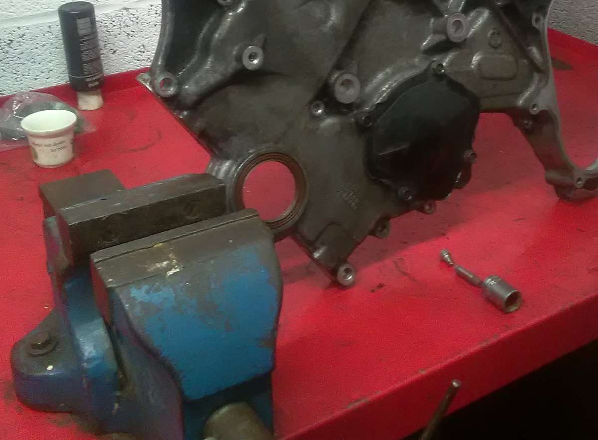

ZMANALEX Posted February 17, 2024 Share Posted February 17, 2024 The correct way to fit the timing cover is to leave the dowels in place as they do serve a purpose. The problem that you are having is that the front cover should be fitted before the mid-sump. if you fit any other way then you run the risk of oil leaks from the front half moon packing immediately or in the near future. Quote Link to comment Share on other sites More sharing options...
Mark@Abbey m/s Posted February 17, 2024 Share Posted February 17, 2024 so the way to fit the front cover with the sump already fitted is to remove the dowels from the engine , measure the dowel run the same size drill through the front cover so the dowels slide into the cover nice and easily. fit the front cover then refit the dowels to position the front cover in the correct position. Quote Link to comment Share on other sites More sharing options...
SWoMP Posted February 17, 2024 Share Posted February 17, 2024 Regarding your first post, I think the Haynes manual for the 350 originates in the USA and is therefore left-handed! Just in case anyone else is looking... Quote Link to comment Share on other sites More sharing options...
Cosmic73 Posted February 17, 2024 Author Share Posted February 17, 2024 6 hours ago, SWoMP said: Regarding your first post, I think the Haynes manual for the 350 originates in the USA and is therefore left-handed! Just in case anyone else is looking... I never realised that, I assumed Haynes was all UK spec. Thanks for sharing 🙂 Quote Link to comment Share on other sites More sharing options...
Cosmic73 Posted February 17, 2024 Author Share Posted February 17, 2024 8 hours ago, ZMANALEX said: The correct way to fit the timing cover is to leave the dowels in place as they do serve a purpose. The problem that you are having is that the front cover should be fitted before the mid-sump. if you fit any other way then you run the risk of oil leaks from the front half moon packing immediately or in the near future. I agree, but it's all about risk and as for as the half moon is concerned, it shouldn't notice any difference as it will be where it needs to be (without it being manipulated) and then dowels will then secure it exactly in position. As far as I can see it should be ok. Quote Link to comment Share on other sites More sharing options...
Cosmic73 Posted February 17, 2024 Author Share Posted February 17, 2024 (edited) 6 hours ago, Mark@Abbey m/s said: so the way to fit the front cover with the sump already fitted is to remove the dowels from the engine , measure the dowel run the same size drill through the front cover so the dowels slide into the cover nice and easily. fit the front cover then refit the dowels to position the front cover in the correct position. You read my mind! 🙂 The dowels were in the cover not the engine but came out nice and smoothly using my vice, a 10mm socket as a dolly and small bolt. I've give everything a good clean with emery paper and the dowels will slide back into the cover with just few taps of a hammer once it's fitted. Edited February 17, 2024 by Cosmic73 Quote Link to comment Share on other sites More sharing options...
Cosmic73 Posted February 19, 2024 Author Share Posted February 19, 2024 Timing cover fitting went well. The half moon didn't budge at all. I nipped up the 2 internal sump bolts to compress the moon a little and the dowels lined up fine and were hammered back in 1 Quote Link to comment Share on other sites More sharing options...

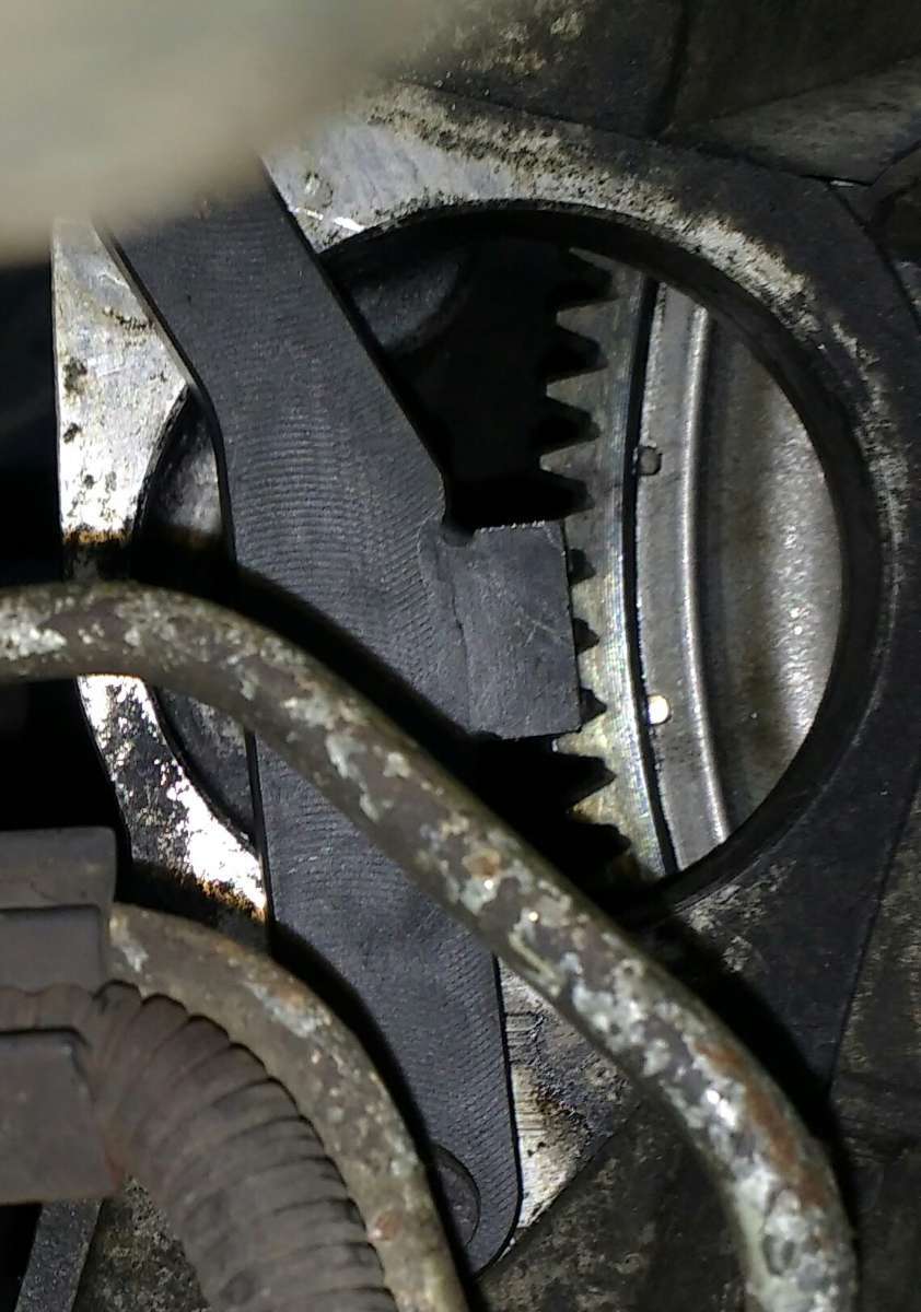

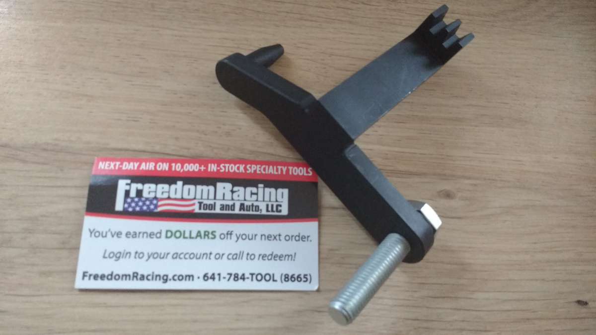

Cosmic73 Posted March 1, 2024 Author Share Posted March 1, 2024 I can finally torque up the crack pulley bolt. Bought this locking tool from the US, £200, but it was delivered within 3 days! Quote Link to comment Share on other sites More sharing options...
Cosmic73 Posted March 2, 2024 Author Share Posted March 2, 2024 Tool worked a treat! Pulley all tightened up. Quote Link to comment Share on other sites More sharing options...
davey_83 Posted March 2, 2024 Share Posted March 2, 2024 That's a trick little tool, had to do mine the ghetto way. 4th gear, handbrake and foot brake applied to hold the engine. Nice slow coolant fill and bleed to come also. Quote Link to comment Share on other sites More sharing options...
Cosmic73 Posted March 2, 2024 Author Share Posted March 2, 2024 6 hours ago, davey_83 said: That's a trick little tool, had to do mine the ghetto way. 4th gear, handbrake and foot brake applied to hold the engine. Nice slow coolant fill and bleed to come also. I tried it in gear but the gearbox was winding up too much and I was scared in case I snapped a tooth. The tool will be a good investment because I'll definitely do another 350. Yep, only the coolant and electric connections really, but I'm pi**ed off I didn't get solenoid gaskets in my kit, now I'm having to wait till the middle of March till they arrive before I can fire it up 😞 1 Quote Link to comment Share on other sites More sharing options...
davey_83 Posted March 2, 2024 Share Posted March 2, 2024 2 hours ago, Cosmic73 said: I tried it in gear but the gearbox was winding up too much and I was scared in case I snapped a tooth. The tool will be a good investment because I'll definitely do another 350. Yep, only the coolant and electric connections really, but I'm pi**ed off I didn't get solenoid gaskets in my kit, now I'm having to wait till the middle of March till they arrive before I can fire it up 😞 Nice pal. What's the condition like of your old gaskets? Mine were toast and beyond saving or running gasket maker temporarily. Best not to rush anything at this late stage, plenty of Z meets coming for 2024 Quote Link to comment Share on other sites More sharing options...
Cosmic73 Posted March 3, 2024 Author Share Posted March 3, 2024 9 hours ago, davey_83 said: Nice pal. What's the condition like of your old gaskets? Mine were toast and beyond saving or running gasket maker temporarily. Best not to rush anything at this late stage, plenty of Z meets coming for 2024 Gaskets weren't too bad actually, but the O rings between the timing housing and cover etc had turned hard as had the valve seals so I'm glad those were all replaced. Yep, no rush, nearly there..... 🙂 1 Quote Link to comment Share on other sites More sharing options...
