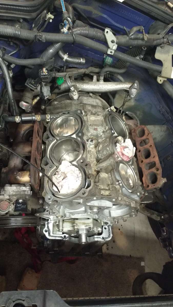

Cosmic73 Posted December 18, 2023 Author Share Posted December 18, 2023 One advantage of working for an engineering firm is that I can use the gauge lab facilities to measure my block and pistons with real hitec equipment. Considering all bores are stamped as grade 2 on the block, they've all stayed at grade 2 except cyl 6 which opened up to grade 3, however very little taper on them all. Pistons were also all grade 2 and remain grade 2 so happy days. 3 Quote Link to comment Share on other sites More sharing options...

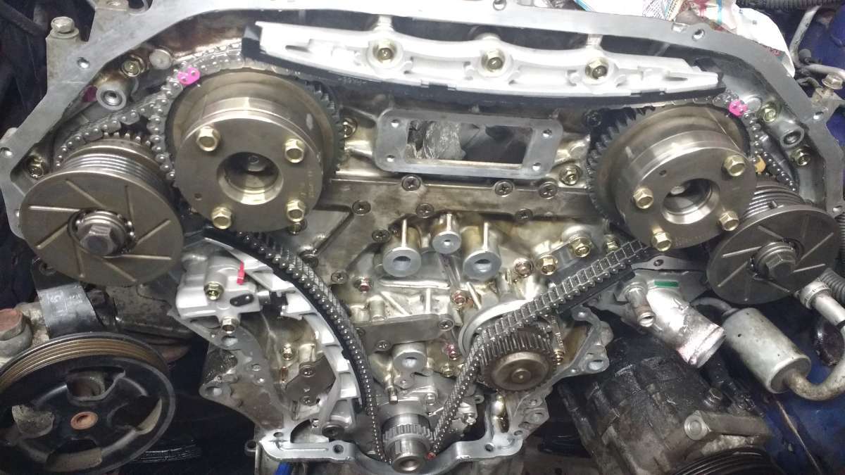

Cosmic73 Posted February 14, 2024 Author Share Posted February 14, 2024 (edited) This evening the secondary chains and sprockets have been fitted. Also, comparing my old primary chain against the new, there's very little wear, maybe a mm or 2, so not bad for 140k miles Edited February 14, 2024 by Cosmic73 1 Quote Link to comment Share on other sites More sharing options...
Cosmic73 Posted February 15, 2024 Author Share Posted February 15, 2024 This evening I fitted the primary chain and tensioners. Does this red clip need pulling out? Quote Link to comment Share on other sites More sharing options...
davey_83 Posted February 15, 2024 Share Posted February 15, 2024 Can't see that tab being left in Quote Link to comment Share on other sites More sharing options...
Cosmic73 Posted February 17, 2024 Author Share Posted February 17, 2024 On 15/02/2024 at 20:58, davey_83 said: Can't see that tab being left in You're right, I pulled it out and it released the tensioner. What confused me was it also came with a pin fitted into the small hole which I already pulled out, believing that was the release method. Obviously must have 2 release methods in this tensioner for some reason. 1 Quote Link to comment Share on other sites More sharing options...
