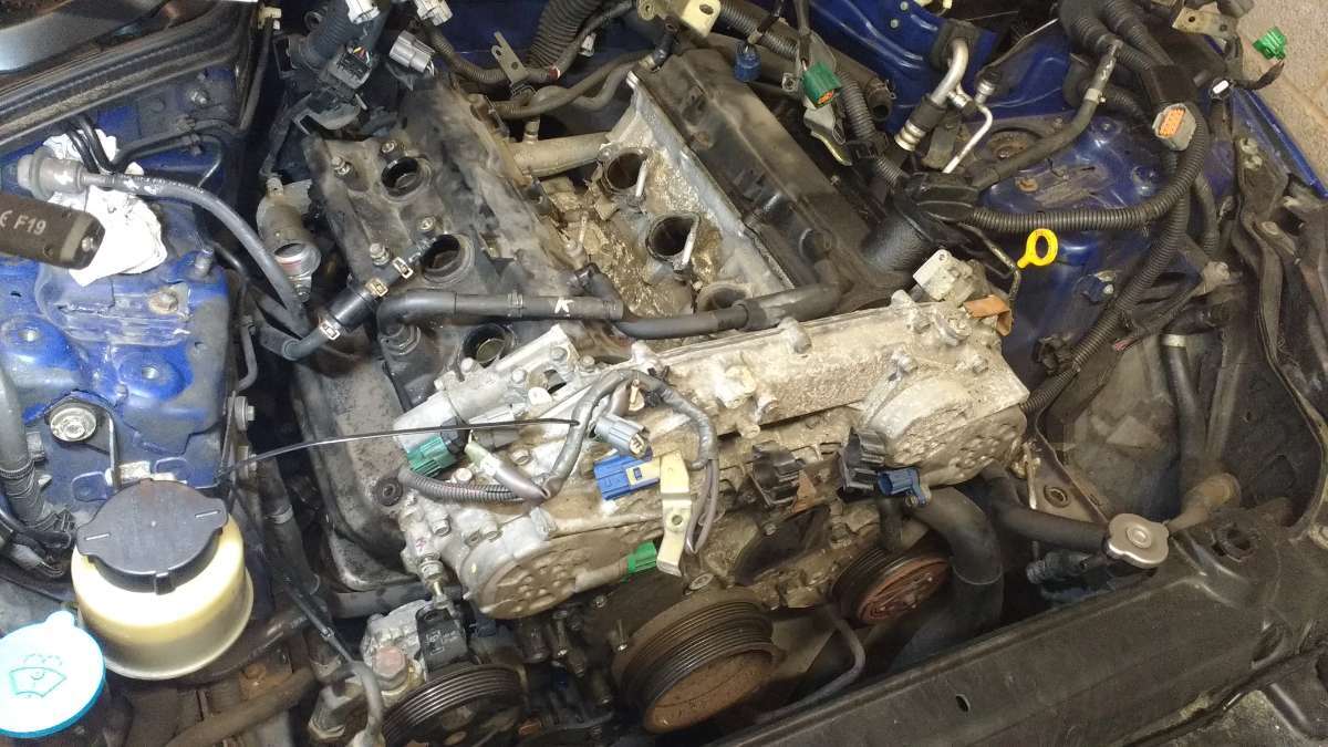

Cosmic73 Posted October 24, 2023 Author Share Posted October 24, 2023 Got the wiring loom fully disconnected and pulled out the way of the engine, alternater removed, PS bracket removed. Next job is to remove the rocker covers and the timing case. Quote Link to comment Share on other sites More sharing options...

Cosmic73 Posted October 25, 2023 Author Share Posted October 25, 2023 This evening I removed the rocker covers and timing chain covers, yah, Quote Link to comment Share on other sites More sharing options...

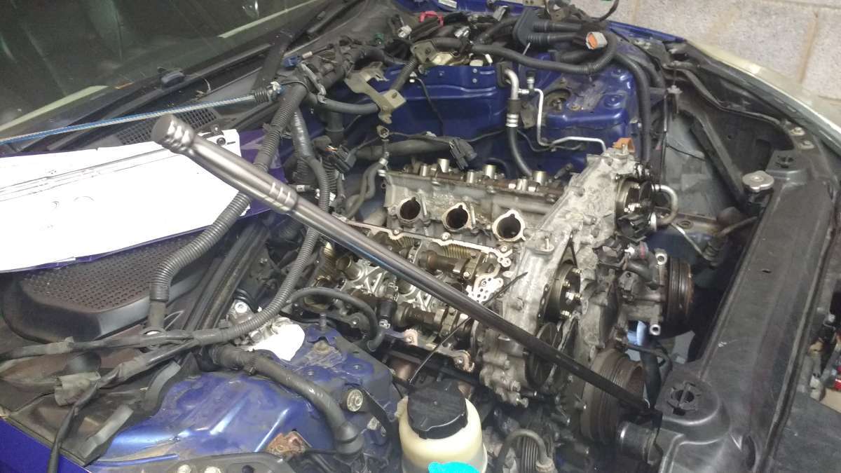

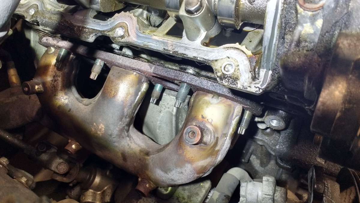

Cosmic73 Posted October 29, 2023 Author Share Posted October 29, 2023 This weekend I tried to undo the crack bolt and it won't budge. Even after liberal amounts of wd40 and bouncing on the end of my breaker bar (I'm 15stone) it ain't moving. I've ordered a new 1000mm long breaker which is more than twice the length of my current one so I hope that bad boy does the job. In the meantime I've removed the heat shields which was a pig of a job. 3 screws rounded their heads so I had to use moler grips. I've also undone all the exhaust manifold nuts ready for the heads to come off. Quote Link to comment Share on other sites More sharing options...
ZMANALEX Posted October 29, 2023 Share Posted October 29, 2023 The best way to get the crank pulley bolt off is to use a breaker bar and socket and jam against the front chassis leg and flick the ignition key, however, I guess that it is a bit late for that now as you have disconnected the electrics. So if it is really tight then you will have to lock the flywheel and the bolt should come loose using a good breaker bar and good socket. Otherwise, attack from the front using a powerful impact gun and impact socket. 1 Quote Link to comment Share on other sites More sharing options...
davey_83 Posted October 29, 2023 Share Posted October 29, 2023 The video above showed a good technique Quote Link to comment Share on other sites More sharing options...
Cosmic73 Posted October 30, 2023 Author Share Posted October 30, 2023 I've watched the video, it's just my breaker bar doesn't look as long as yours. Mine is only something like 40cm which is why i've ordered a 1m bar. 😈 1 Quote Link to comment Share on other sites More sharing options...
Cosmic73 Posted October 30, 2023 Author Share Posted October 30, 2023 10 hours ago, ZMANALEX said: The best way to get the crank pulley bolt off is to use a breaker bar and socket and jam against the front chassis leg and flick the ignition key, however, I guess that it is a bit late for that now as you have disconnected the electrics. So if it is really tight then you will have to lock the flywheel and the bolt should come loose using a good breaker bar and good socket. Otherwise, attack from the front using a powerful impact gun and impact socket. Yeah, it's too late to let the ignition do the work, but next time i'll remember to do that first I have removed the starter motor and jammed in a crow bar but the problem is; i just can't get enough leverage on my little 40cm bar. Yep, definitely agree about a good breaker bar. This 1m long beast I've ordered should shift it 😈 Quote Link to comment Share on other sites More sharing options...

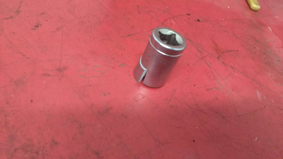

Cosmic73 Posted November 1, 2023 Author Share Posted November 1, 2023 This flywheel bolt is being a right pain. I managed to lock the flywheel using a nut and bolt; My 1m long bad boy breaker bar definitely provides enough leverage But the socket simply split open. I assume I need a much stronger impact type socket? 1 Quote Link to comment Share on other sites More sharing options...

Cosmic73 Posted November 2, 2023 Author Share Posted November 2, 2023 I bought an impact socket from Halfords and the crank bolt cracked straight off, happy days. I'm now struggling to get the front timing cover off, because the 2x steel dowels are too tight and rusted. I'll get some heat into them tomorrow and see if that loosens then up 🙂 Quote Link to comment Share on other sites More sharing options...

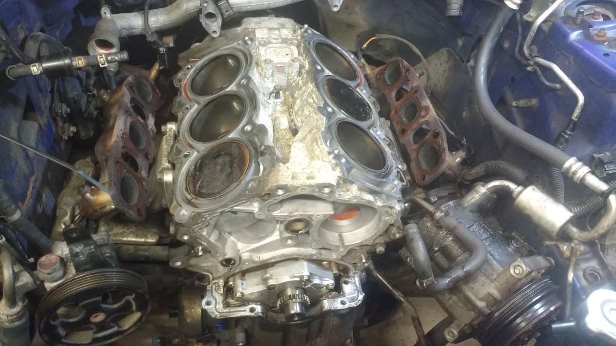

Cosmic73 Posted November 11, 2023 Author Share Posted November 11, 2023 My heads are now off. I'll remove the valves, get them soda blasted and pressure test and skim the heads. 1 Quote Link to comment Share on other sites More sharing options...

Cosmic73 Posted November 14, 2023 Author Share Posted November 14, 2023 On 12/11/2023 at 18:07, Cosmic73 said: I've got a difficult choice. Do I now, 1. Lift the block out? or 2. Remove the subframe and drop the block? Since the subframe is quite rusty and could do with a refurb, I thought I'd remove it, get it blasted and powder coated. I managed to remove the brace today. Thank the lord for my breaker bar 🙏🙏 But not sure how to remove the subframe. Anyone done this before? This evening I started removing the front subframe to realise the block can't be lowered because the steering rack is in the way, which means I'll have to lift the block up and out instead. Not the end of the world, but just pain to set up the lift 😞 1 Quote Link to comment Share on other sites More sharing options...
