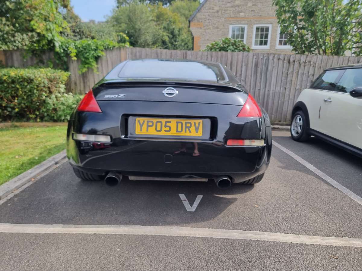

Loadmaster Posted September 30, 2023 Share Posted September 30, 2023 (edited) On 09/09/2023 at 13:54, Matt8v said: Found a place that does short legal number plates. The website says they are legal, we'll see hey! If it's legal, which it looks to be, their name and postcode will be printed under the registration. Edited September 30, 2023 by Loadmaster Quote Link to comment Share on other sites More sharing options...

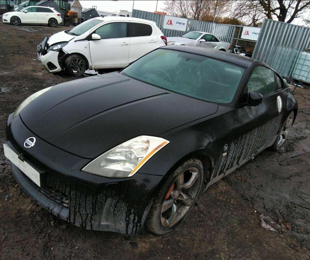

Loadmaster Posted September 30, 2023 Share Posted September 30, 2023 On 24/07/2023 at 10:20, Matt8v said: Hi guys, Thought I would document the life of owning my GT4. Just bought it a week ago from a salvage auction site, no viewings, just online bidding. Luckily I won and had it transported home. As you can imagine, there is a list as long as my arm of bits to tidy and sort. I've been very lucky that the engine sounds as it should do. Not driven it yet as a front alloy has a crack in it. There's a replacement coming this week. A few photos of how I saw it to bid on! Hey Matt, what a great thread. Keep up the good work! 1 Quote Link to comment Share on other sites More sharing options...

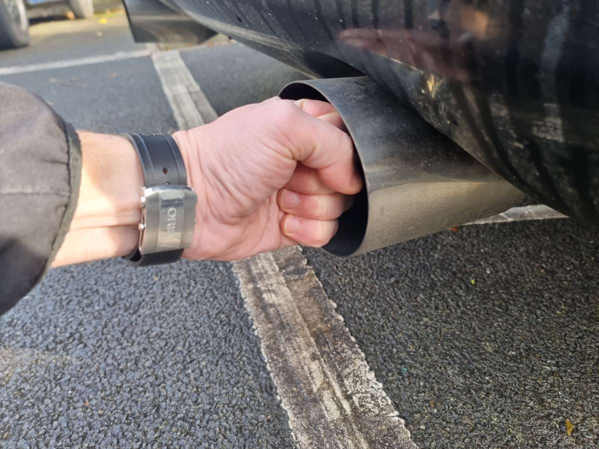

Matt8v Posted November 20, 2023 Author Share Posted November 20, 2023 Hey guys I forgot to update earlier but my 350 is home now. All happy that I have a new mot and a few jobs completed. I now have a beautiful Fujitsubo stainless exhaust. Quiet at idle and round town, then nicely howls when giving it beans. No droning at all, a lovely bit of kit. The only way that I can describe the tips, is ridiculous! I love them. They are huge, I can lose my fist inside them! 😄 Other works- 6x new sparkplugs 6x new coilpacks 1x new cam position sensor 6x injectors removed, cleaned & refitted 2x front lower suspension bushes Driving is great, picks up really quickly and hoofs along quick for me. This is the fastest car I've had, so no real supercar speeds to refer to. 4 Quote Link to comment Share on other sites More sharing options...
