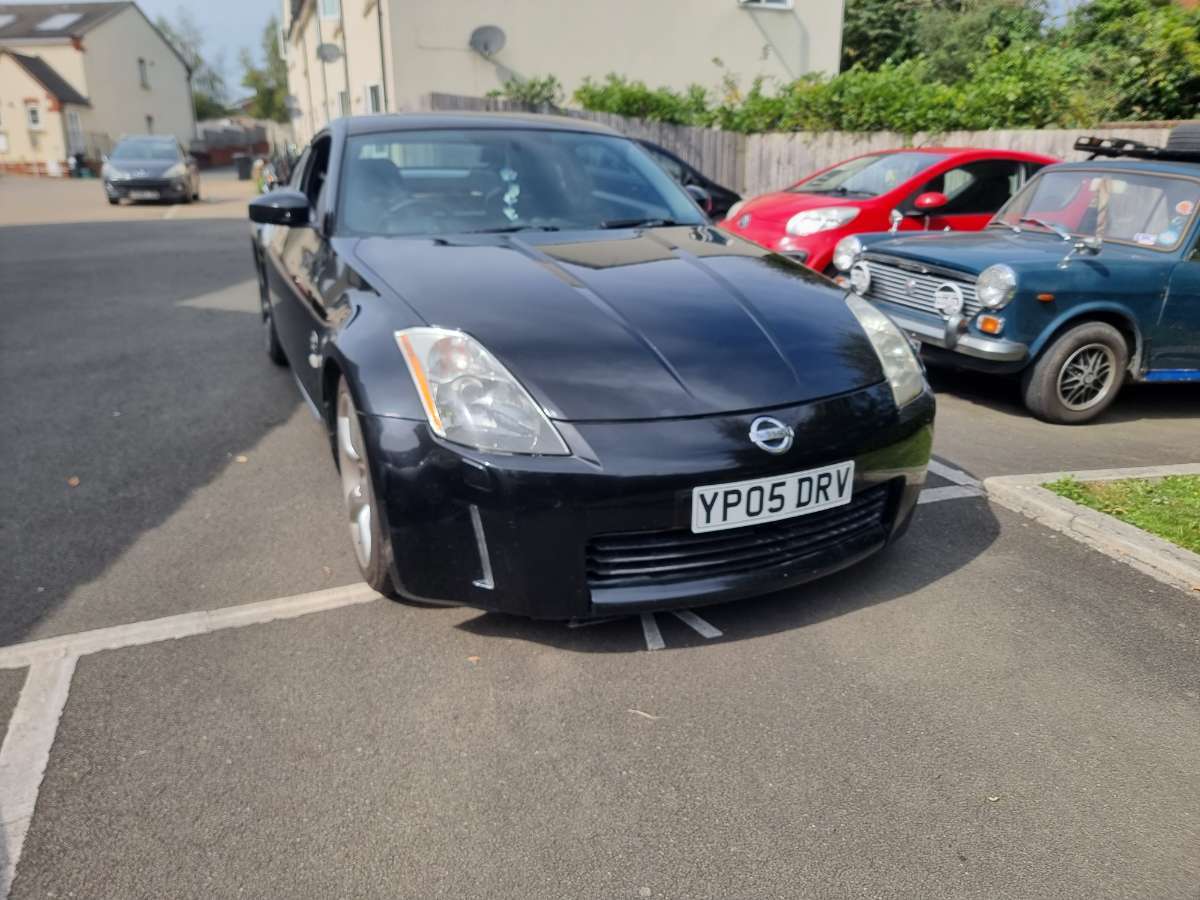

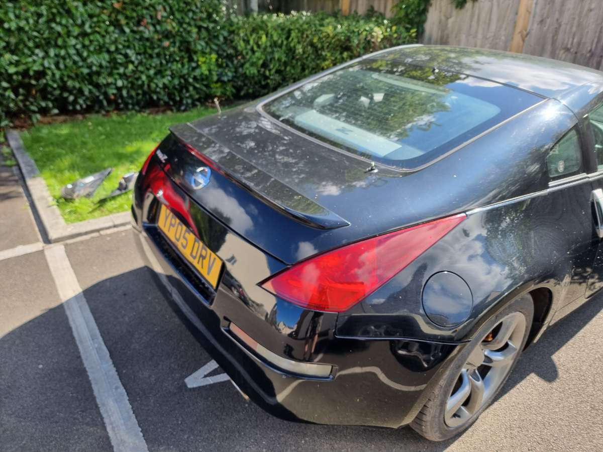

Matt8v Posted August 6, 2023 Author Share Posted August 6, 2023 Just a quick update today. More modifying back to standard! Someone might want my old lights for a motorsport or molded look. I bought these original lights from Olly on here, thanks so much buddy, they are awesome condition. Quote Link to comment Share on other sites More sharing options...
Olly350z Posted August 6, 2023 Share Posted August 6, 2023 Glad you're happy with them dude, not bad for in storage! Always disliked those aftermarket rear lights, OEM is much nicer. Keep the updates coming! 1 Quote Link to comment Share on other sites More sharing options...
Matt8v Posted August 6, 2023 Author Share Posted August 6, 2023 40 minutes ago, Olly350z said: Glad you're happy with them dude, not bad for in storage! Always disliked those aftermarket rear lights, OEM is much nicer. Keep the updates coming! Hey Olly, thanks again mate. I love the way the car is looking now. Lots of little jobs to do. Changed the front wiper arms, as someone decided to snap both for the previous owner! Has anyone got 6x little plastic covers that go over the rear lights fixing points please? The aftermarket lights had different shape covers. Quote Link to comment Share on other sites More sharing options...
Matt8v Posted August 6, 2023 Author Share Posted August 6, 2023 4 hours ago, Matt8v said: Just a quick update today. More modifying back to standard! Someone might want my old lights for a motorsport or molded look. I bought these original lights from Olly on here, thanks so much buddy, they are awesome condition. Modded look, not molded! Thanks autocorrect 😑 1 Quote Link to comment Share on other sites More sharing options...

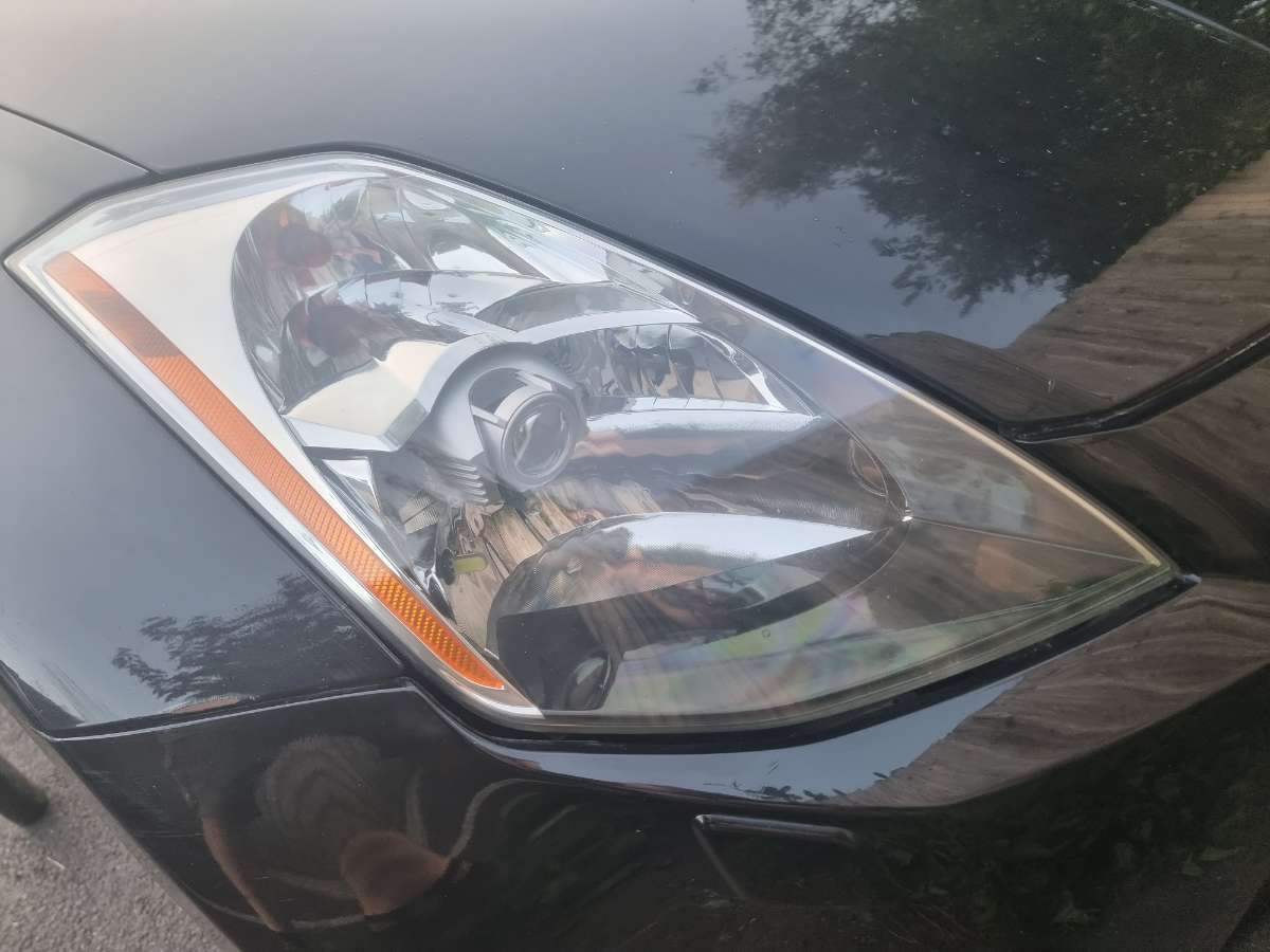

Matt8v Posted August 6, 2023 Author Share Posted August 6, 2023 Think I've saved a fortune on not having to buy new headlights! Machine polished my existing ones tonight with a drill attachment and some G3 cutting compound. I'm loving this car and what I can achieve with it. I'm certainly no mechanic but willing to give it a try. 5 Quote Link to comment Share on other sites More sharing options...

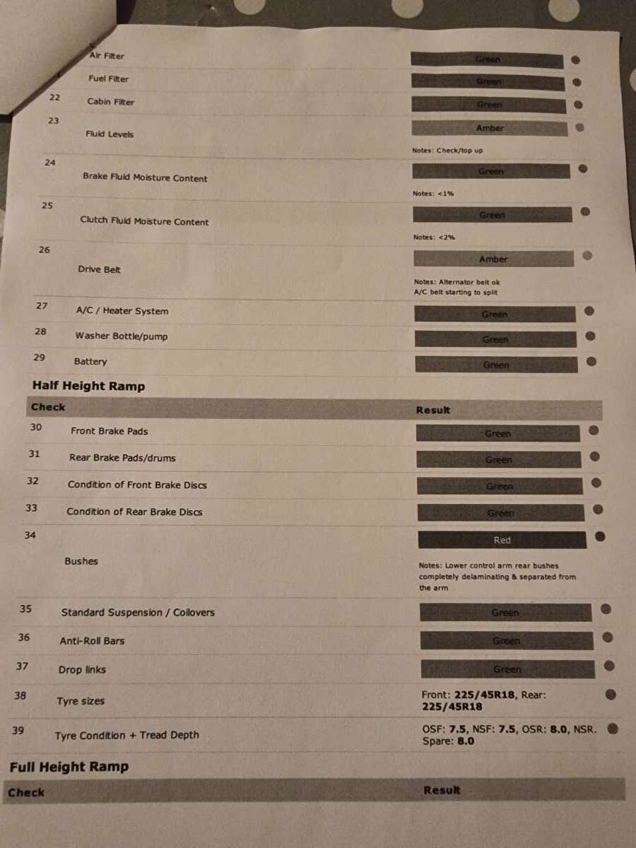

Matt8v Posted August 8, 2023 Author Share Posted August 8, 2023 I'm so impressed with Torque GT in Devon. They have carried out a health check on this car today. An hour and all of these points covered. Found the oil low, topped it up. Found an airbag light fault, reset it and no extra charges for doing both. I need new bushes as these are shot and need a new exhaust from the cats back. A nice stainless one I think! 1 Quote Link to comment Share on other sites More sharing options...
davey_83 Posted August 9, 2023 Share Posted August 9, 2023 Lovely comprehensive check over, I like that. With these cars oil level checks a must. 1 Quote Link to comment Share on other sites More sharing options...

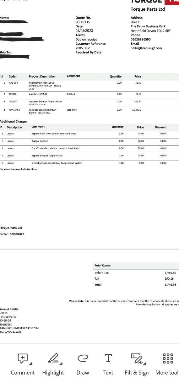

Matt8v Posted August 10, 2023 Author Share Posted August 10, 2023 (edited) So I've had a quote from Torque GT for the work to be done from the health check carried out this week. They offer the Fujitsubo exhaust on offer at the moment, made for high performance Jap cars. I've heard a couple of cars with it fitted to whilst I was there and it's a smart rumble without being a boy racers dream! The website says no cabin drone while driving, suits me fine. Once these jobs are carried out, I should be fine for the mot, fingers crossed. Edited August 10, 2023 by Matt8v Quote Link to comment Share on other sites More sharing options...

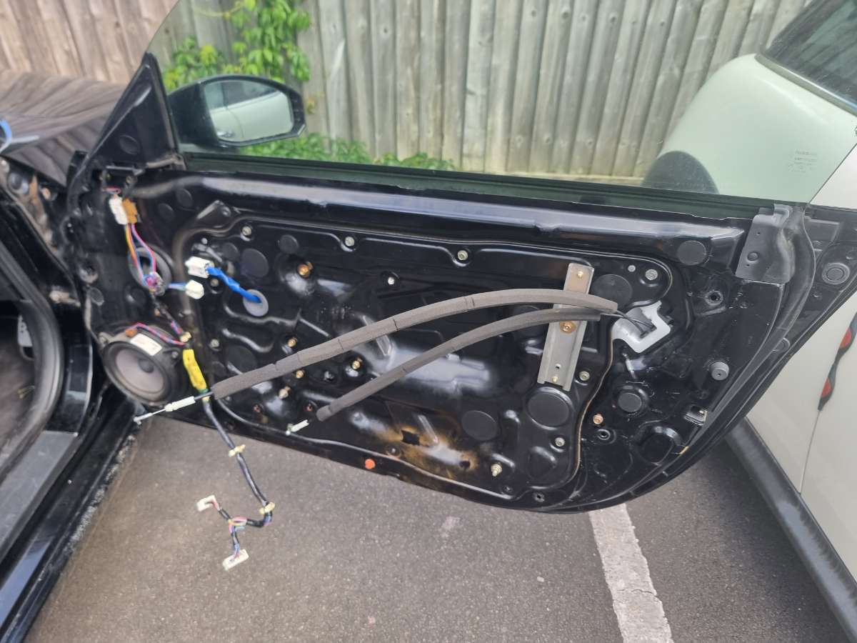

Matt8v Posted August 19, 2023 Author Share Posted August 19, 2023 Had a bit of time to look at the drivers door window motor. It's not worked since I bought the car. I used the university of YouTube to work out how to take the doorcard and inner metal plate off. All the motor needed was a bit of WD40 as the contacts were dry. Ran it up and down a few times, so refitted everything. Tried it once everything was back together and it stopped at the open position. Bugger! I looked online and an American forum said to hit the door card whilst pressing the button. It only bloody worked! Fully working windows now! 4 Quote Link to comment Share on other sites More sharing options...
