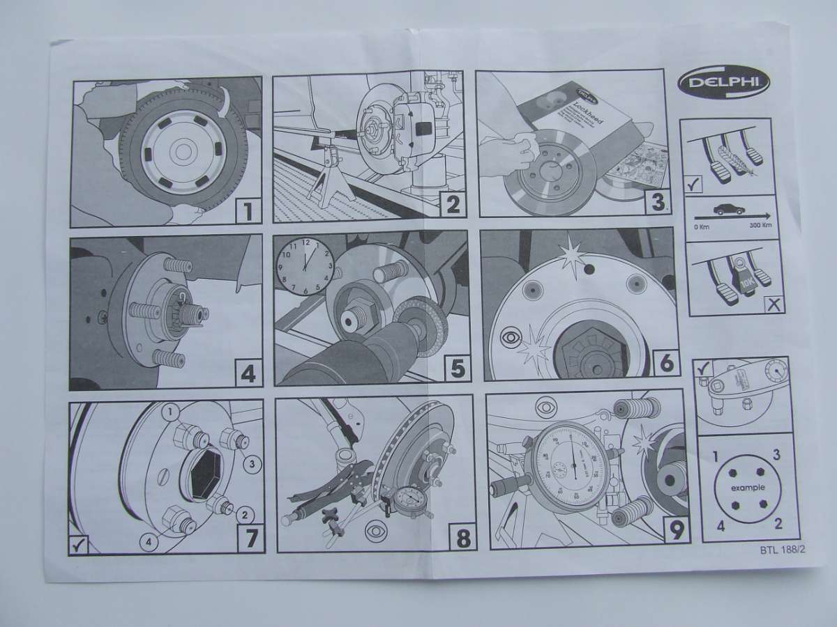

ZMANALEX Posted July 11, 2023 Share Posted July 11, 2023 It will be DTV caused by not following the correct fitting procedures. 2 Quote Link to comment Share on other sites More sharing options...

SWoMP Posted July 15, 2023 Share Posted July 15, 2023 Disc Thickness Variation Quote Link to comment Share on other sites More sharing options...
GranTurismoEra Posted July 17, 2023 Share Posted July 17, 2023 (edited) All it takes a a mm or 2 variation on the hub or disc apparently. Meaning its not running true or straight Edited July 17, 2023 by GranTurismoEra Quote Link to comment Share on other sites More sharing options...
Impressed Posted July 17, 2023 Share Posted July 17, 2023 (edited) I would think that would be allot less to cause issue. Possibly 0.1mm or less. At 2mm runout or DVT it would probably be undrivable. Edited July 17, 2023 by Impressed Quote Link to comment Share on other sites More sharing options...
