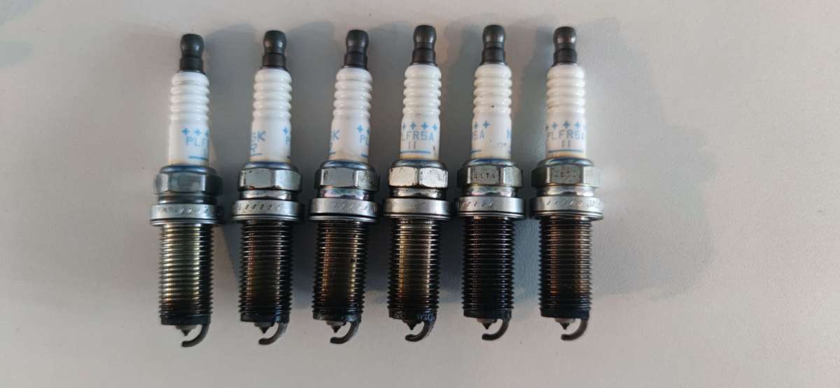

Picture of old plugs in attachment. I think the one that was in cylinder 6 with oil in well is the first one (from the left), but I'm not sure. They all look about the same. Worn, but otherwise fine and shouldn't cause the misfire. I blame that on oil getting between plug and coil pack.

Are you absolutely sure you've not mixed up the firing order on the last two spark plugs by connecting the coilpacks the wrong way round? It's super easy to do and many, myself included have made the same mistake ?
I'm absolutely sure I got them in the right order. The wire that comes from the middle of the harness on this side goes to the cylinder 6 and the one from the end of the harness closest to the firewall goes to cylinder 4. As described here (I hope link from another forum aren't a bannable offence)
I also put back old plugs and the problem is still there, so that rules out any kind of fault with new plugs too.
