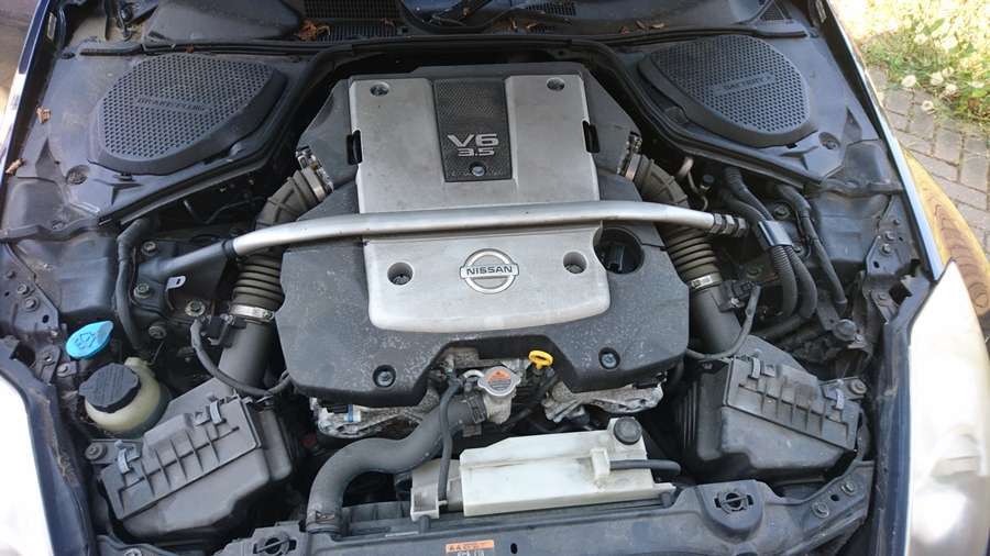

Jack94 Posted June 25, 2023 Share Posted June 25, 2023 38 minutes ago, Girl Racer said: Thanks for the link Ben Jack - It's a 57 reg, but I'm sure the AA chap said the slave cylinder was inside the gearbox hence it would need to be dropped...... Have you got one airbox or two? DE/Revup has one, HR has two... Quote Link to comment Share on other sites More sharing options...
pintopete58 Posted June 25, 2023 Share Posted June 25, 2023 That's a good call . If it's outside I do have a new slave and flexible hose for a De £80 Quote Link to comment Share on other sites More sharing options...
Girl Racer Posted June 25, 2023 Author Share Posted June 25, 2023 Two..... 1 Quote Link to comment Share on other sites More sharing options...
pintopete58 Posted June 25, 2023 Share Posted June 25, 2023 HR all day long Good luck with it . It'll all come Good 1 Quote Link to comment Share on other sites More sharing options...
