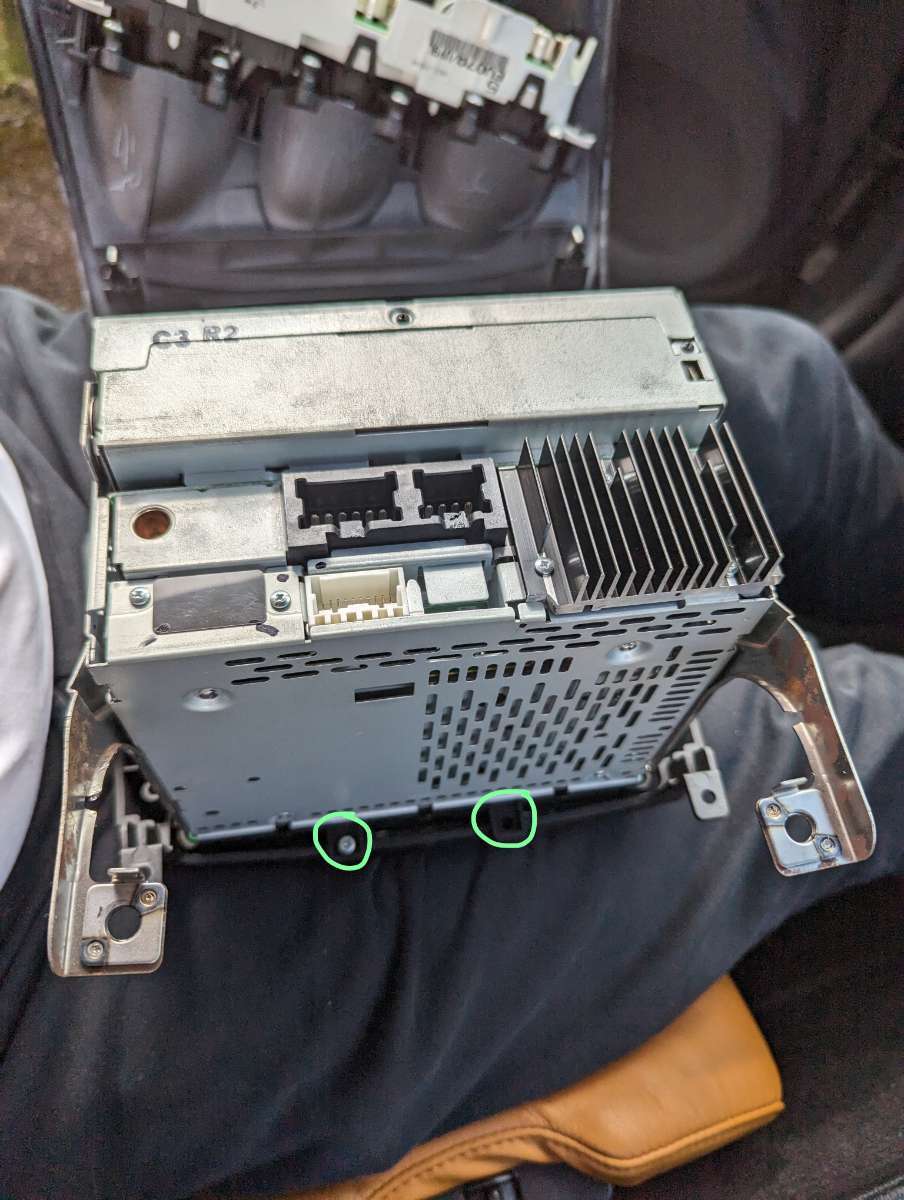

I found there were additional screws to remove to get the head unit free from the console trim (image 1) and also found it easier to remove the two bits of metal on either side of the head unit that attach to the centre console trim; the guide has you take the 4 screws on each piece out, but I also removed the single screw on each to free it up altogether (image 2).  I’m not sure if you can fully remove the dash with these still in place, but I couldn’t get it past the bit of plastic that remains spanning the width of the centre console and the AC control unit (image 3).

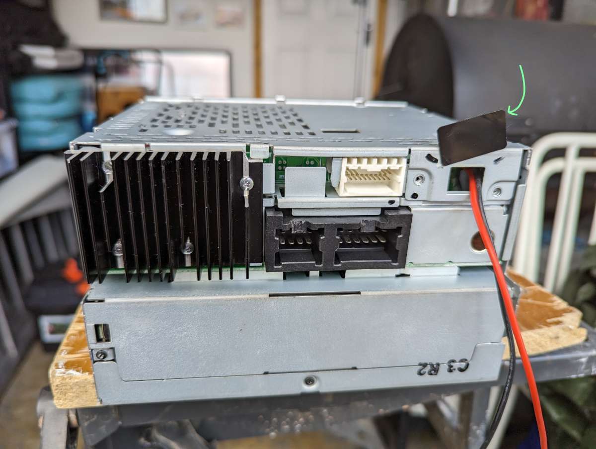

Final thing that was different from the guide was the hole to pass the red and black cables through on the back of the head unit, but it is only in a slightly different position and shape.  There was a small plastic sticker over a rectangle that I removed to pass the cables the sticker is in the photo below for reference, at an angle above the revealed hole.
