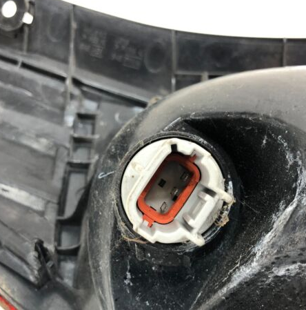

cityhunter88 Posted March 27, 2023 Share Posted March 27, 2023 Hi, Has anyone had this issue. I have a 2005 GT4, bought i set of facelift LED rear tail lights and its not a direct fit, the connectors won't fit into the LED tail lights. LED tail light connector, My standard tail light connector, Whats my options other than messing around with the wiring. Thanks. Quote Link to comment Share on other sites More sharing options...

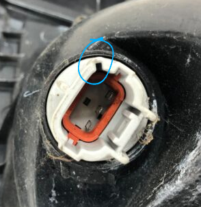

davey_83 Posted March 27, 2023 Share Posted March 27, 2023 I've had this, the plug tab will need a trim - see the below https://www.350z-uk.com/topic/111683-db-nissan-350z-gt-05/?do=findComment&comment=1674031 Quote Link to comment Share on other sites More sharing options...
cityhunter88 Posted March 27, 2023 Author Share Posted March 27, 2023 Hi Dave, Thanks for that, will give that i try this weekend, Quote Link to comment Share on other sites More sharing options...
P15UL T Posted March 27, 2023 Share Posted March 27, 2023 Yes you need to either trim the connectors above or what I did this time was manage to get the correct connector from a breaker car and remove the connector from the car and repin the correct version on. Actually quicker to to do than trimming the 3 bits of plastic off each side. Paul Quote Link to comment Share on other sites More sharing options...
davey_83 Posted March 27, 2023 Share Posted March 27, 2023 5 hours ago, P15UL T said: Yes you need to either trim the connectors above or what I did this time was manage to get the correct connector from a breaker car and remove the connector from the car and repin the correct version on. Actually quicker to to do than trimming the 3 bits of plastic off each side. Paul Only x1 tab on each plug needs addressing Quote Link to comment Share on other sites More sharing options...
