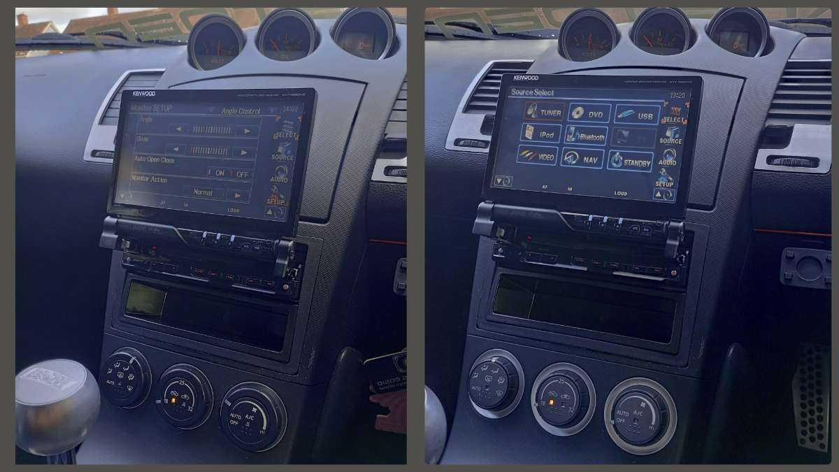

davey_83 Posted November 1, 2024 Share Posted November 1, 2024 Not sure about the coilover situation, might be a waiting game until you come across a rear set of dampers. I copied you with the JDM heater controls for my 05' and love them, matches the ally gear knob and vent surrounds also. 1 Quote Link to comment Share on other sites More sharing options...
Dipper Posted November 4, 2024 Author Share Posted November 4, 2024 On 01/11/2024 at 12:20, davey_83 said: Not sure about the coilover situation, might be a waiting game until you come across a rear set of dampers. I copied you with the JDM heater controls for my 05' and love them, matches the ally gear knob and vent surrounds also. Looking sweet my man! 1 Quote Link to comment Share on other sites More sharing options...

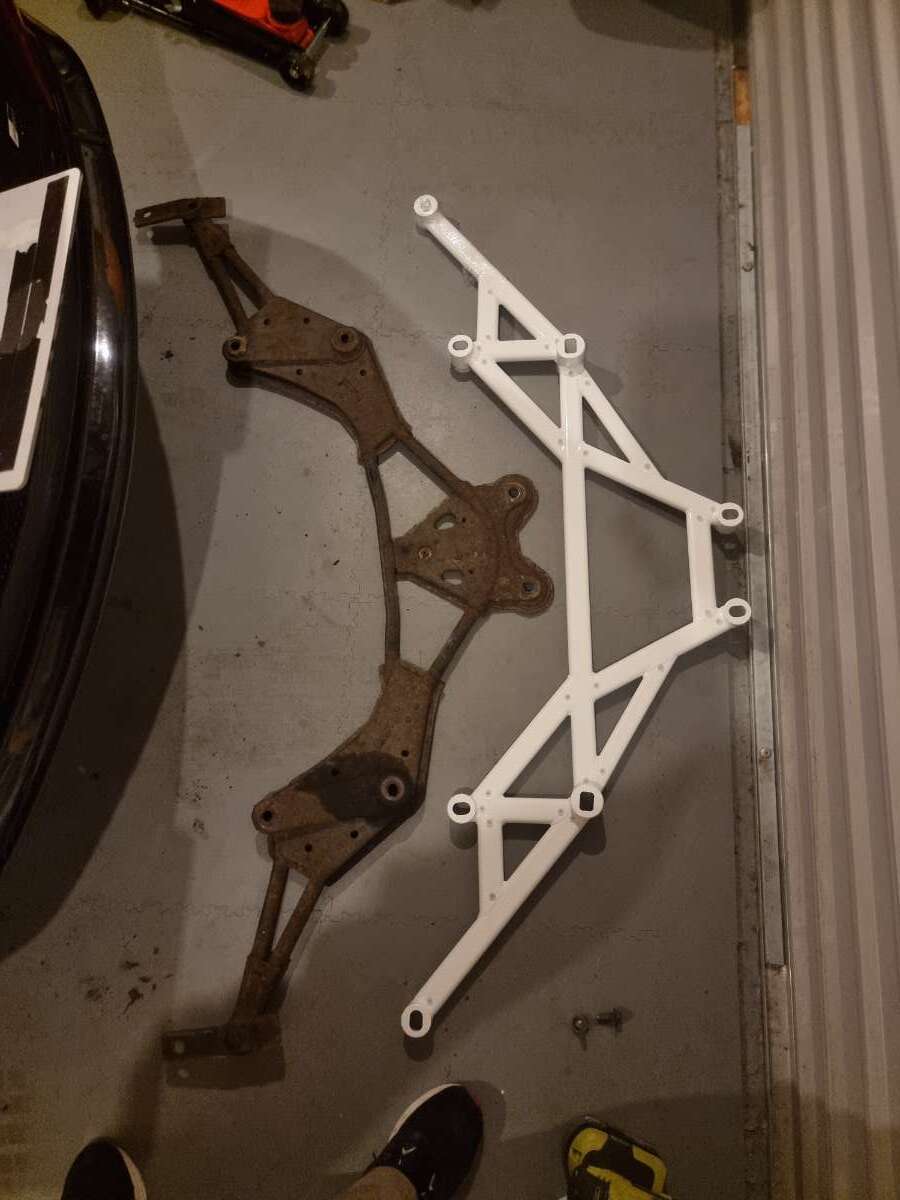

Dipper Posted November 22, 2024 Author Share Posted November 22, 2024 I realise I'm jumping around a bit. A few half finished jobs on the go But currently the car is on axle stands with a few plans for winter fixes. So i picked up the ultraracing front brace and I'm halfway through removing the old rusty one. It was going ok untill I rounded a bolt. (Despite being really carefull, using 6 point sockets and a gently gently approach) Anyway, I had some extractor sockets from when I was doing the kidney brackets.(didn't end up using them there) and with out much expectations I hammered one on. Have to say I am soooo impressed. Hanging off it with the breaker bar. It held fast and removed the bolt. 100% my new favourite tool. 2 Quote Link to comment Share on other sites More sharing options...
Zalas Posted November 22, 2024 Share Posted November 22, 2024 (edited) Nice work! What brand were they? Irwin? Normally I end up snapping the bolt shaft before rounding the head Chinesium much? Mine's been on axle stands for the last three weeks waiting for the droplinks to be adjusted under load and the outer tierods tightened ... give it another 2 months and I might get around to it X5 arms and e92 subframes are first jobs. Sad. Edited November 22, 2024 by Zalas 1 Quote Link to comment Share on other sites More sharing options...

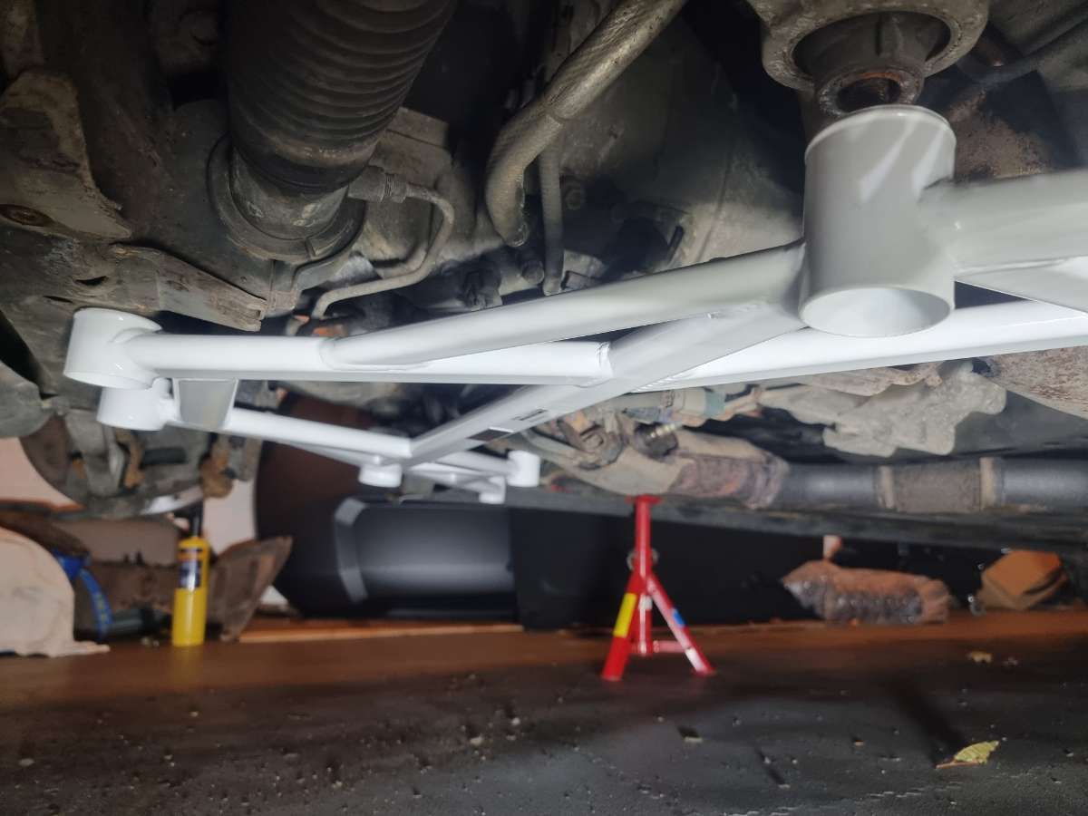

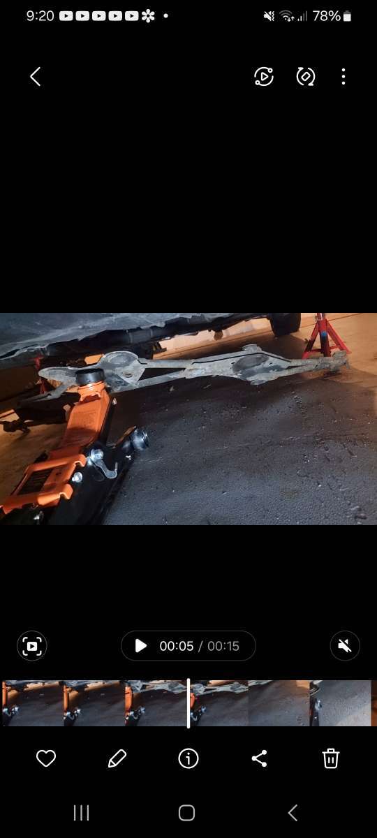

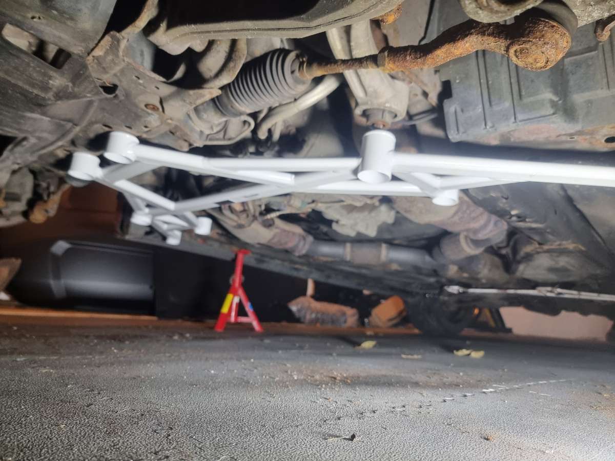

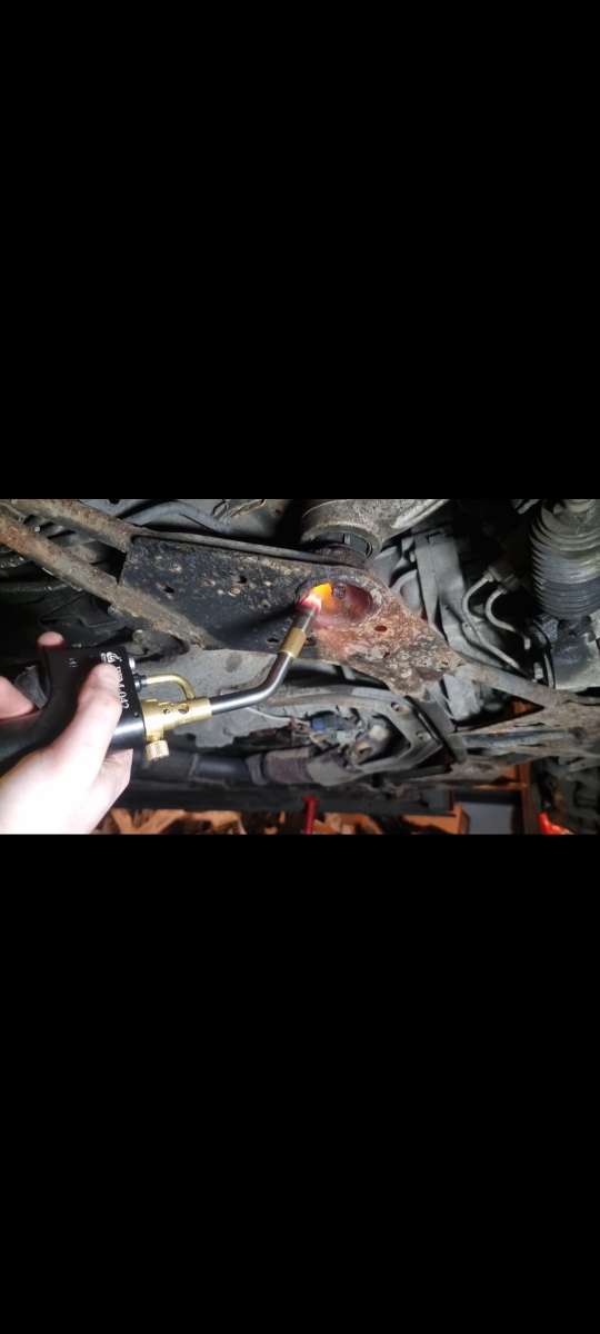

Dipper Posted December 4, 2024 Author Share Posted December 4, 2024 A few steps closer today. I managed to get the big m14 nuts off the front sub frame. Without breaking the captive studs. (They were really on there) required the blow torch and the big breaker bar to get them moving. The rest of the m10 bolts came off without too much bother. So front subframe is now off. The ultra racing one ready to go on. I bought new hardware too. For reference. You need: -two m14 nuts. 1.5 fine thread. -six m10 bolts with 1.25 fine thread. (25mm long) I've mocked up the new brace. But I'm going to brush up and go over some areas with rust converter and a touch of paint before full reassembly. Also I've ordered new inner and outer tie rods before anyone mentions the state they are in!(shocking really, how did they pass mot?) 1 Quote Link to comment Share on other sites More sharing options...
Zalas Posted December 4, 2024 Share Posted December 4, 2024 Looking good! Massive difference. How were the bushes in the banana arms? It's a never ending saga isn't it - I started with that brace ended up replacing the bearings, outer/inner rods, multiple patches of rusted component and still not done Quote Link to comment Share on other sites More sharing options...
Dipper Posted December 4, 2024 Author Share Posted December 4, 2024 (edited) Oh 100%. Most all moving parts down there need a refresh. Banana arms bushing seem ok. I think at least one has been replaced, before my ownership. The lower control arm bushing on one side looks a bit worse for wear mind you. It's probably going to be added to the list. (The list that never stops growing) Edited December 4, 2024 by Dipper Quote Link to comment Share on other sites More sharing options...

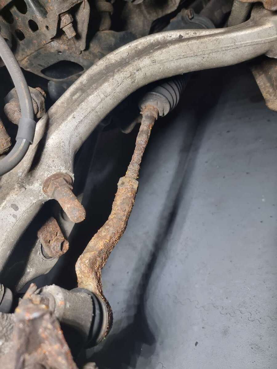

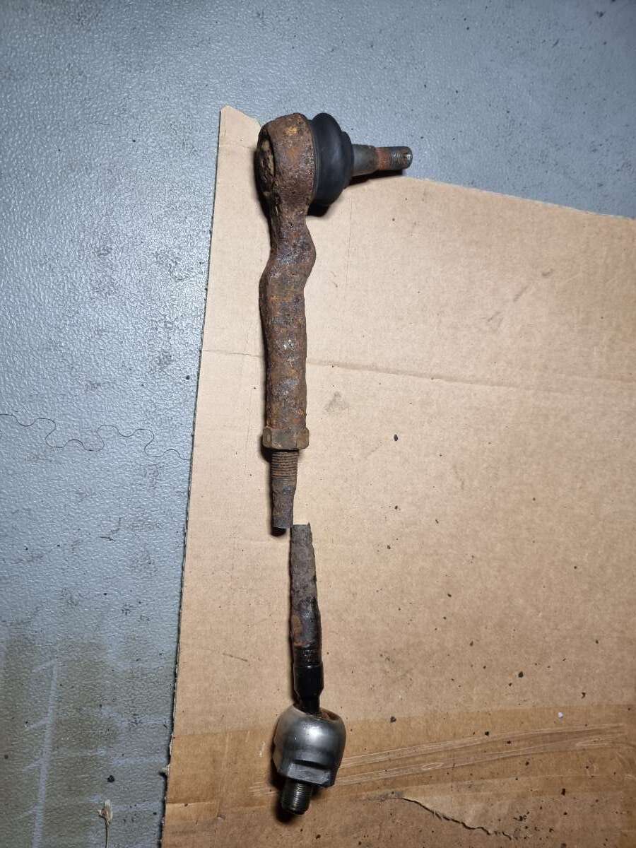

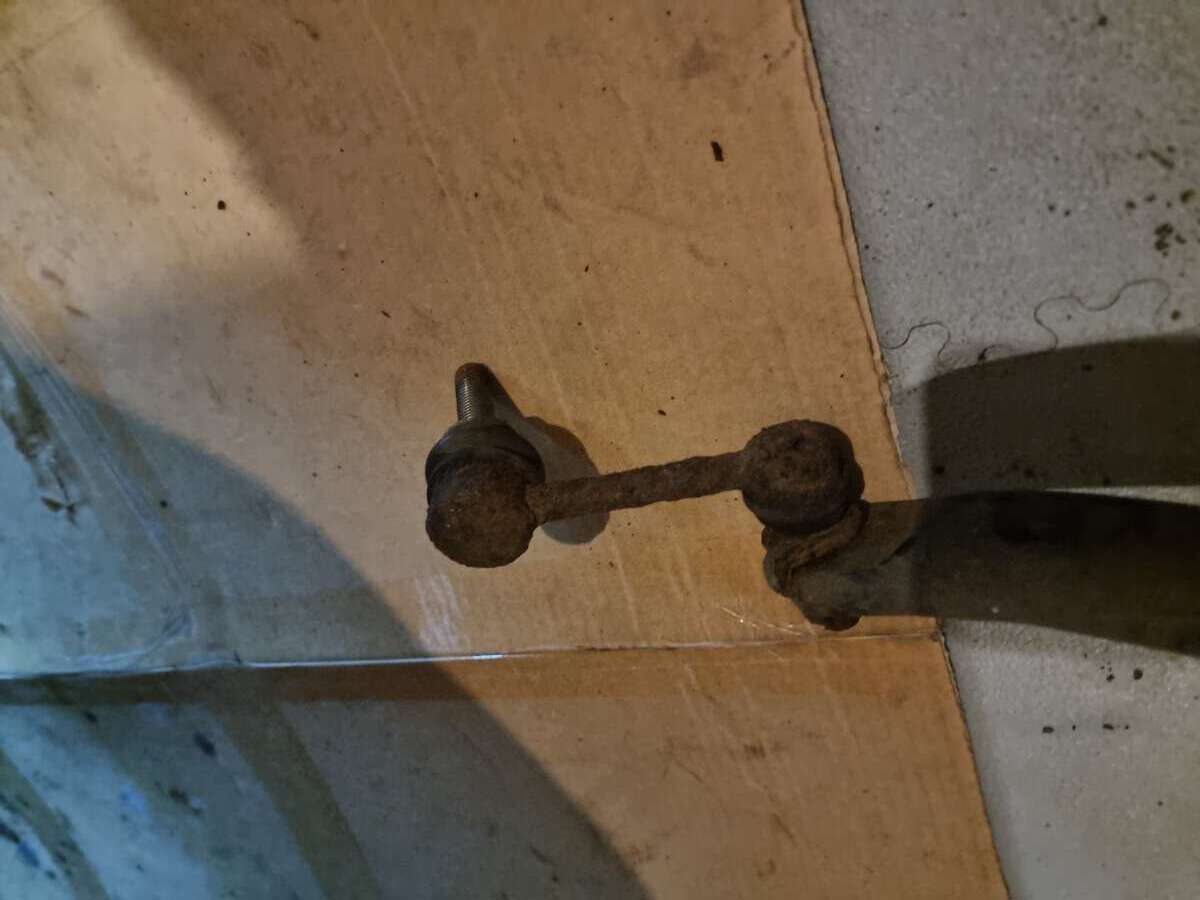

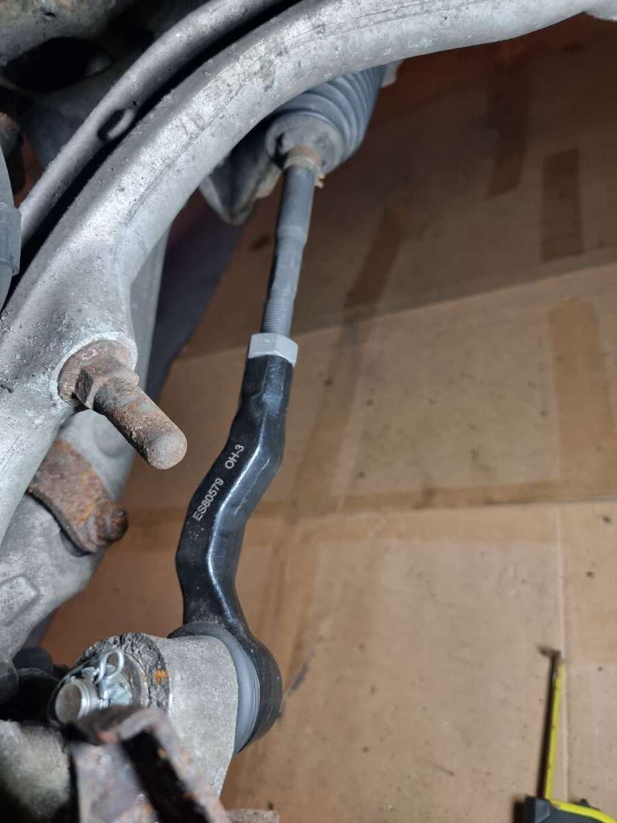

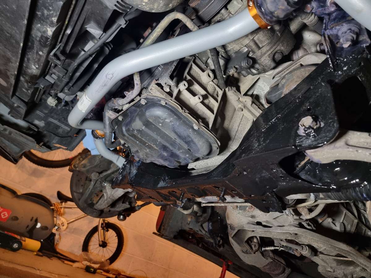

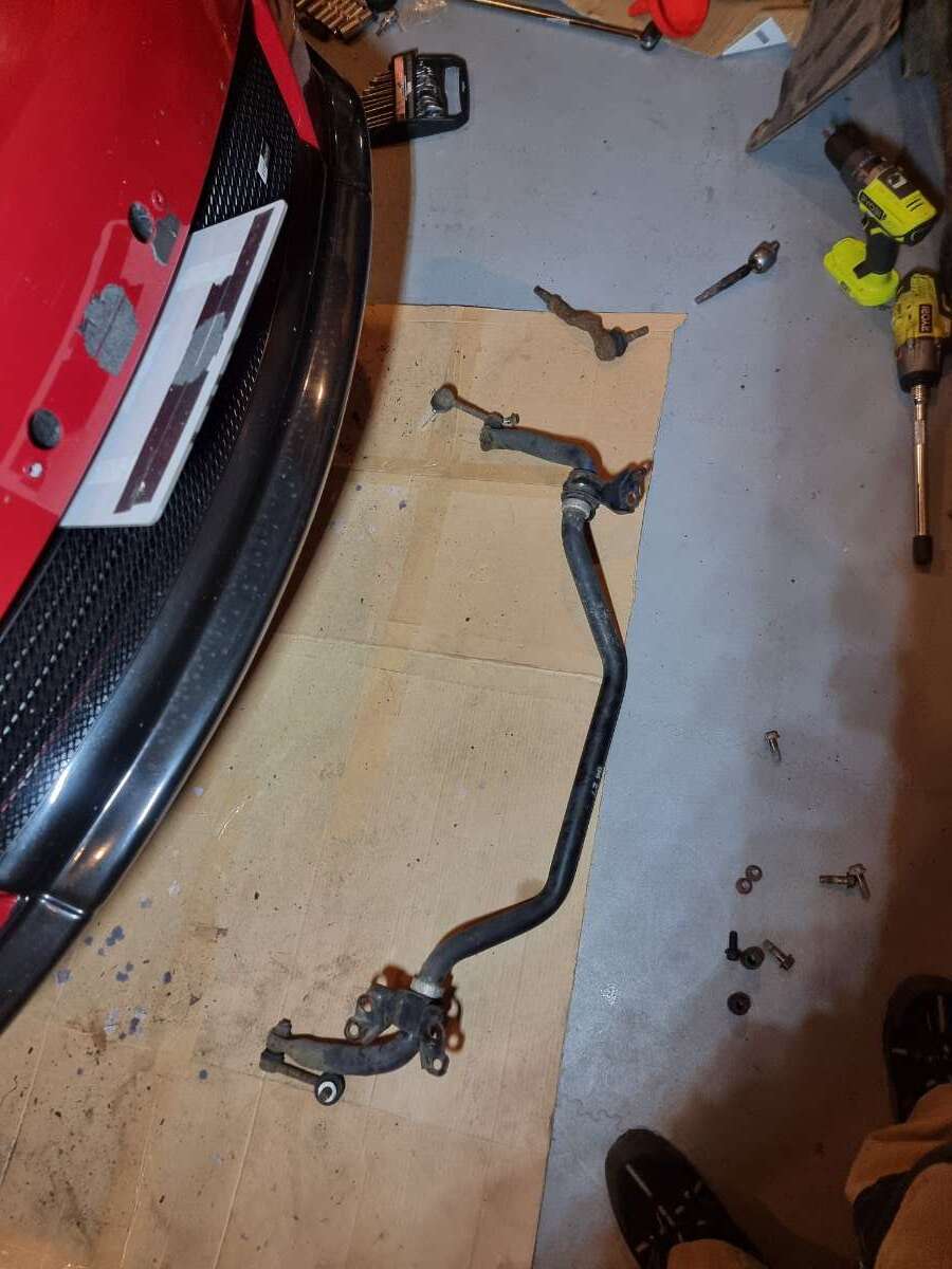

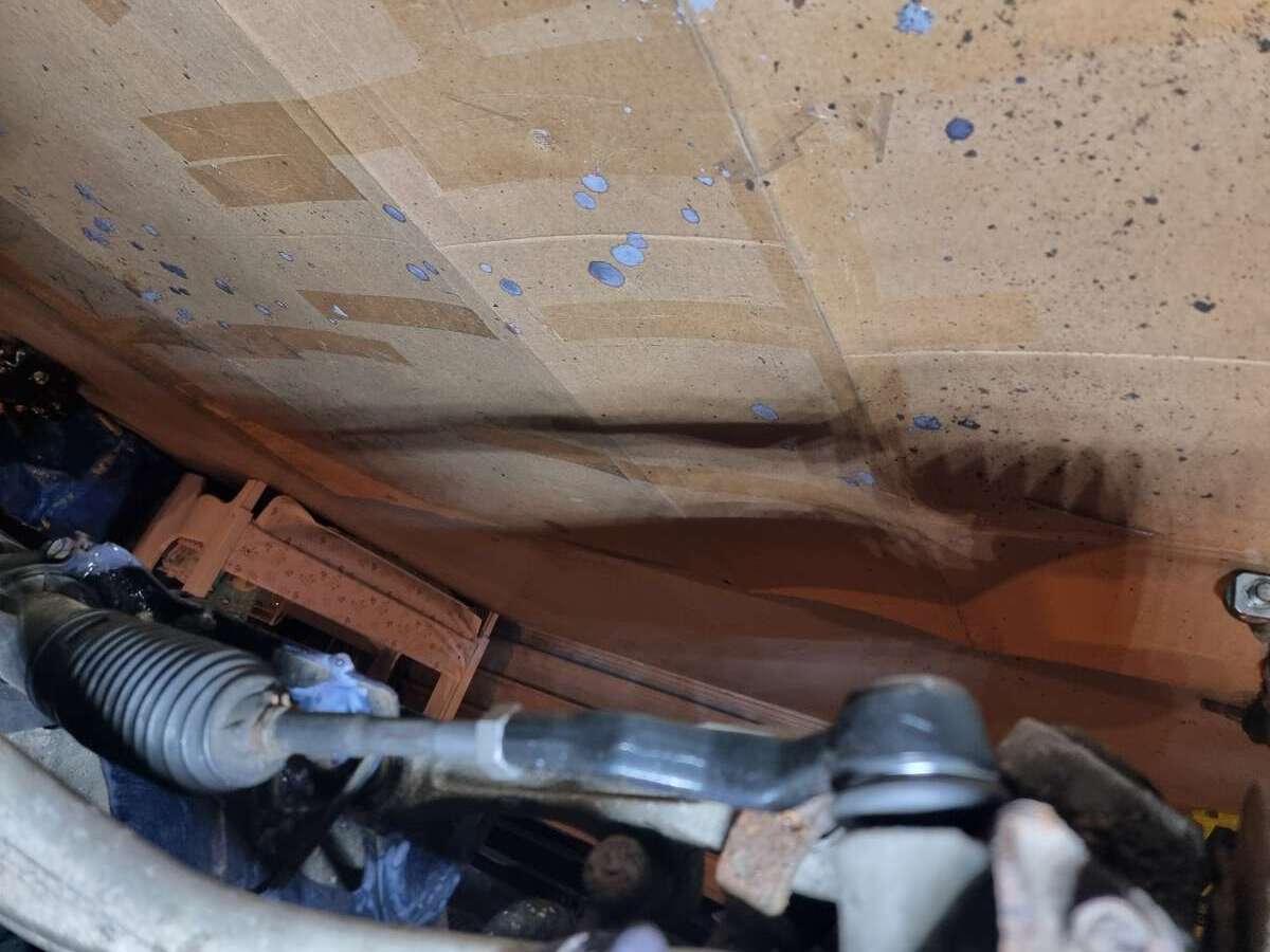

Dipper Posted December 29, 2024 Author Share Posted December 29, 2024 (edited) So In my standard fashion I'm still bouncing around a loada jobs. Finally got round to cleaning up some of the front subframe before final fit. Rust converter on. And while waiting for it to work and later painting it. I gave the inner and outer tie rods a change. The old ones were looking pretty rusty and not inspiring confidence. I had to saw the old ones in half to get the rubber boots off too. As they were so seized together as one. Once all the parts are on it get a propper alignment too. Just gauged length of them off the old ones for now. Edited December 29, 2024 by Dipper 1 Quote Link to comment Share on other sites More sharing options...
MONKEYSOCKS Posted December 30, 2024 Share Posted December 30, 2024 Are they oem mate? Quote Link to comment Share on other sites More sharing options...
Dipper Posted December 30, 2024 Author Share Posted December 30, 2024 2 hours ago, MONKEYSOCKS said: Are they oem mate? A mixture of Moog and Tarmac sportz brand. Moog for the inners. Tarmacsportz for the outers. 1 Quote Link to comment Share on other sites More sharing options...

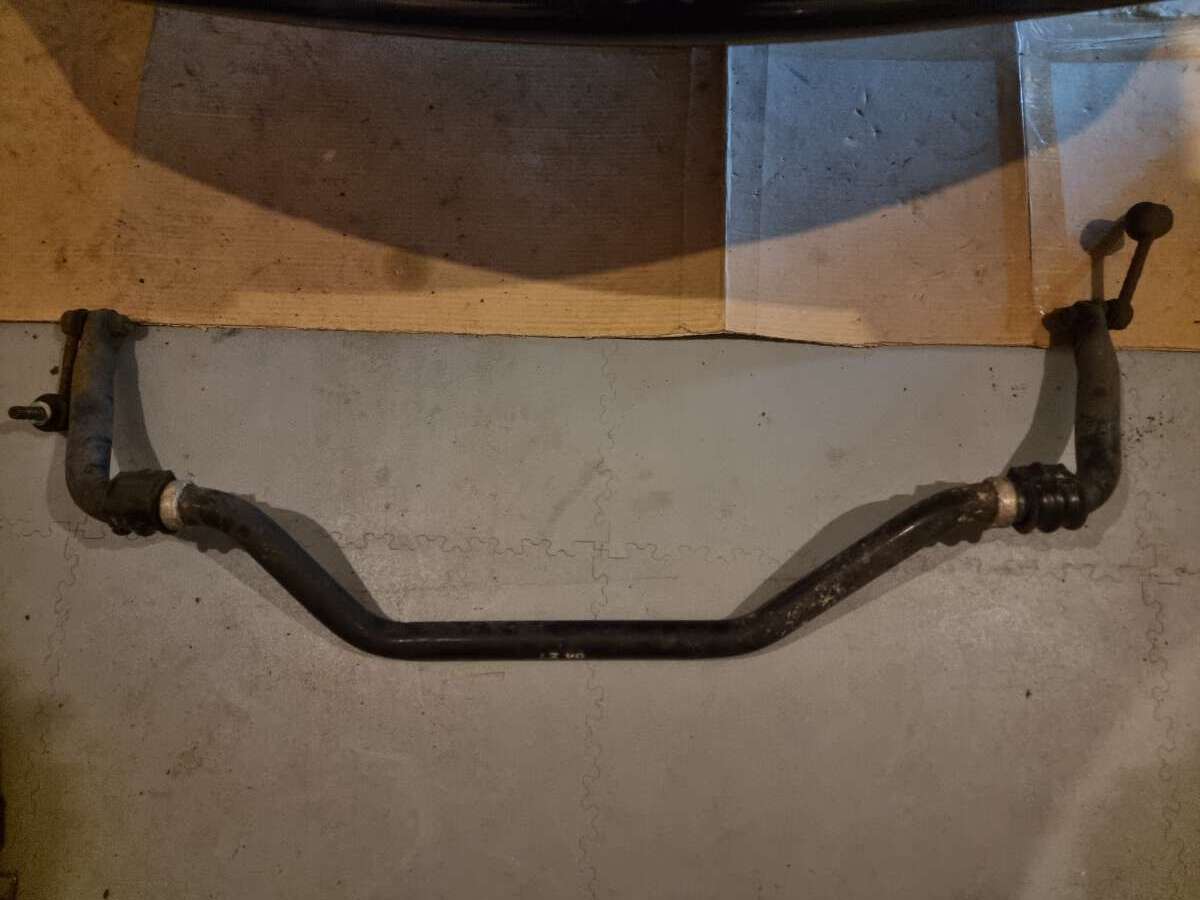

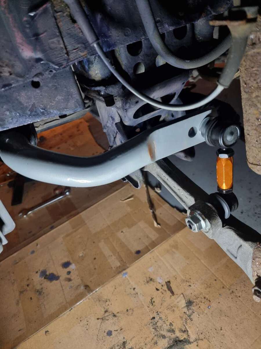

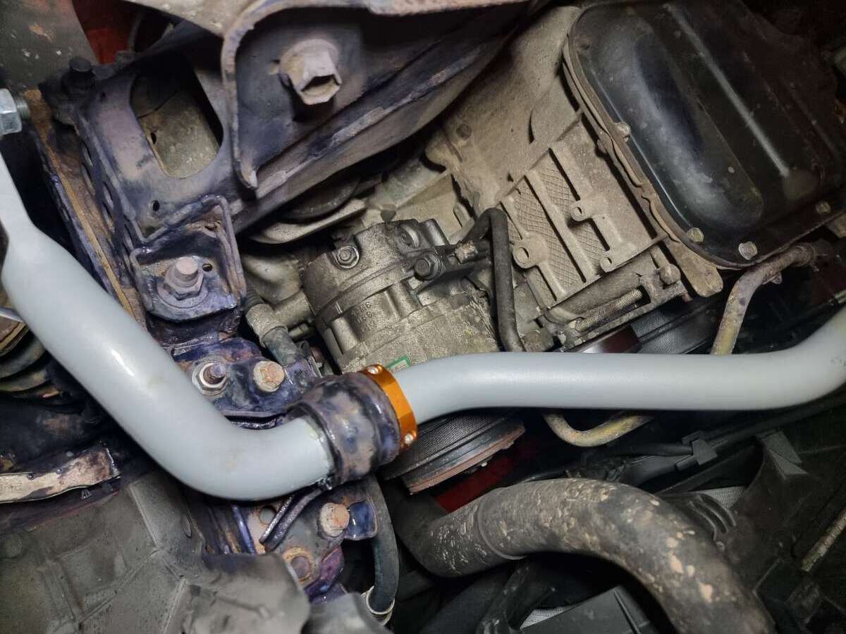

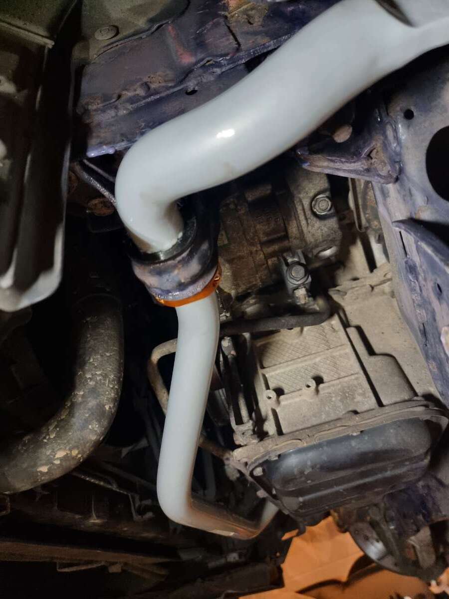

Dipper Posted December 30, 2024 Author Share Posted December 30, 2024 (edited) A few more bits done today. Still working on the front end. Suspension. Old drop links and anti roll bar off. New Whiteline ones on. Bit of rust converter painted on here and there too. And a lick of paint to the front subframe. Once it's dry the new ultra racing subframe going back on. Edited December 30, 2024 by Dipper 1 Quote Link to comment Share on other sites More sharing options...

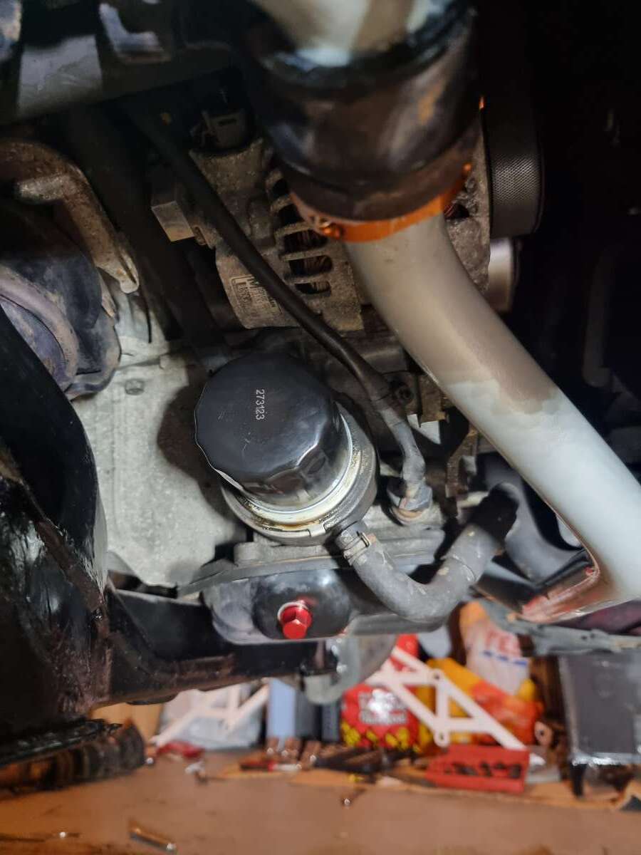

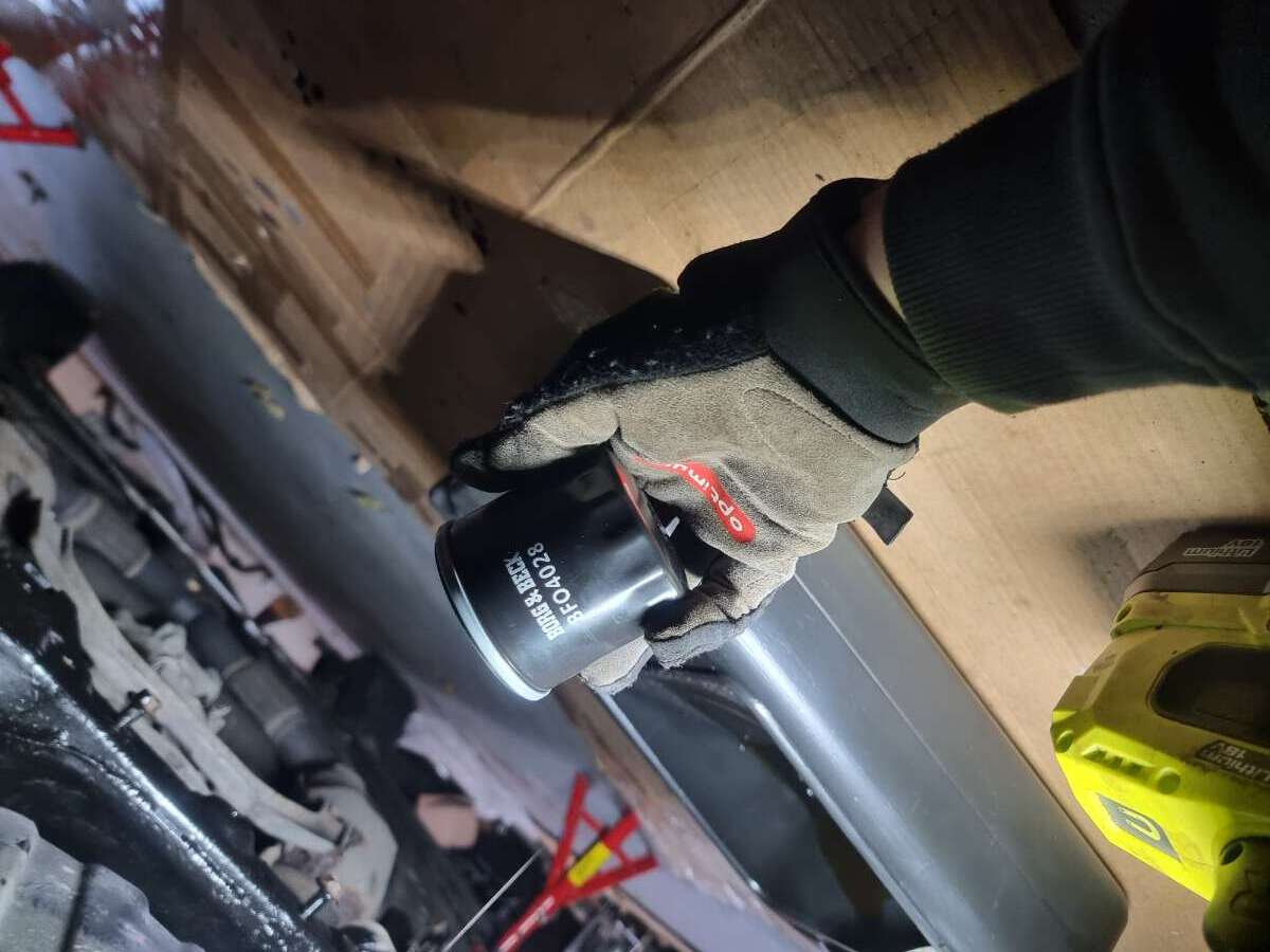

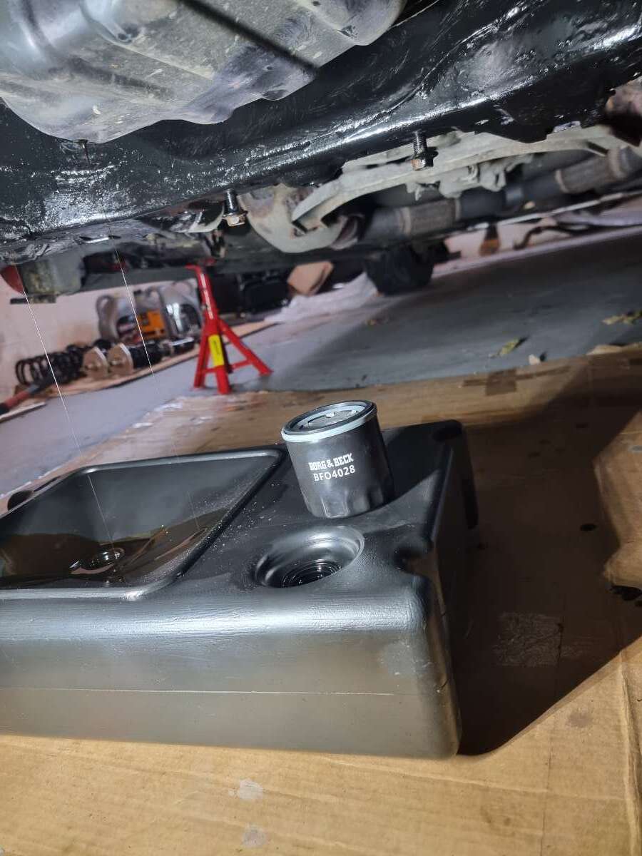

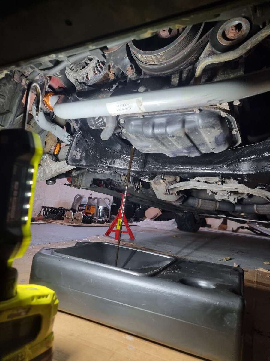

Dipper Posted January 5 Author Share Posted January 5 (edited) While it was up in the air. I treated the car to a quick oil change and filter change. Never ceases to amaze me how small the oil filter is. Added a red magnetic drain plug while I was at it. Edited January 5 by Dipper 2 Quote Link to comment Share on other sites More sharing options...

davey_83 Posted January 5 Share Posted January 5 All very lovely updates, I bet she sat nice and high at that setting for the coilovers. Nice bit of weight saving too upgrading to the BC's over stock springs and dampers. Yep these VQ35 have a wee oil filter, same size as the Micra and Almera 1 Quote Link to comment Share on other sites More sharing options...
Dipper Posted January 5 Author Share Posted January 5 2 hours ago, davey_83 said: All very lovely updates, I bet she sat nice and high at that setting for the coilovers. Nice bit of weight saving too upgrading to the BC's over stock springs and dampers. Yep these VQ35 have a wee oil filter, same size as the Micra and Almera You're not wrong. It was set to off road at that height! Had to take it waaayyy down. Lol. I'm still fine tuning truth be told. I didn't even consider weight saving you know. That's a bonus. I know the after market subframe is a good bit lighter than oem too. So should see a few kilos shaved off so! It's mad a 1.0 litre engine micra has the same filter as a 3.5 litre. Bonkers 1 Quote Link to comment Share on other sites More sharing options...
