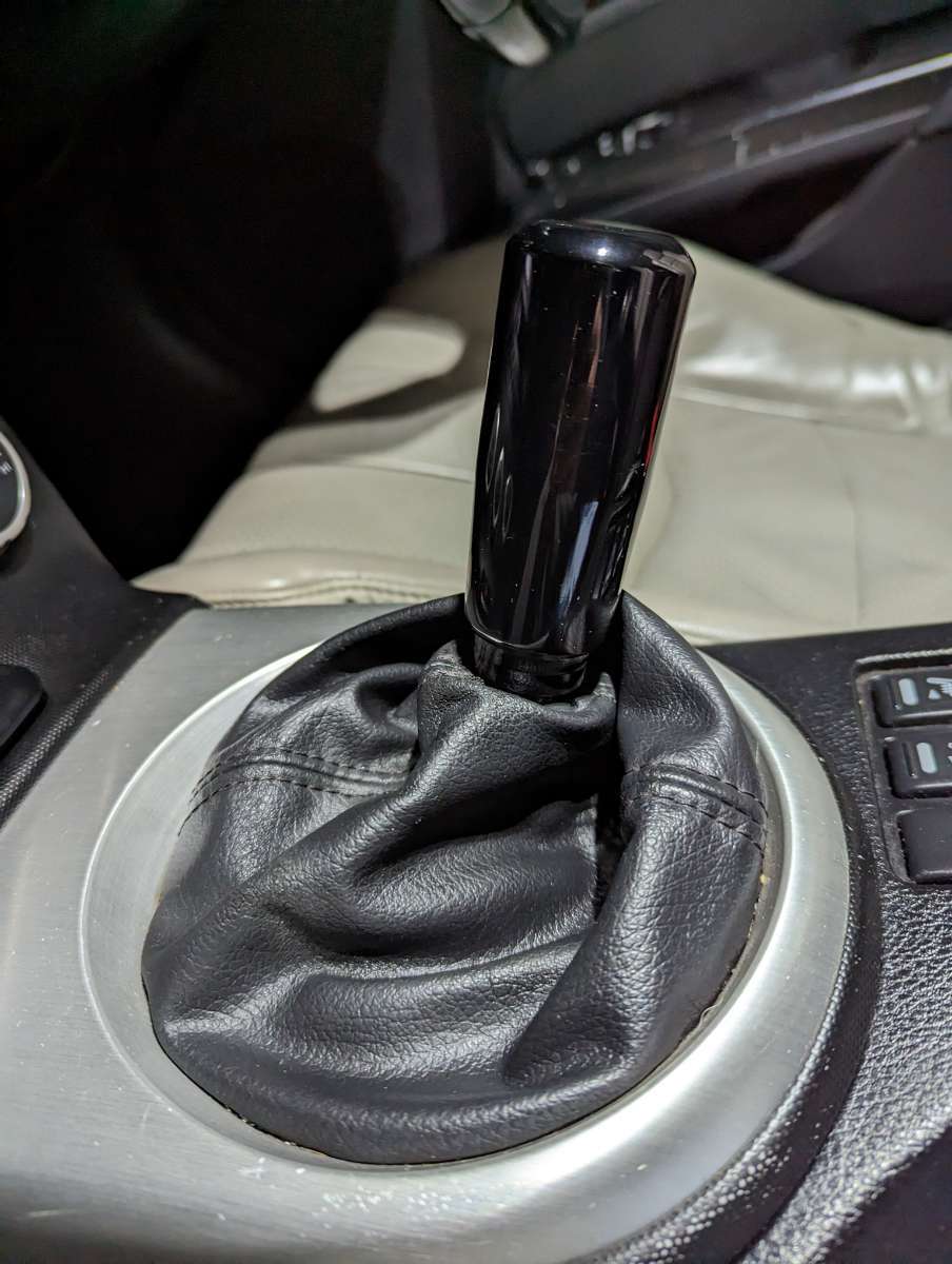

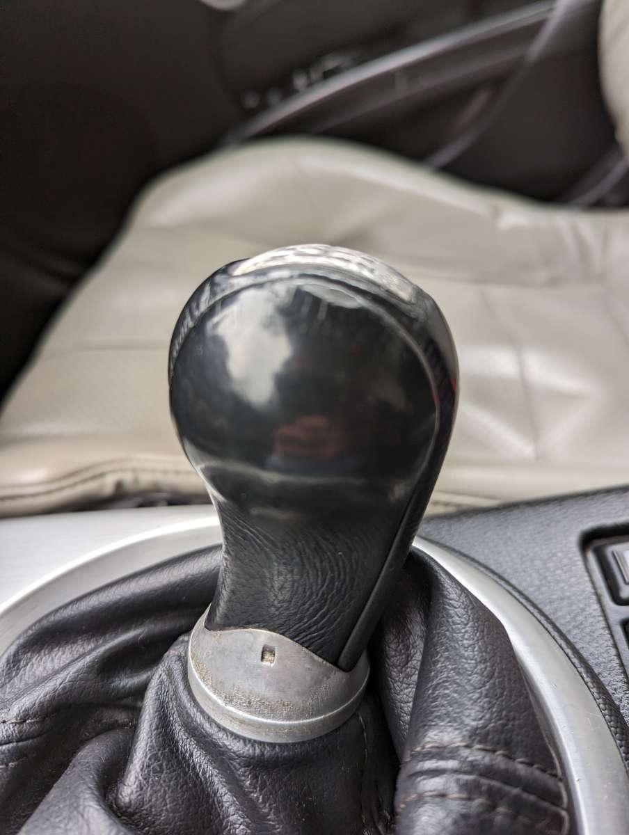

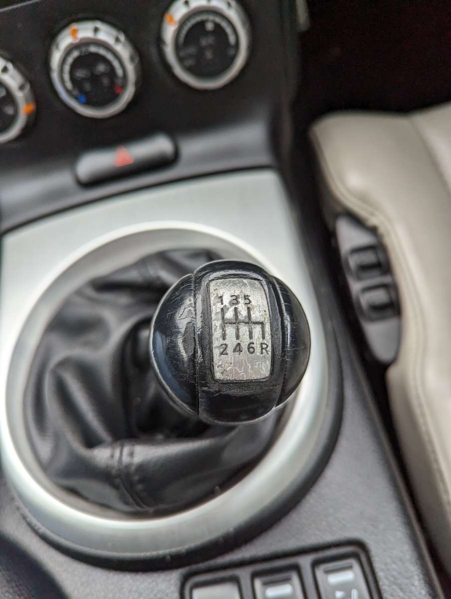

PlanGT Posted February 4, 2023 Author Share Posted February 4, 2023 Test fit of a anodized gear knob a friend machined for me as the stock one was looking a bit tired 😎 2 Quote Link to comment Share on other sites More sharing options...

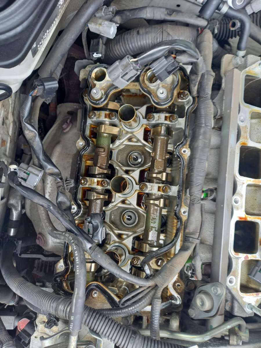

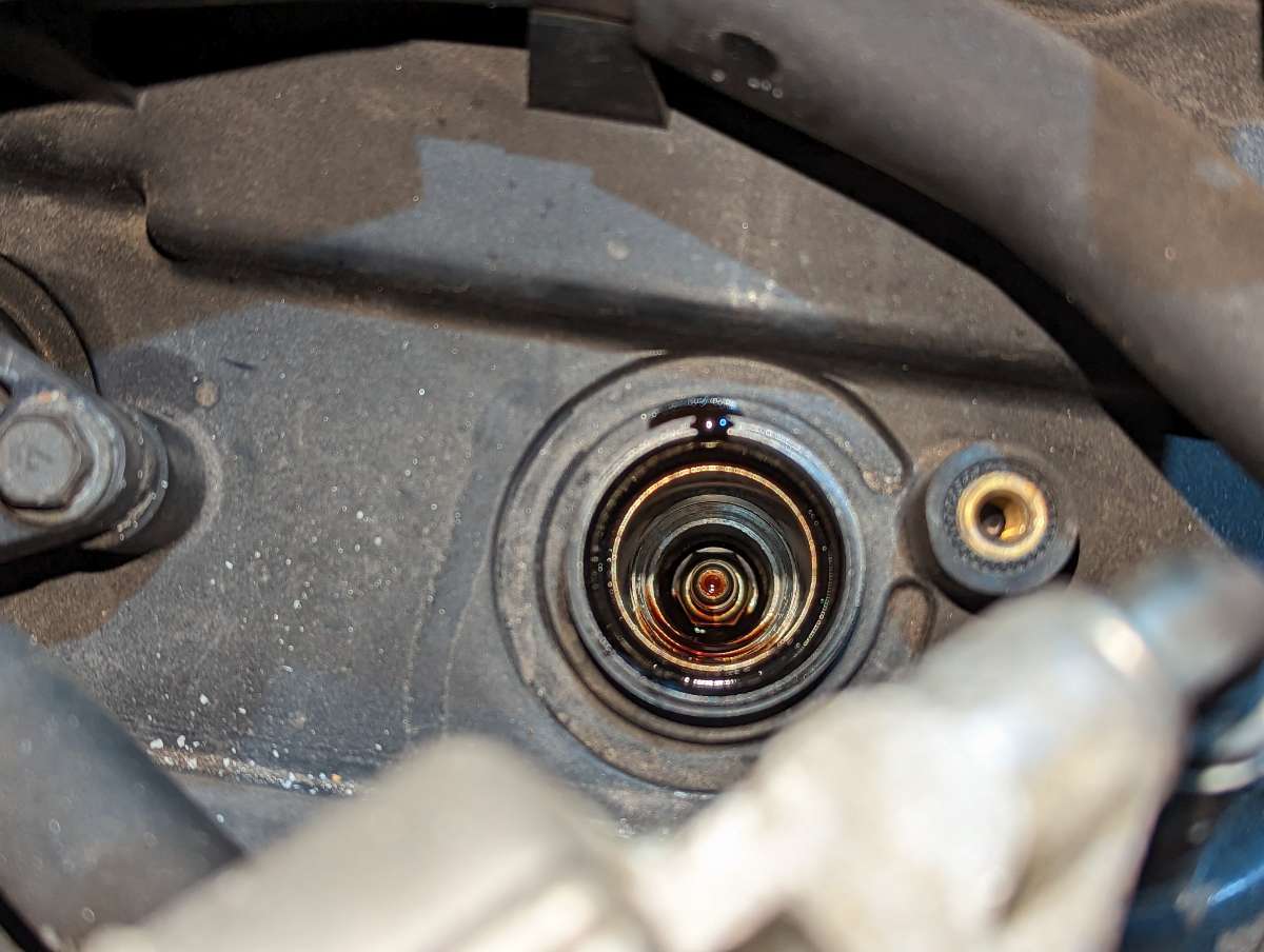

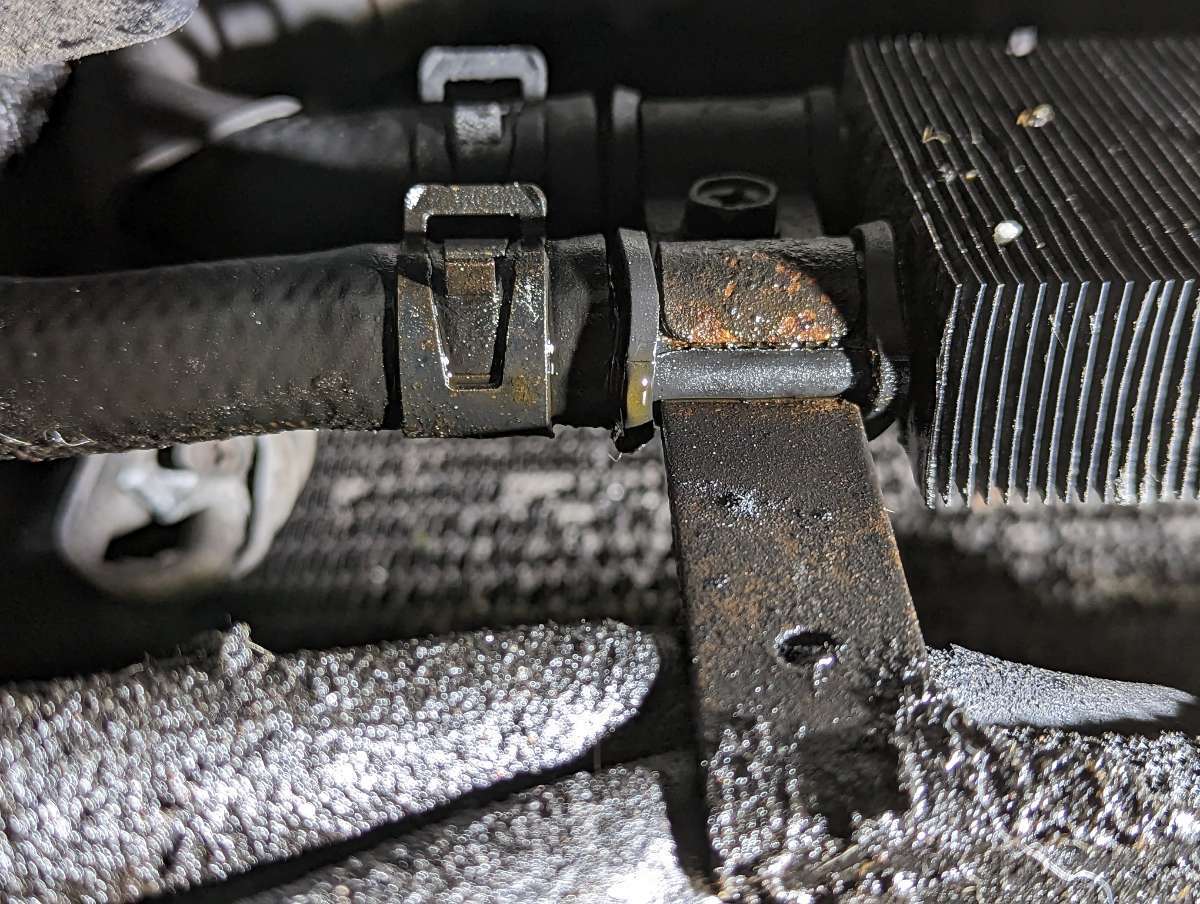

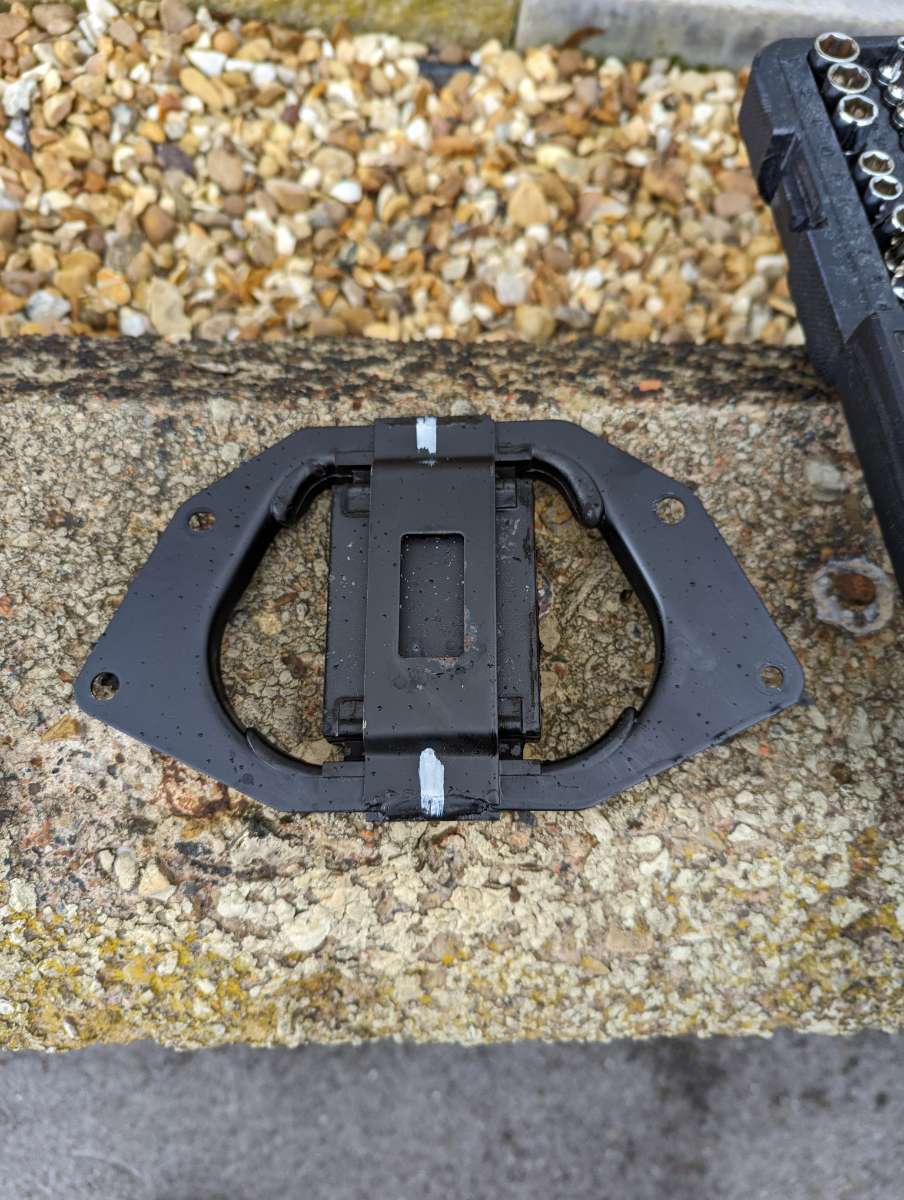

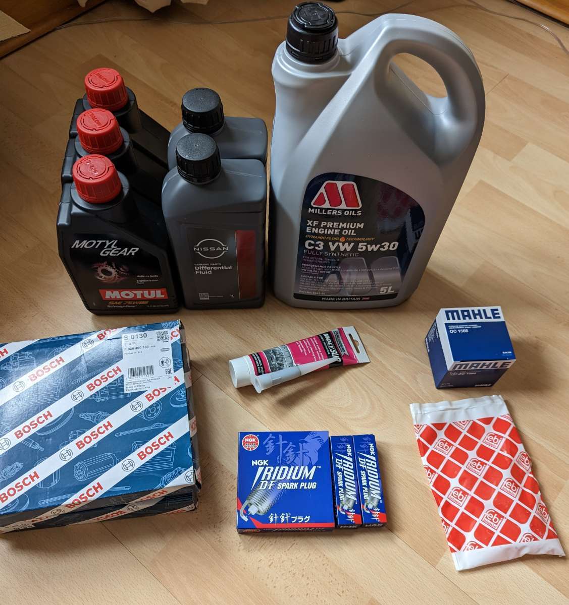

PlanGT Posted February 13, 2023 Author Share Posted February 13, 2023 Time to give the car a good service (taking some recommendations from the many helpful forum posts 😁). Judging by the fluids that came out of it, it's not been too long since most of this was done, but I always like to start from square 1 with any car I buy. Power steering cooler and hoses are definitely on the list to be addressed imminently. Apparently topping up the PS fluid was the previous solution to this... Next up lets just remove those coil packs... uh oh... Guess we'll add a new valve cover to that list too. The rear most plug was significantly worse than this, I just don't have a picture. Other than those couple of things it's looking OK right now. Definitely feels much smoother with a fresh set of fluids in 2 Quote Link to comment Share on other sites More sharing options...

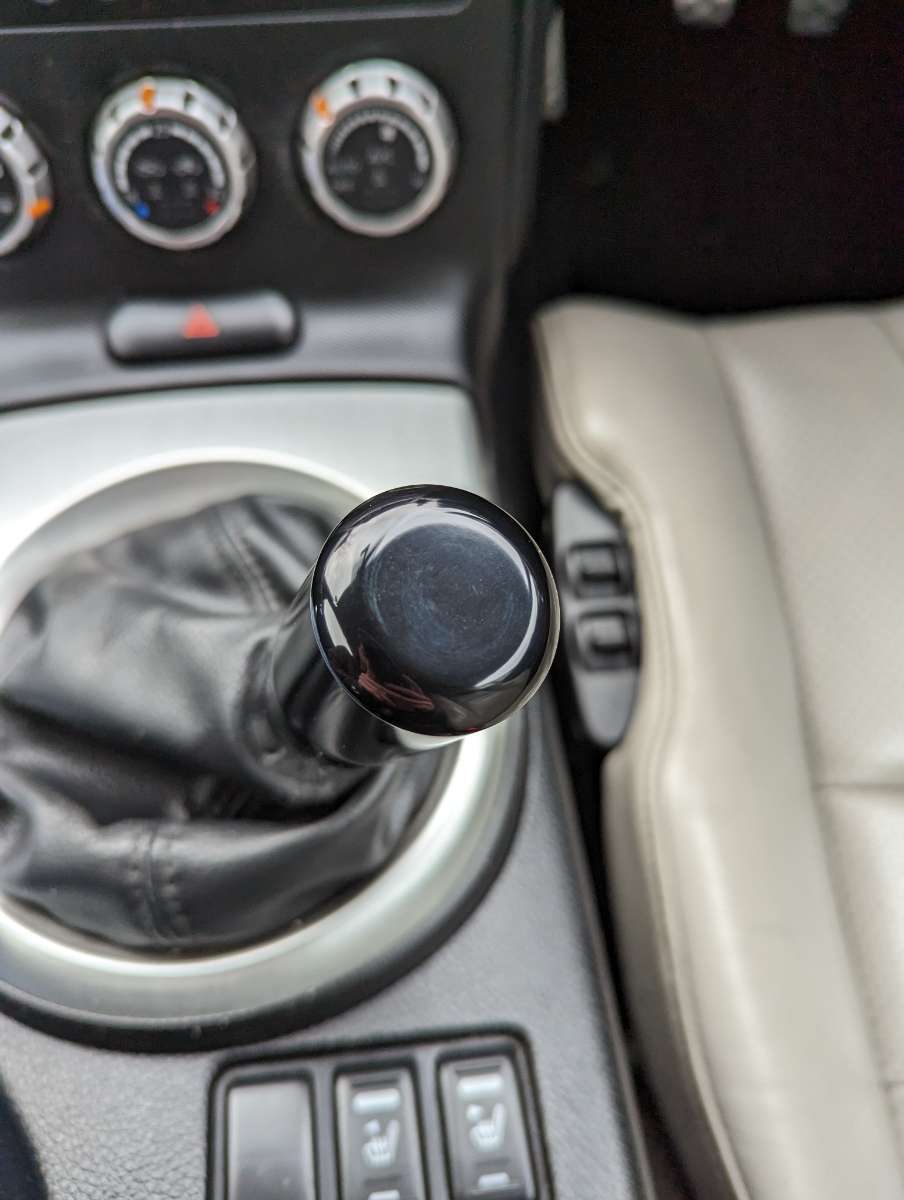

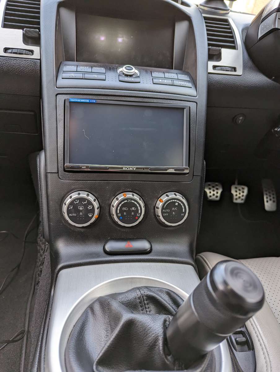

PlanGT Posted February 16, 2023 Author Share Posted February 16, 2023 Bit of additional machining by a friend to make the gear knob sit lower and add a recess for the factory gator to sit in 😎 before/ after 1 Quote Link to comment Share on other sites More sharing options...

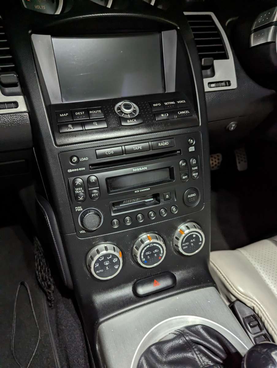

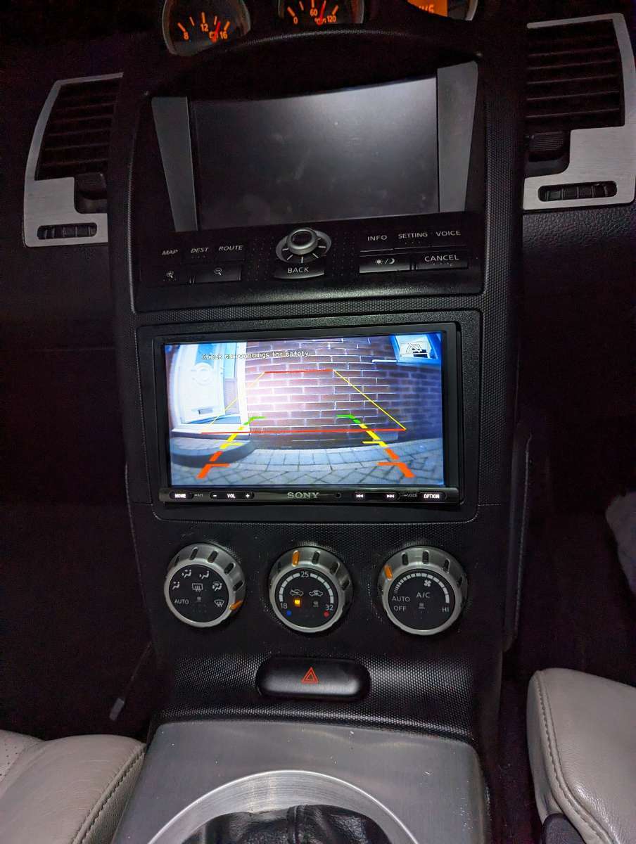

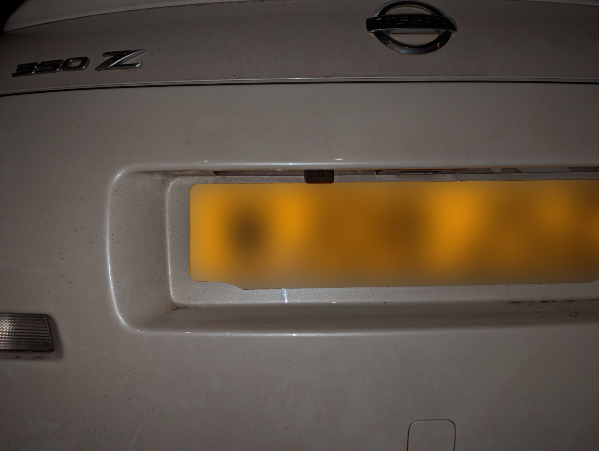

PlanGT Posted February 19, 2023 Author Share Posted February 19, 2023 This weekends activities - Install new boot struts, a head unit and a reverse camera. A massive thanks to @Stutopia for helping get it all installed. First job: Boot struts now holding the lid up strong. Also removed the weight whilst I was in there which helped too. Second up: Head unit install (upgrade from factory unit). The optional extra Clarion radio transmitter already had a nest of wiring behind the dash which was fun to work with 😅 Also fun searching for the correct cable to splice into for factory amp remote turn on. Tracked down the right wires eventually and all sounded fantastic. Even the steering wheel controls work! 😁 Head unit: Sony XAV-AX3250 Adapter harness: incartec Faceplate/ surround: incartec Last job was fitting a reverse camera in the number plate bulb location. After what felt like dismantling 90% of the car and further wiring fun, the camera comes on automatically when reverse is engaged and returns to previous screen when it's disengaged. Very happy with that Camera unit: Ebay 1 Quote Link to comment Share on other sites More sharing options...

STmichael Posted February 20, 2023 Share Posted February 20, 2023 Is the reversing camera the type that incorporates into the ref plate light? It looks good. Can you please send me the eBay link. 1 Quote Link to comment Share on other sites More sharing options...
PlanGT Posted February 20, 2023 Author Share Posted February 20, 2023 1 hour ago, STmichael said: Is the reversing camera the type that incorporates into the ref plate light? It looks good. Can you please send me the eBay link. It is one that's a split reg plate light/ camera. PM'ed you the link. Quote Link to comment Share on other sites More sharing options...

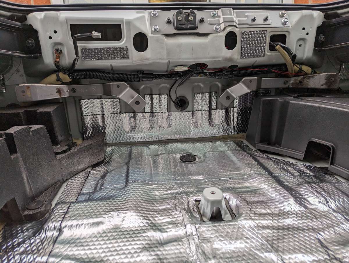

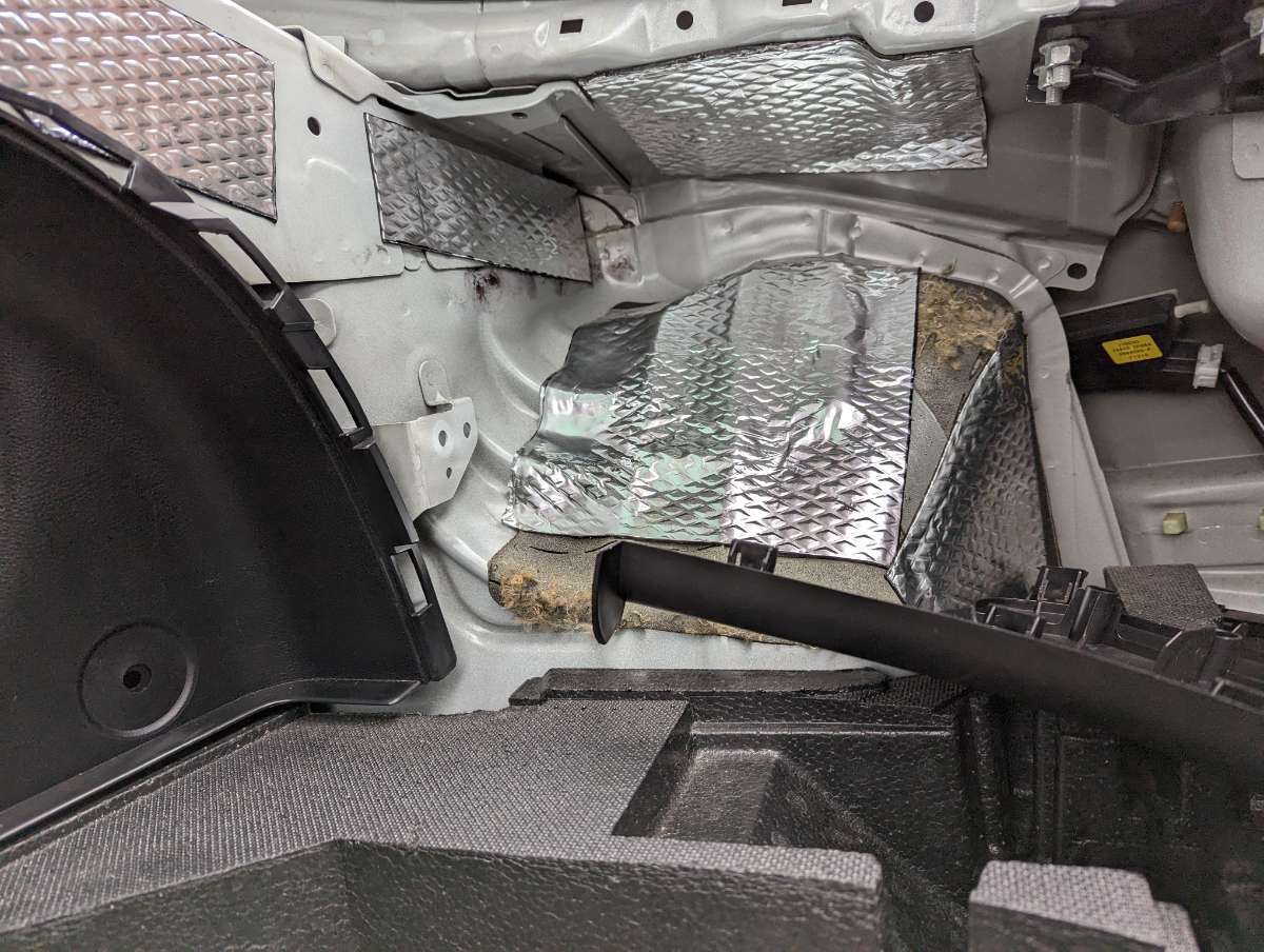

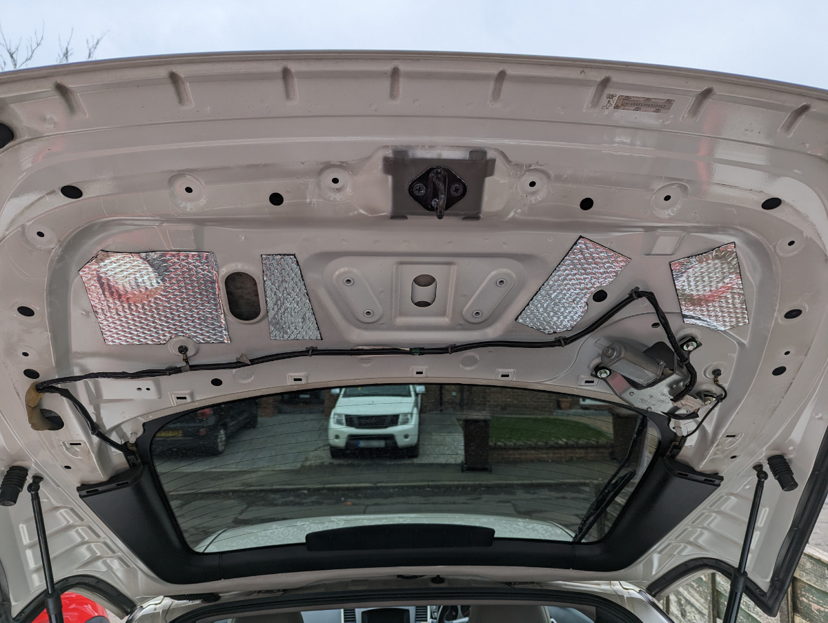

PlanGT Posted February 25, 2023 Author Share Posted February 25, 2023 (edited) This weekend's task was to add some sound deadening in the boot. Of the journeys I've done so far I've noticed quite a bit of road noise coming from the rear so hoping this will help a bit. I went with Noico 80mil after reading good reviews. Judging by some video's I'd watched, I was a bit concerned I might not have ordered enough. However the opposite turned out to be true where I've only used 4 out of the 9 big sheets with lots of usable off-cuts to spare! Admittedly as you'll see from the pictures, I've been a bit sparing in some areas but my thoughts were: 1. I don't want to cause issues getting trim panels back in place 2. I can always add more at a later date whereas taking it back off would likely be a nightmare. Fortunately all panels went back absolutely fine so I'm taking that I didn't cover up any necessary holes I'll likely add some in other areas of the car as and when I have trim panels off. To finish off the floor I added some foil tape on the seams to stop the Noico material sticking to things on top of it. Edited February 26, 2023 by PlanGT 2 Quote Link to comment Share on other sites More sharing options...

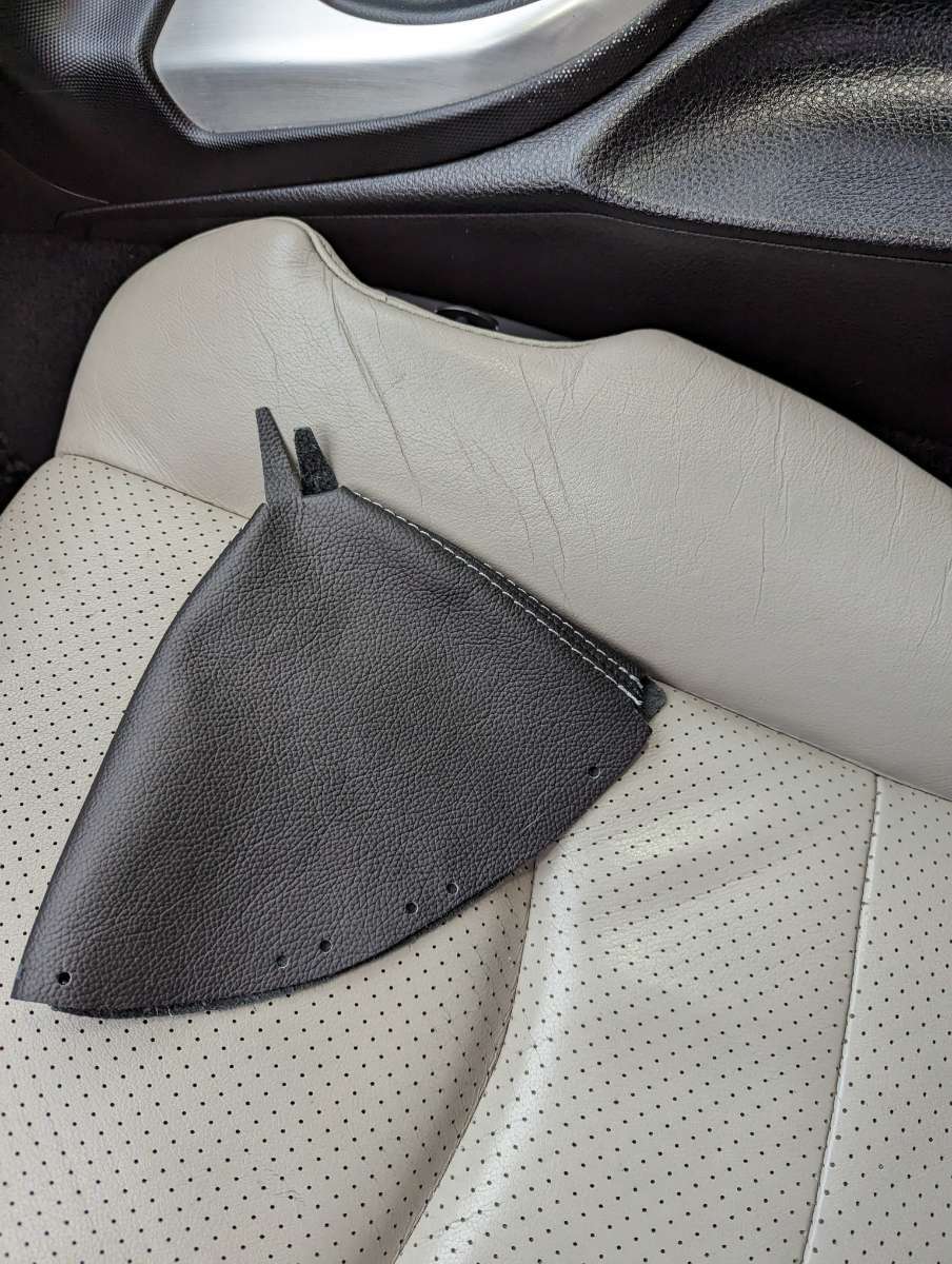

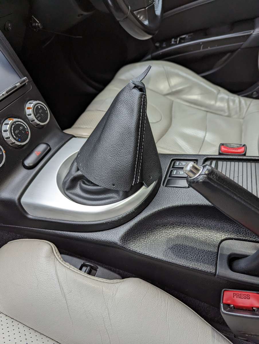

PlanGT Posted April 2, 2023 Author Share Posted April 2, 2023 Little mod this weekend putting a new gaiter in with light grey stitching (in an attempt to match the seats which I may have got a little off... 😅). Excellent fit and finish on the product from J F Customs which is always nice Also new valve covers finally fitted (from @ZMANALEX) which should stop that pesky oil getting to the spark plug holes 🤞 No pictures of the new covers on as they were fitted by a mechanic. But inside the covers looks cleaner than expected! 2 Quote Link to comment Share on other sites More sharing options...
