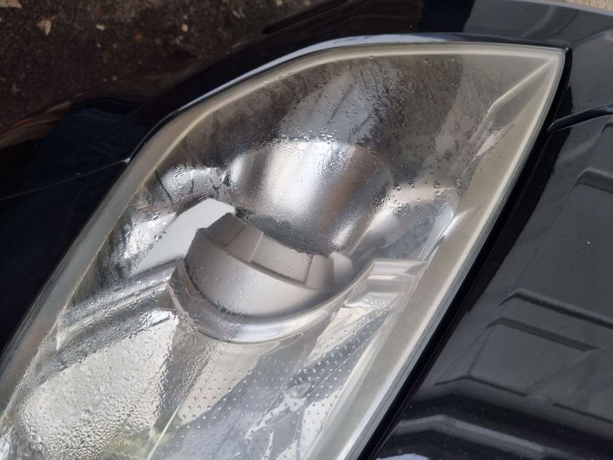

polaris Posted January 29, 2023 Share Posted January 29, 2023 (edited) Hi, I've just noticed some condensation inside the P/S headlight. I did give the car a quick clean yesterday with a pressure washer but by no means was I holding it an inch away from the headlight seals. Reading some other posts said cracking them open wasn't the best idea? Should I get a professional in to do it? Best to do both at the same time? I'm decent at car DIY. I reckon I could sort if given some trusted advice. Thanks! Edited January 29, 2023 by polaris Quote Link to comment Share on other sites More sharing options...
ZMANALEX Posted January 29, 2023 Share Posted January 29, 2023 Before you crack them open, check that the large O ring is in place on the rear of the headlight as well as the arch liner. 1 Quote Link to comment Share on other sites More sharing options...
Olly350z Posted January 29, 2023 Share Posted January 29, 2023 With Alex on this, take headlight out and remove the rear main cover and dry the headlight out in an airing cupboard. Get a new cover with O ring while you're at it and check the drainage tube isn't blocked while you're at it, jobs a goodun 1 1 Quote Link to comment Share on other sites More sharing options...

polaris Posted January 31, 2023 Author Share Posted January 31, 2023 On 29/01/2023 at 20:46, Olly350z said: With Alex on this, take headlight out and remove the rear main cover and dry the headlight out in an airing cupboard. Get a new cover with O ring while you're at it and check the drainage tube isn't blocked while you're at it, jobs a goodun What part do I need exactly? Looking on amayama, I can see two different part numbers for the cover with O-ring. Link here. Also, do you think it's worth replacing the O-ring underneath the headlight? You'll see what I mean on the link Quote Link to comment Share on other sites More sharing options...
Olly350z Posted February 1, 2023 Share Posted February 1, 2023 Personally, I'd be replacing the rear cover, number 26800N and then the seal around the lower ballest cover, number 26033M. These would be the cheapest fixes. Specifically 26800N is the main offender for letting moisture into the headlight 2 Quote Link to comment Share on other sites More sharing options...
ZMANALEX Posted February 1, 2023 Share Posted February 1, 2023 Agree with what Olly has said. ^^^ Remember that the parts for the Facelift Bi Xenons are different from the Prefacelift Xenons. 1 Quote Link to comment Share on other sites More sharing options...
polaris Posted February 1, 2023 Author Share Posted February 1, 2023 (edited) Thanks lads, appreciate it! Last question, for 26800N there are two available options, 26029-AQ000 and 26029-CF40A. Either of you wouldn't happen to know what one I'd need for my Rev Up manufactured in 2006? Saying that, maybe I should see if there's a part number for the cover on my car right now. I can cross verify it Edited February 1, 2023 by polaris Quote Link to comment Share on other sites More sharing options...
Olly350z Posted February 1, 2023 Share Posted February 1, 2023 I don't unfortunately, that's where my knowledge ends. All I can tell you with certainty is that if you have a 2006 revup, and from the photo you posted you definitely have facelift headlights 1 Quote Link to comment Share on other sites More sharing options...

polaris Posted February 3, 2023 Author Share Posted February 3, 2023 (edited) 13 hours ago, ZMANALEX said: Please post up a full frontal image off your headlamp. They need a sand, polish and lacquer. It's on the list. Edited February 3, 2023 by polaris Quote Link to comment Share on other sites More sharing options...
ZMANALEX Posted February 3, 2023 Share Posted February 3, 2023 Try: Bulb Cover & O ring: 26029 CF40A Ballast Seal: 26033 CD010 1 Quote Link to comment Share on other sites More sharing options...

Adrian@TORQEN Posted February 3, 2023 Share Posted February 3, 2023 For future reference: 350z DE Non-RevUp lights cover - 26029-AQ000 - https://www.torqen.uk/nissan/350z/body-styling/lights/21069-350z-de-nissan-oem-head-light-bulb-cover-26029-aq000.html seal - 26033-CD010 - https://www.torqen.uk/nissan/350z/body-styling/lights/10400-350z-nissan-oem-xenon-hid-ballast-o-ring-gasket-seal-26033-cd010.html 350z DE RevUp / HR lights cover - 26029-CF40A - https://www.torqen.uk/nissan/350z/body-styling/lights/77125-350z-z33-nissan-oem-cover-headlamp-05-08-26029-cf40a.html seal - 26033-CD010 - https://www.torqen.uk/nissan/350z/body-styling/lights/10400-350z-nissan-oem-xenon-hid-ballast-o-ring-gasket-seal-26033-cd010.html What we normally recommend on all the headlights with condensation, OEM, DEPO, Spyder, Anzo etc: 1. replace the ballast O rings / seals with brand new seals 2. ensure you have wheel arch liners and undertray fitted 3. remove the light off the car, slowly dry the inside using a hair dryer 4. add a small silica gel bag inside the headlight, tucked away from any bulbs and secured into place. 5. re-install the lights 1 1 Quote Link to comment Share on other sites More sharing options...

polaris Posted March 26, 2023 Author Share Posted March 26, 2023 Received and fitted parts. Confirmed no condensation in the P/S headlight. Just checked today and I can see some moisture building up again Next steps? Quote Link to comment Share on other sites More sharing options...
Olly350z Posted March 27, 2023 Share Posted March 27, 2023 Have you checked the small drainage tub on the headlight normally located on the bottom? Will be a small rubber tube about an inch long with a 90 degree bend, designed to let the headlight breath. I wonder if that's blocked Quote Link to comment Share on other sites More sharing options...
