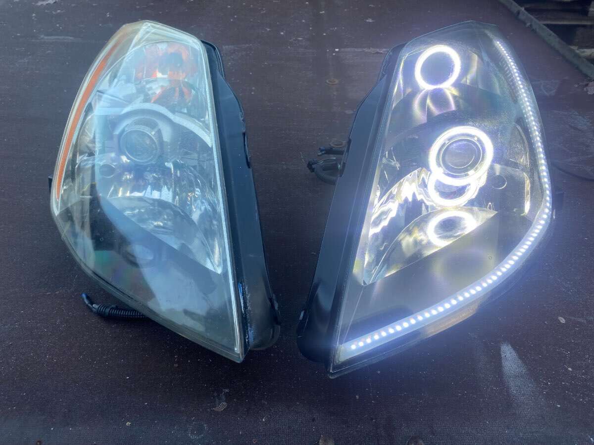

While the weather has been bad… started working on the headlights, to give the standard ones a bit of a refresh!
Heated them up and split them, removed the amber strip, painted the top chrome section satin black, added 3 led halos and sequential flowing indicator strips / drls.
A more modern look for less than £25 per side.
I’ll fit led dip and main beam bulbs to complete the look.
