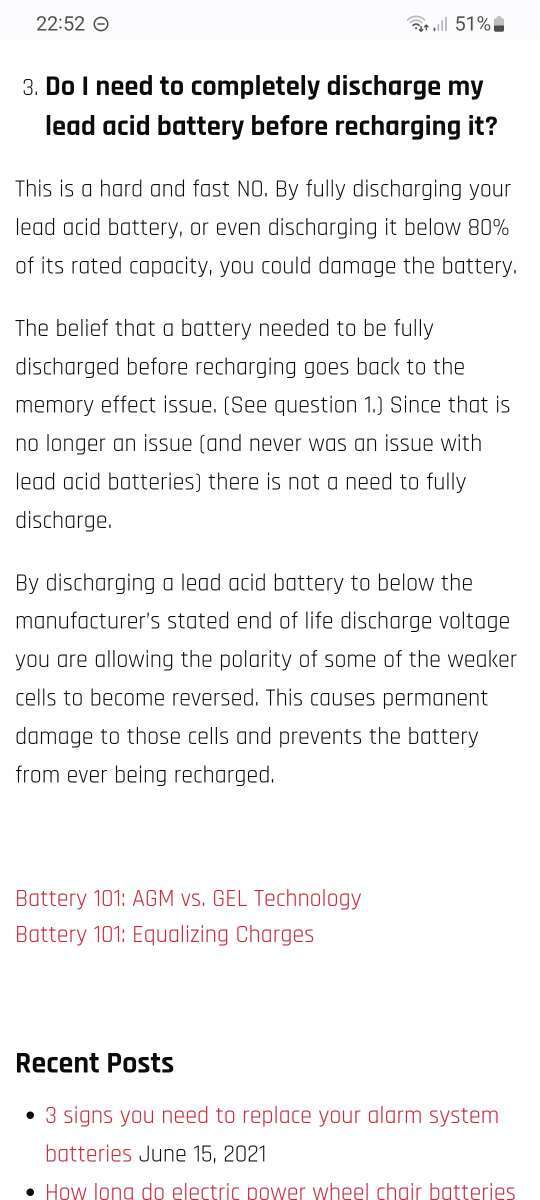

Jack94 Posted October 4, 2022 Share Posted October 4, 2022 The battery won't currently be at 100% charge, and once it goes below 80% the cells can be damaged. The self discharge rate can be up to 10%/month. Quote Link to comment Share on other sites More sharing options...
