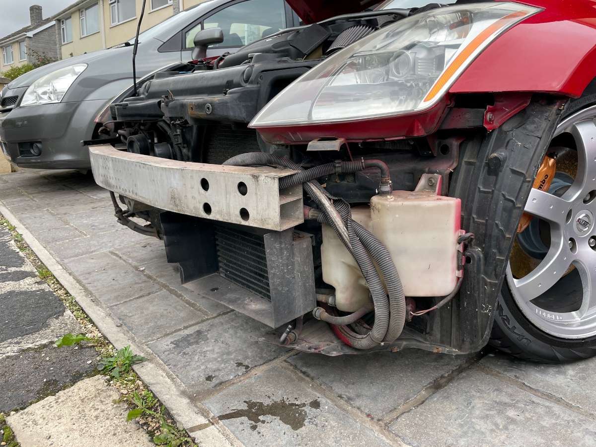

SW66TTT Posted September 27, 2022 Share Posted September 27, 2022 I decided to take my front bumper off the find even more bodge jobs by a previous owner. the passenger side of the bumper was connected to the wing using a piece of wood! They painted the bumper on the car and theres overspray everywhere! I'm going to get a new front bumper and my car has the headlight washers although 1 side is missing. its got a big water bottle each side and loads of pipes can I simply rip it all out and bung up the connection to the main water bottle in the engine bay? Many thanks Quote Link to comment Share on other sites More sharing options...
davey_83 Posted September 27, 2022 Share Posted September 27, 2022 You can't rip it all out as you'll need working windscreen washer jets (same reservoir) for the annual MOT. You remove the passenger side container, as it feed the headlights I believe only. Quote Link to comment Share on other sites More sharing options...
SW66TTT Posted September 27, 2022 Author Share Posted September 27, 2022 5 minutes ago, davey_83 said: You can't rip it all out as you'll need working windscreen washer jets (same reservoir) for the annual MOT. You remove the passenger side container, as it feed the headlights I believe only. Thanks! probably best to work out exactly where each pipe goes and work it back from the headlight washers to make sure I just remove the bits for the headlights Quote Link to comment Share on other sites More sharing options...
davey_83 Posted September 27, 2022 Share Posted September 27, 2022 Bingo Quote Link to comment Share on other sites More sharing options...
