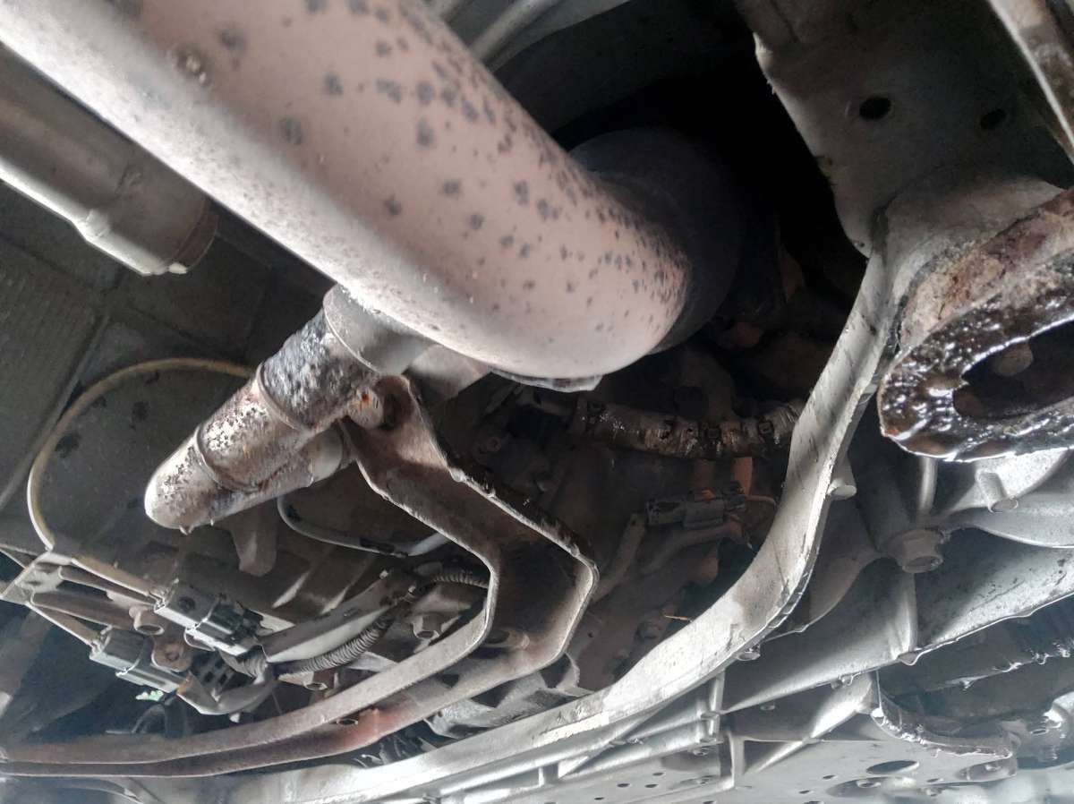

Amz Posted September 8, 2022 Share Posted September 8, 2022 Hey folks, got a tale as old as time; failing my MOT on emissions with High Flow Cats. Taken the Z for it's first MOT under my ownership. The seller informed me the car has High flow cats and a MagnaFlow catback exhaust - I visually confirmed that it wasn't on test pipes. It's passed all of it's prior MOTs on emissions, but this time the test registers a Carbon Monoxide reading of 0.865, 4 times over the legal limit of 0.2. Took the car out for a spirited drive, high revs, oil temp up at 110°C, and whacked it straight back into the test, but the reading didn't change outside of a margin of error. I don't imagine Catalyst cleaner will drop the result by 4x. Outside of the test, I've regularly had the car throw a CEL for both O2 sensor banks. A prior owner had extended bungs welded for the lambda sensors to attempt to address this fault. I usually reset it with an OBDII scanner and it vanishes for a week or so. I'm wondering whether I have the same issue experienced by this gentleman , a lambda offset applied by the ECU, causing a rich map. I'm not sure what equipment I could cheaply purchase to check for this, or whether it'd appear on a standard OBDII scanner? I don't have an EcuTek flash on this car. The car generally smells extremely rich always, not just on cold start. Outside of this, with the Carbon Monoxide reading not changing when extremely heated (and such a high reading), is it possible the cats are completely blown through? I'm open to replacing them with a new set, but I'd hate to go through the cost and trouble only to fail again. If so, any reasonably priced HFC recommendations? I'm seeing mixed reports on the Berk Technology and Torqen ones. The garage informed me there is no exhaust leak. I can't confirm when the HFCs were fitted, or the brand, as it wasn't the previous seller who had the work done. Any help greatly appreciated Quote Link to comment Share on other sites More sharing options...

Amz Posted September 11, 2022 Author Share Posted September 11, 2022 Thanks for all of the replies guys. Olly, what you're suggesting seems spot on with regard to the CEL - there are some proper dodgy right angle extensions, at least 30cm in length that they'd welded to alleviate the issue instead of doing it right with the remap. I believe it was a P2A00 sensor code for one of the banks, but both banks definitely threw their own code - both of them failing seems unlikely. Will get them to throw again before the prior MOT expires and drag it down to Horsham Developments to see what they have to say. Bytespc, from reading the CO report on the 2021 MOT, it registered as 0.0, so presumably that garage is a bit 'friendlier'. Not local to me, it's in Wolverhampton and I'm in Cambridge, happy to DM the garages name to you. Hoping to get this thing done the right way though, if I can. Given the state of the cats and exhaust system (really quite rusted, pic attached, bung visible), I wouldn't be surprised if they are just shagged though. Will report back once I've had a diagnostic done. Quote Link to comment Share on other sites More sharing options...
