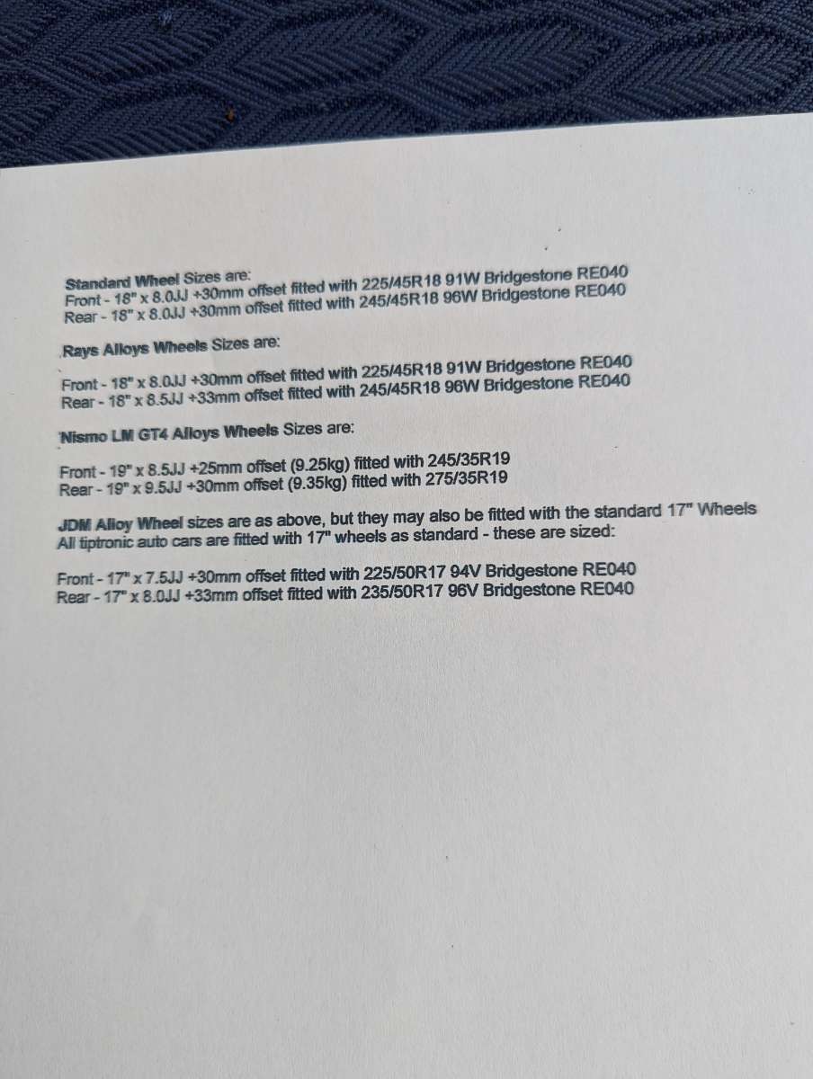

ZMANALEX Posted August 28, 2022 Share Posted August 28, 2022 To add to the above, from my notes: Quote Link to comment Share on other sites More sharing options...
SWoMP Posted August 28, 2022 Author Share Posted August 28, 2022 Thats interesting Alex so Thankyou also. It seems the wheels noted as Nismo LM GT4 are not the same as those fitted to the GT4 cars (which were also called "35th Anniversary Edition" cars). Quote Link to comment Share on other sites More sharing options...
ZMANALEX Posted August 28, 2022 Share Posted August 28, 2022 The UK GT4 LM1 rims are: Front: 18 x 8JJ OS 30 Rear: 18x 8.5jj OS 33 Quote Link to comment Share on other sites More sharing options...
SWoMP Posted August 28, 2022 Author Share Posted August 28, 2022 Same as the UK Rays then. Thanks again. Quote Link to comment Share on other sites More sharing options...
