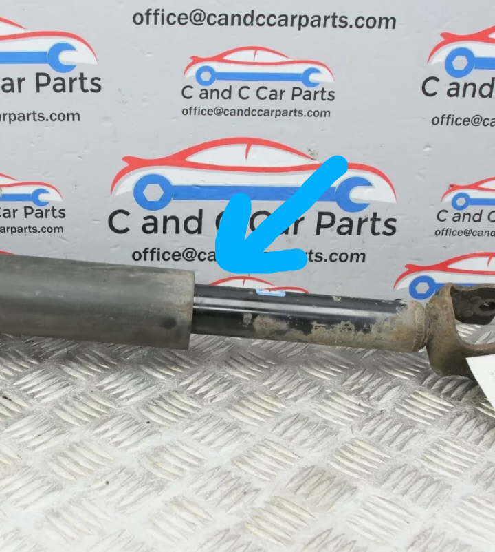

davey_83 Posted August 26, 2022 Share Posted August 26, 2022 21 hours ago, KUGT4 said: That isn't where you would traditionally see a leak as that's only the plastic cover. A leak if present would be visible on the body of the shock absorber itself as per the below. Quote Link to comment Share on other sites More sharing options...
KUGT4 Posted August 26, 2022 Author Share Posted August 26, 2022 (edited) Cheers, yep, lower part looks caked in dirt and looks 'moist' - will post pictures - all this occurred both sides since the MOT in Feb 22? Nissan supplied part number N56210CD325 as a replacement part - can't find anything about it anywhere - anybody know what this part number includes? - springs? Edited August 26, 2022 by KUGT4 Quote Link to comment Share on other sites More sharing options...
