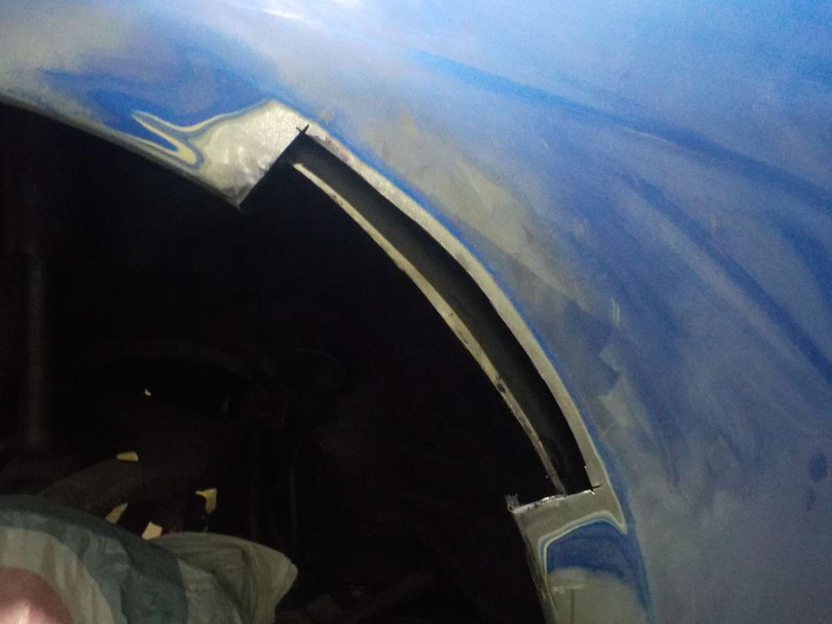

chinny Posted September 21, 2022 Author Share Posted September 21, 2022 Progress As i had to use a new front wing for the repair panel it was a right barsteward to get it to the right shape and keep the body line correct for the rear bumper to line up(fingers crossed) Offside is needing some attention for the low spots and then should be good to go. 2 new butchered front wings for the inner and outer repair panels(sorry ay i). 1 Quote Link to comment Share on other sites More sharing options...
ShortPaul Posted September 22, 2022 Share Posted September 22, 2022 Good on you buddy, i haven't heard of anyone doing it that way before, its looking like a good repair from where i am sitting 👏 Quote Link to comment Share on other sites More sharing options...

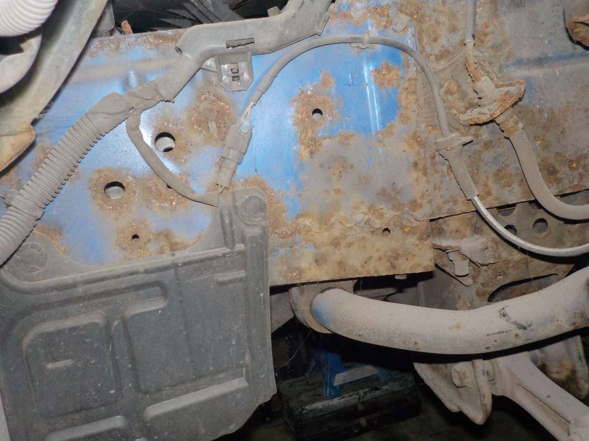

chinny Posted January 29, 2023 Author Share Posted January 29, 2023 Took both front wings and arch liners off to see what was lurking behind them! It looks worse than it is,mainly just surface rust apart from the brake lines need renewing(DONE) Quote Link to comment Share on other sites More sharing options...
chinny Posted January 29, 2023 Author Share Posted January 29, 2023 After muchas wire wheeling i gave it a coat of Zinc primer and blasted it with a 50/50 mix of Tetra shutz and Waxoyl. I also filled all the box sections/chassis rails and inner sills with cavity wax.(One job i hope never to do again)😝 1 Quote Link to comment Share on other sites More sharing options...
