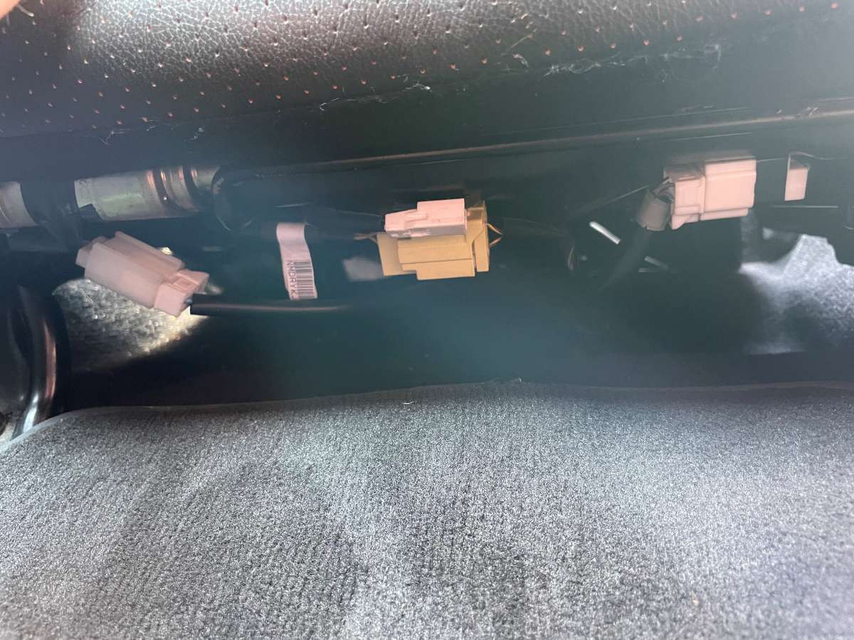

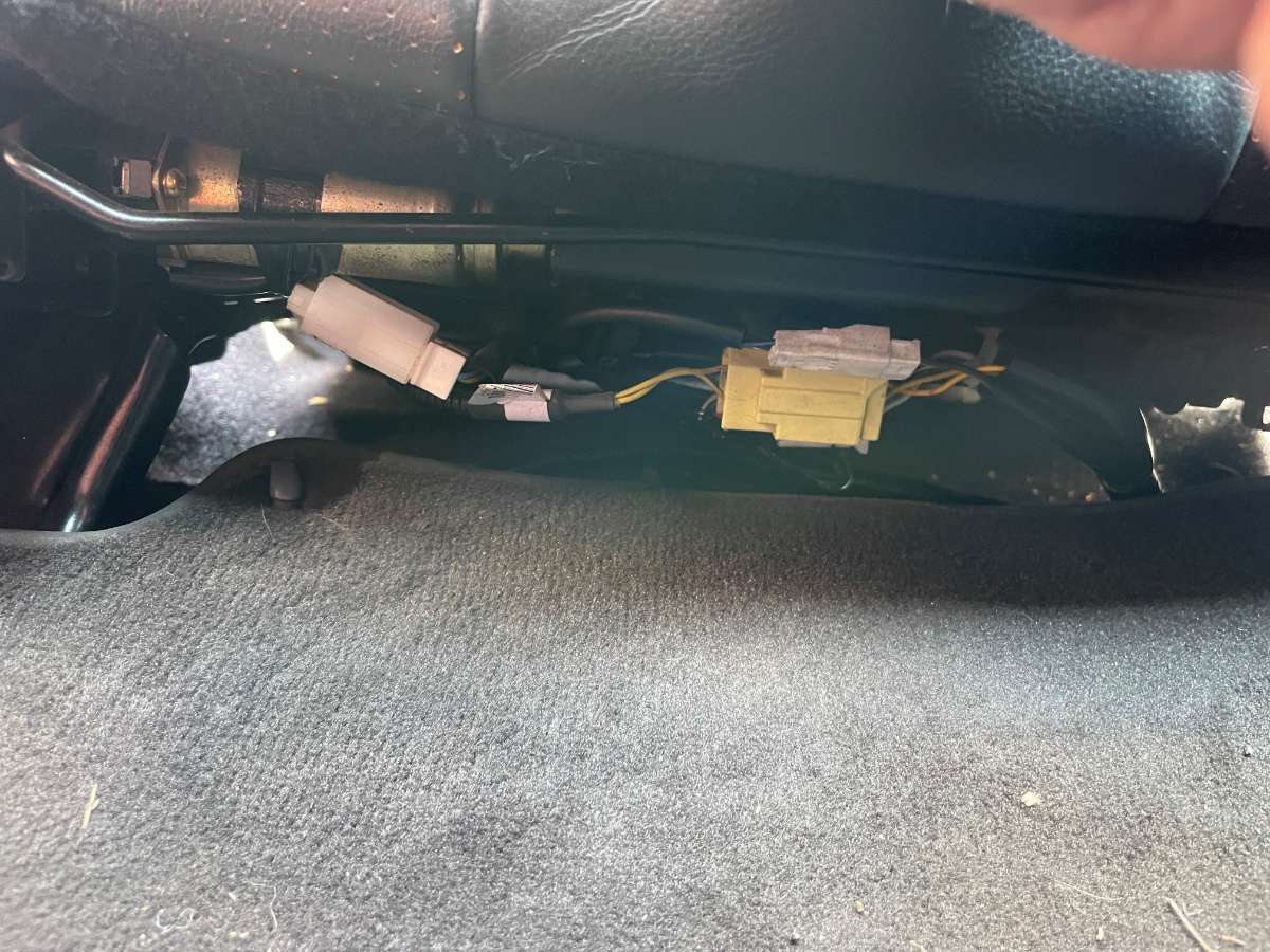

SW66TTT Posted August 6, 2022 Share Posted August 6, 2022 I have a MOT due and having some issues with dash lights, I have the flashing airbag light, I tried the 4 ignition on and off trick but the flashing still remains. the instructions for ignition on and off says turn ignition on wait for the light to go off but it doesn't actually go off just starts flashing, I still did it 4 times. I have nothing under my seats, the passenger seat has one missing, the small white one, is that normal? see pictures Also I randomly get the 3 orange lights coming on (see picture) might not do it for ages then will just come on while driving, they come on and stay on until I turn off and back on then they go. Will the lights fail a MOT? Quote Link to comment Share on other sites More sharing options...

Azurez33 Posted August 7, 2022 Share Posted August 7, 2022 Get somewhere to diag scan it so you know where the issue roughly is then go from there, could a simple fix like a WSS gone down but check first, You could just do the srs reset before the mot then address the issue later if you want to save money and store it, the diag san should do a full system sweep so you’ll get rough answers then. 1 Quote Link to comment Share on other sites More sharing options...
