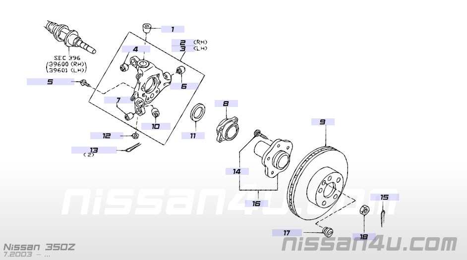

Initially just compare the suspension arms, hubs etc with the other side.
If there is significant damage it will be noticeable, however the slightest  damage which may not be visible to the eye will give you issues.
All parts that you may require are in stock and good to go, just drop me a PM if I can help further.
The lower arm is not meant to be straight, so do compare with the other side, the spring carrier is also easily damaged as is the main bearing carrier (knuckle)
