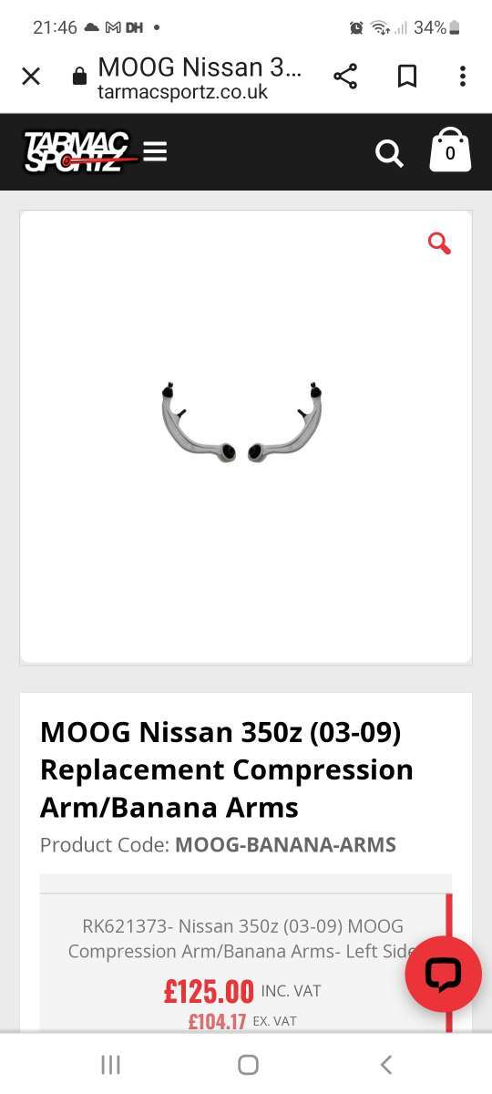

HEADPHONES Posted July 21, 2022 Share Posted July 21, 2022 A few years back I told my garage about a creak from the front. They couldn't find anything either. 6 months later at MOT the part had perished enough to reveal itself Needed some of these Quote Link to comment Share on other sites More sharing options...
