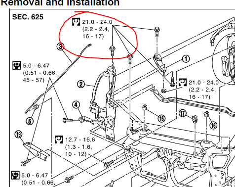

polaris Posted July 10, 2022 Share Posted July 10, 2022 Hi, anyone know the recommended torque spec for this bolt? See below picture. 01121-07341 If you know could you please share where you found out. I've been scouring the factory service manual since this morning but haven't been able to find it. Quote Link to comment Share on other sites More sharing options...
Willsy1980 Posted July 10, 2022 Share Posted July 10, 2022 As its not structural or crucial, i'd say tighten till it bites then add 90 degrees. Not sure if there is a spec for torqueing wing fixings ? Quote Link to comment Share on other sites More sharing options...
polaris Posted July 10, 2022 Author Share Posted July 10, 2022 (edited) 2 hours ago, Willsy1980 said: As its not structural or crucial, i'd say tighten till it bites then add 90 degrees. Not sure if there is a spec for torqueing wing fixings ? Managed to find the right torque spec but at around 15nm it sheared right off lol, thankfully I was able to get the remaining bolt out I suspect the bolt was fatigued due to the constant heat cycle Need a new one now Edited July 10, 2022 by polaris Quote Link to comment Share on other sites More sharing options...
Willsy1980 Posted July 11, 2022 Share Posted July 11, 2022 Was is supposed to be nm and not ft lbs ? Quote Link to comment Share on other sites More sharing options...
polaris Posted July 11, 2022 Author Share Posted July 11, 2022 (edited) 9 minutes ago, Willsy1980 said: Was is supposed to be nm and not ft lbs ? Checked that! Definitely n-m. I had two new front bumper bolts lying around so replaced both of them to 7nm. Edited July 11, 2022 by polaris 1 Quote Link to comment Share on other sites More sharing options...
