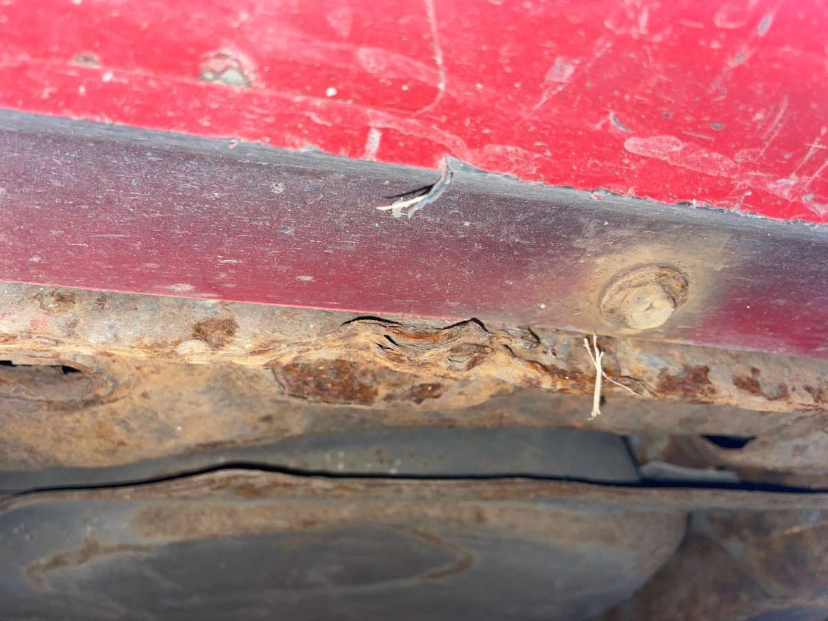

SW66TTT Posted July 1, 2022 Share Posted July 1, 2022 this is starting to look expensive 🤑 Quote Link to comment Share on other sites More sharing options...
Azurez33 Posted July 1, 2022 Share Posted July 1, 2022 You need to pull off the side skirts at this rate too sorry mate it’s all fixable with deep enough pockets or enough time and knowledge which is available here 😊 Quote Link to comment Share on other sites More sharing options...
polaris Posted July 1, 2022 Share Posted July 1, 2022 Doesn't look too bad in my opinion. Looks mostly like surface rust. The condition of the w brace usually dictates the what the rest of the car will look like. Quote Link to comment Share on other sites More sharing options...

Azurez33 Posted July 2, 2022 Share Posted July 2, 2022 On 02/07/2022 at 05:58, Loadmaster said: Seeing this sort of thing really does put me off keeping my 370 long term, which is unfortunate. Okay, mine is only five years old at the end of this year, but I've recently been told that it's not a case of "if", but "when", the rot sets in. Expand I mean yes and no aha, if keep it in an air bubble and always get rid of moisture heated garage etc will be fine. This one looks particularly sketchy as might have been incorrectly jacked up in the past which usually Allows moisture into the sill cavity 1 Quote Link to comment Share on other sites More sharing options...
Payco Posted July 2, 2022 Share Posted July 2, 2022 On 02/07/2022 at 05:58, Loadmaster said: Seeing this sort of thing really does put me off keeping my 370 long term, which is unfortunate. Okay, mine is only five years old at the end of this year, but I've recently been told that it's not a case of "if", but "when", the rot sets in. Expand Under seal it as it’s a newish car. I’m not undersealing mine as there is a risk I may be sealing in under surface rust but given the age of your z if you are concerned about the long term get it professionally undersealed. Some good places in Sussex too. 1 Quote Link to comment Share on other sites More sharing options...

SW66TTT Posted July 2, 2022 Author Share Posted July 2, 2022 really I need to get it in a ramp and have a proper look, work out what bits are too far gone and need replacing or need work. Whats the best plan with the surface rust? sand it down and apply a treatment? Quote Link to comment Share on other sites More sharing options...
SW66TTT Posted July 2, 2022 Author Share Posted July 2, 2022 I've been watching the road and race videos on youtube, that guys a legend I wish i could strip the whole underneath of the car down but I dont have anywhere to do it, its a pain just jacking the car up as my driveway is a slope Quote Link to comment Share on other sites More sharing options...
Payco Posted July 2, 2022 Share Posted July 2, 2022 (edited) https://www.dinitroldirect.com/underbody-protection-dinitrol-lindfield/ PS I wouldn’t use waxoil. Dinitrol for the job. Edited July 3, 2022 by Payco 2 Quote Link to comment Share on other sites More sharing options...
Willsy1980 Posted July 5, 2022 Share Posted July 5, 2022 As above, waxoil tends to dry up and shrink. Cracks and kinda defeats its purpose longterm. Then its a ba**ard to get off again 1 Quote Link to comment Share on other sites More sharing options...

Payco Posted November 14, 2022 Share Posted November 14, 2022 I wouldn’t spend the money Keith unless you are keeping the car long long term. 1 Quote Link to comment Share on other sites More sharing options...
Loadmaster Posted November 14, 2022 Share Posted November 14, 2022 On 14/11/2022 at 17:11, Payco said: I wouldn’t spend the money Keith unless you are keeping the car long long term. Expand Thanks Martin - "long term" will be another 3.5 years which is when I plan on retiring. At that point the car will be eight and a few months old, with around 35k miles on the clock. I'll get the chance to review its condition, having a proper look, at least once a year during servicing at Abbey. If it's just the W brace that ever needs replacing, that's not too bad I suppose. Quote Link to comment Share on other sites More sharing options...
Payco Posted November 15, 2022 Share Posted November 15, 2022 On 14/11/2022 at 21:28, Loadmaster said: Thanks Martin - "long term" will be another 3.5 years which is when I plan on retiring. At that point the car will be eight and a few months old, with around 35k miles on the clock. I'll get the chance to review its condition, having a proper look, at least once a year during servicing at Abbey. If it's just the W brace that ever needs replacing, that's not too bad I suppose. Expand Keith Well if it was mine I would just replace rather than expense the treatment of the whole car for the longer term owner to reap the benefit. Sadly it won’t add to the sale value imho. Of course it’s your car and your choice but I would save the pennies personally. M 1 Quote Link to comment Share on other sites More sharing options...
