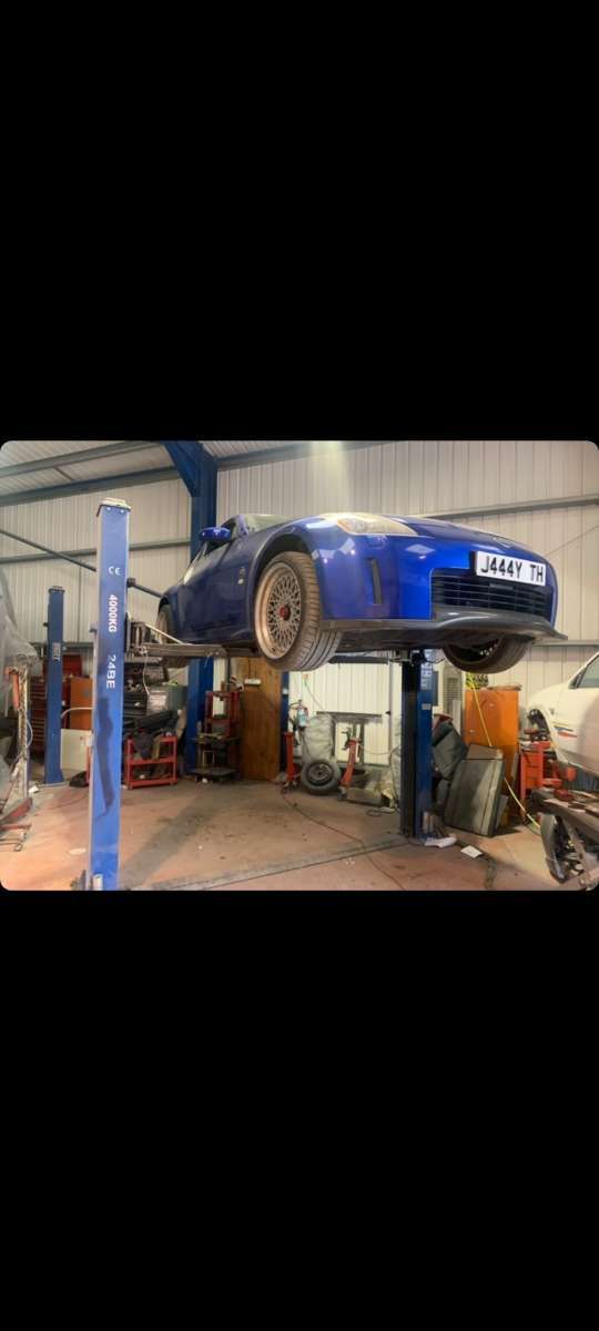

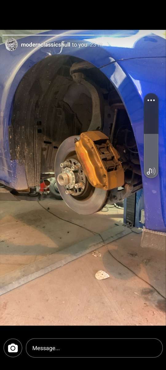

Dicky Posted June 14, 2022 Author Share Posted June 14, 2022 On 11/06/2022 at 14:07, STmichael said: Cheers. It’s not that far to go if I wanted it going and like someone said being a 4x4 place they may have a little more expertise on rust protection. Let me know how you get on 👍. The guy’s name is Josh, nice guy. His ball park was £550. They keep the car for about a week while they fully steam clean (must be stem cleaned) the underside, then after drying time treat with a rust inhibitor, then apply the Dinitrol to the underside and box sections. There were several Landrovers on their forecourt and a six week waiting list. Had a look at one on the ramps in process and it all looked good. I got a good feeling about him, his guys and the place and felt they’d make a good job. I’m booked in for beginning of August. By the way they can replace the W brace and kidney joints if required, don’t have a price for that as yet. 1 Quote Link to comment Share on other sites More sharing options...
STmichael Posted June 14, 2022 Share Posted June 14, 2022 Sounds like you have found a decent place. Let me know how you get on. The W brace was replaced on my car just before it was purchased but not sure about the kidney brackets although it had just past its test. it would be a good idea for you to replace them and then get a coating on them. 👍 1 Quote Link to comment Share on other sites More sharing options...
Dicky Posted July 18, 2022 Author Share Posted July 18, 2022 Been to Stagshaw this morning to firm up prices for the W brace, if I supply the parts he recons it’s will only be a couple of Hrs Labour at circa £80/hr so not bad. Now to find a decent price for the kidney joints and bolt set. can anyone confirm that all that’s required for the W Barack job is A W brace 2 kidney joints A bolt set ?? and if you know where to get a decent price for these I’d like to know if you don’t mind. Thanks 1 Quote Link to comment Share on other sites More sharing options...
