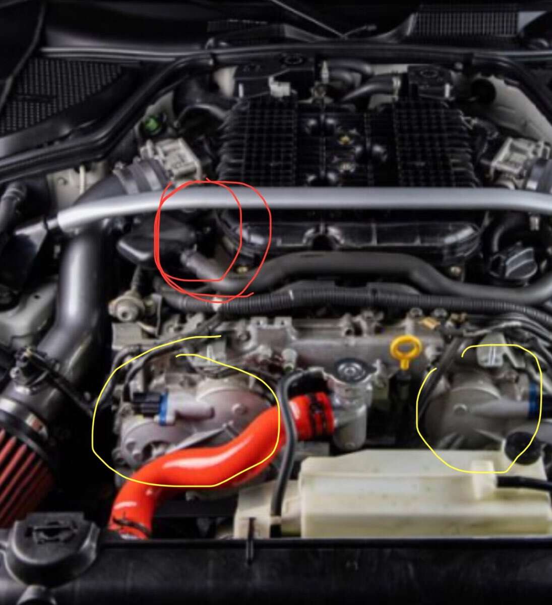

I have sputtering and rpm hesitation after only warm up between 1000 to 15000 rpm
these results confirmed by driving long distance with every try just to confirm the results
vtc issue - the yellow marks in the pic
1 - disconnected both sides = issue gone
2 - disconnected right side only = issue gone
3 - disconnected left side = issue gone
4 - plugged both sides = got the issue back
Really want to confirm before I waste more and more money
My oil pressure is warm idle between 8-10psi , 2000rpm is around 38 psi , cold start around 80 psi
I am living here in dubai with weather temperature up to 43 degrees
I know the gallery gaskets needs to replaced but for now ,This sputtering will be fixed after I replace this vtc or the oil pressure will be the main issue? , I know and saw in groups some guys their oil pressure that 8 psi and they don’t have this sputtering
if the replacement will fix , do I need to replace both sides full covers assembly or just the variable valve timing solenoid
is there any possibility of any other warn parts effecting the vtc functions like bad pcv valve or others
