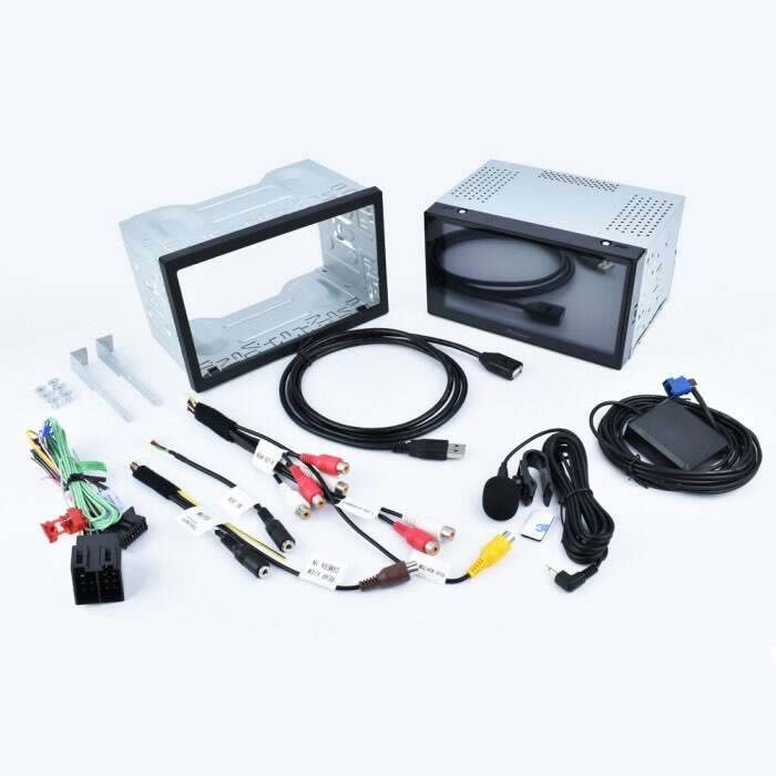

corbsy Posted April 27, 2022 Share Posted April 27, 2022 Anyone got this in their car? After trying to install a replacement Bose, I gave up keeping it original and just bought this. Not great with electronics and all, but it has 3 preouts at 2v. Heard that there may be some problems with that? Not too sure on the ohms, and I think I read that the 350z Bose system was 2Ohms and I shouldn't mix them up otherwise I'll have to replace the entire setup. Hopefully will have it delivered by the afternoon tomorrow and play a little hookie with work. Quote Link to comment Share on other sites More sharing options...

corbsy Posted April 28, 2022 Author Share Posted April 28, 2022 These are the items that come with the head unit Quote Link to comment Share on other sites More sharing options...

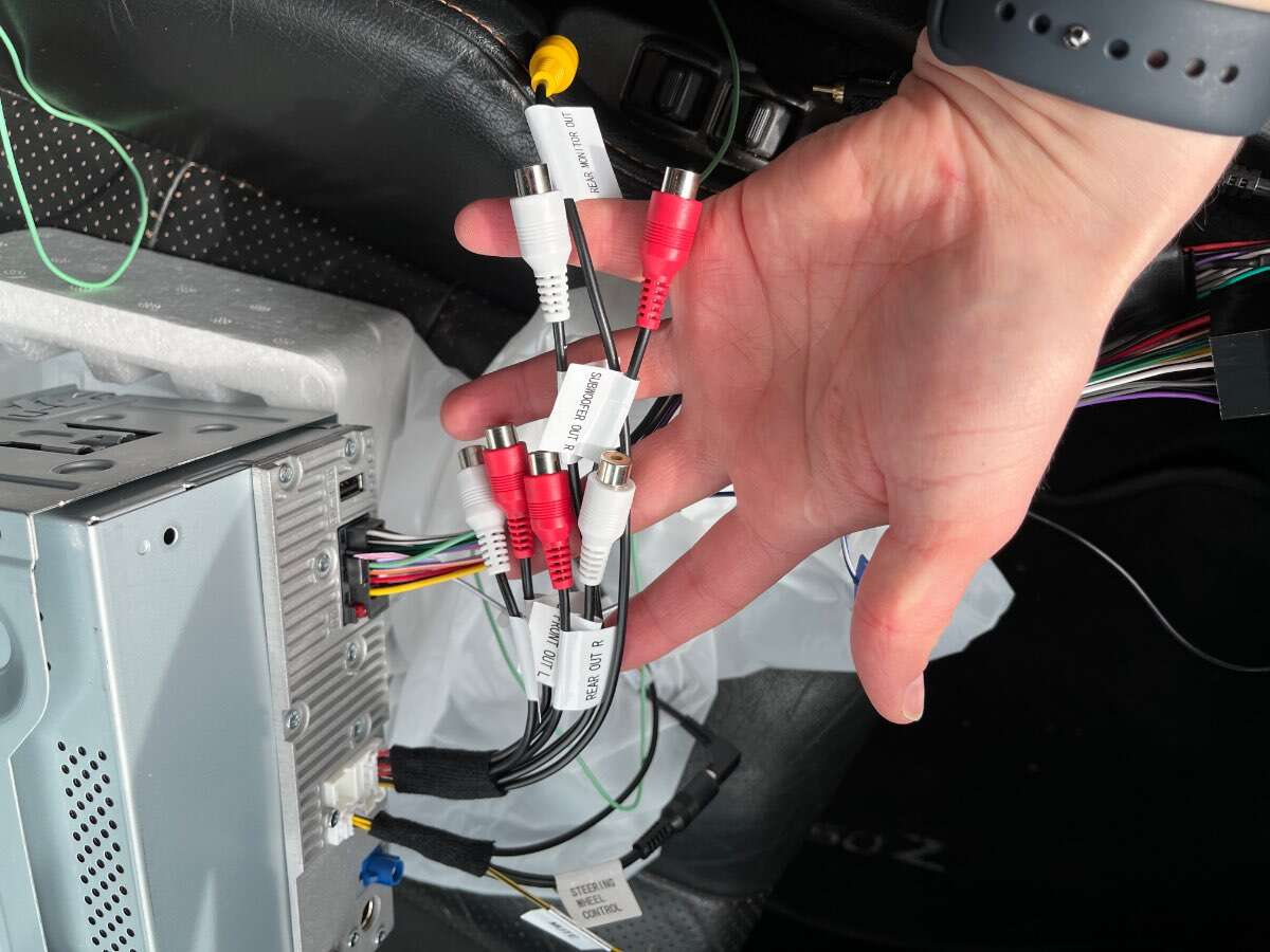

corbsy Posted April 30, 2022 Author Share Posted April 30, 2022 I’ve managed to get the stereo working but now I have no sound. There is an amplifier remote turn on lead and I don’t know where to plug this in. There is also a pre out connector on my head unit but has 7 phono leads, whereas the incartec fk-256 only has 4-5 male phono cables. So I need yet another adaptor? Quote Link to comment Share on other sites More sharing options...
corbsy Posted April 30, 2022 Author Share Posted April 30, 2022 Quote Link to comment Share on other sites More sharing options...
Tomato Posted April 30, 2022 Share Posted April 30, 2022 From memory you have to connect that blue amp wire to something and you will get sound. I remember criping it to another wire, someone will know. Quote Link to comment Share on other sites More sharing options...
corbsy Posted April 30, 2022 Author Share Posted April 30, 2022 So I was able to get the stereo working and it seemed that I was being an idiot and missed what was right in front of my eyes. There was a sticker on top of the wire that needed to be plugged into the bullet adapter. So amp works but I still have the same problem: I have 6 phono connections which are specifically for the front, rear and sub (left and right) but I have a red, white, black and yellow cable which doesn't appear to be designed for this head unit. I will probably have to speak to Pioneer to see if they supply an RCA adapter compatible with the zed. I wonder if there is a way of converting the two. But at least for now I can get sound working on the front and rear, but my sub isn't working. I think I need to take it to an auto electrician! Quote Link to comment Share on other sites More sharing options...

corbsy Posted May 1, 2022 Author Share Posted May 1, 2022 Thanks all. I fixed it in the end after speaking with cs2000; I needed to buy an additional harness which I picked up in Halfords for £9, did the buster mod and now everything works! The last problem I have is that the head unit doesn't fit properly. I'll need to drill some new holes in the original radio mounts. For now, however, I'm happy that all speakers and bass are working, and it's ridiculously loud! There is only a little gap at the bottom but the centre console will not fit all the way in. Quote Link to comment Share on other sites More sharing options...
