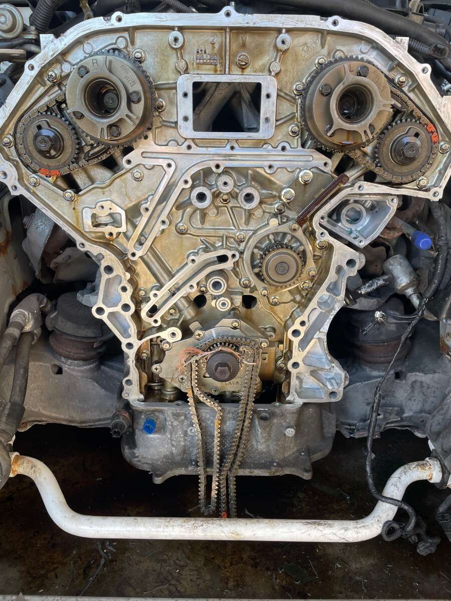

Hodgson Posted July 2 Author Share Posted July 2 Couple of oil gallery pics I took. Quote Link to comment Share on other sites More sharing options...
Hodgson Posted July 2 Author Share Posted July 2 Quote Link to comment Share on other sites More sharing options...

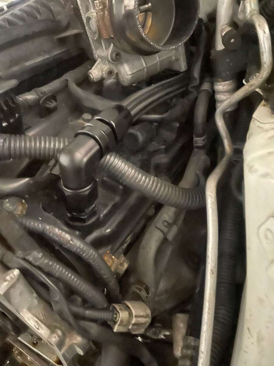

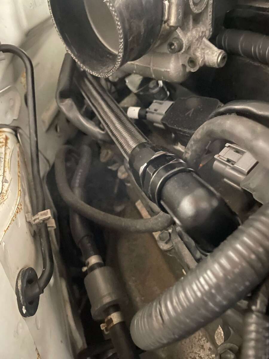

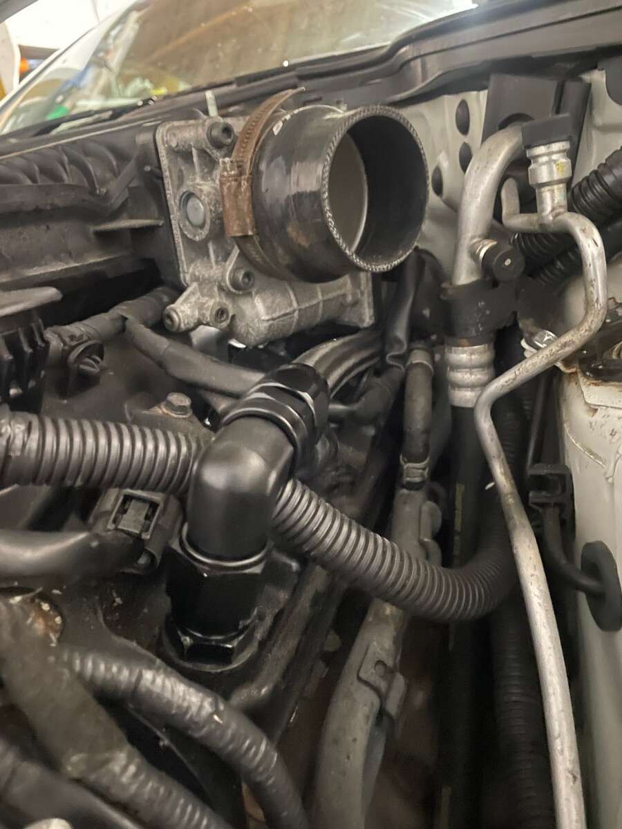

Hodgson Posted July 3 Author Share Posted July 3 Few pictures of my PCV delete. I chose to run the pipes over the back of the gearbox rather than round the front of the engine. As I’m going all white under the bonnet I didn’t want oil mist getting everything dirty. 1 Quote Link to comment Share on other sites More sharing options...

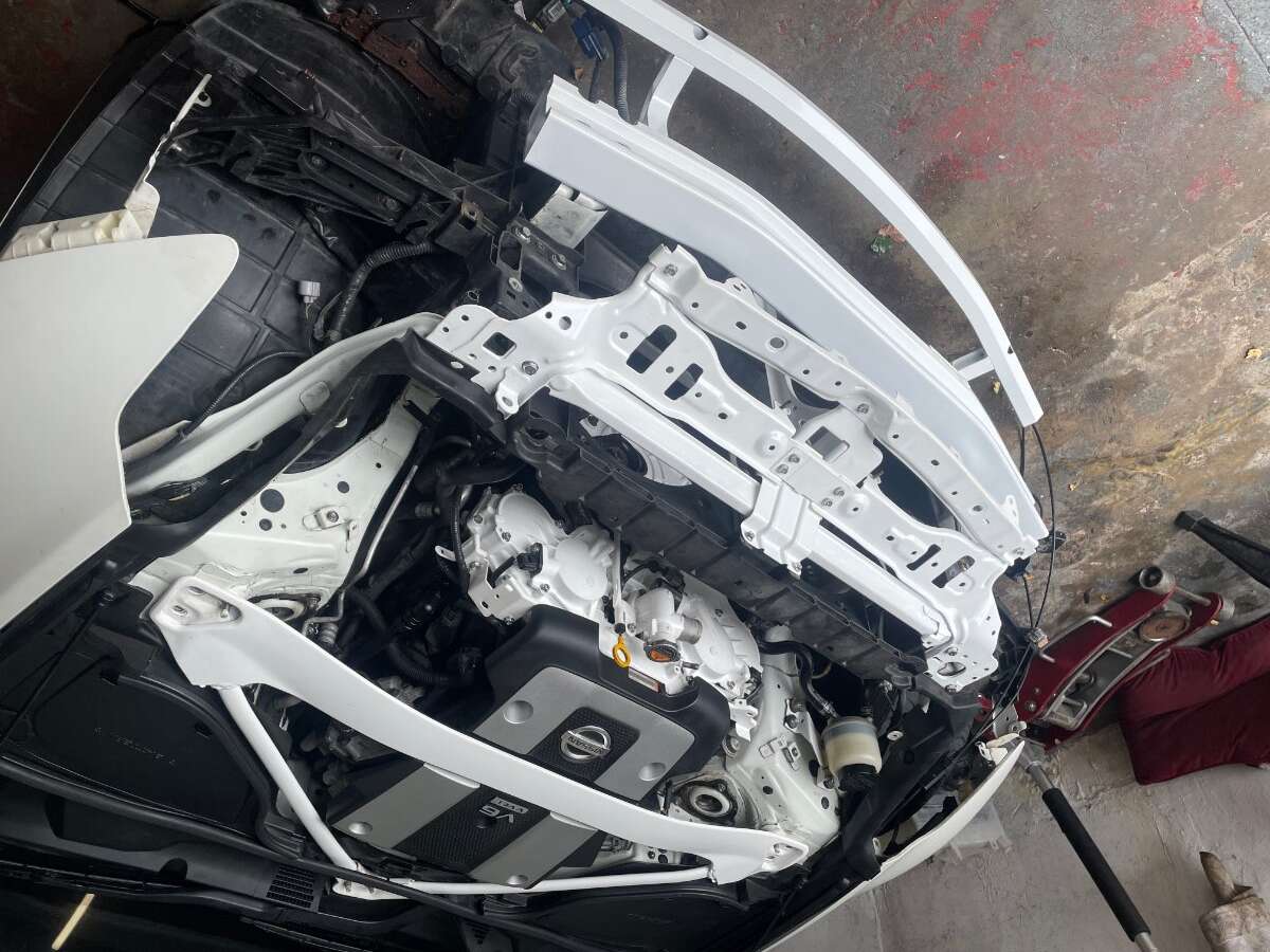

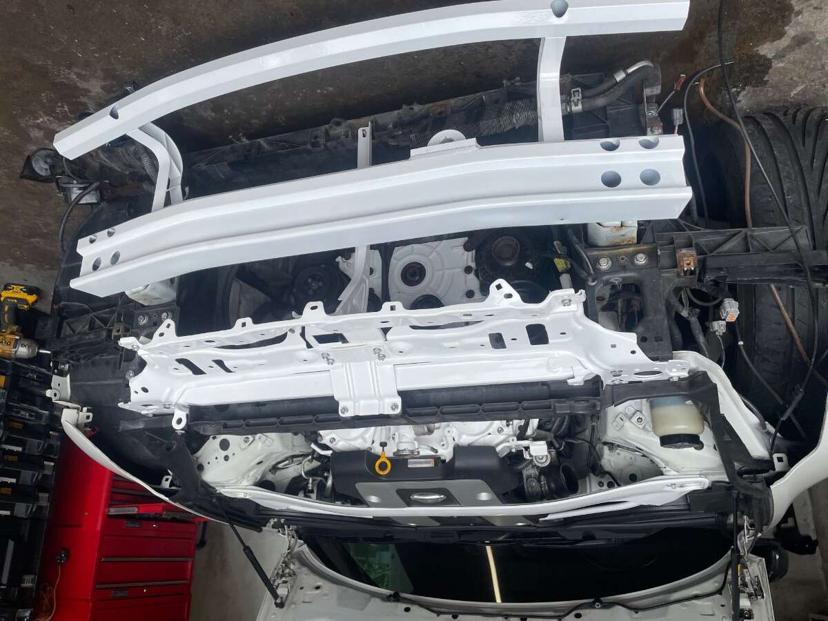

Hodgson Posted July 9 Author Share Posted July 9 Started the reassembly today. Got quite a bit done today. 2 Quote Link to comment Share on other sites More sharing options...

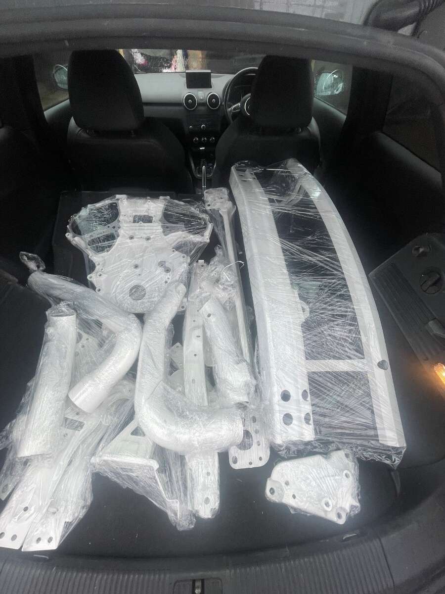

Hodgson Posted July 12 Author Share Posted July 12 A big of tidying up today and test fitted some of the front of the car. Couldn’t for the life of me remember where it all went but I think I’ve worked it out. I need a crank pulley and a new crank pulley bolt. I was going to go lightweight underdrive but the plan is to supercharge so don’t want to slow the charger rotation with a smaller crank pulley. Does anyone have a crank pulley and bolt for sale please? Also need a Mishimoto aluminum rad. I messaged ZmanAlex but unfortunately he has none in stock only 350z. here’s a few pics of his today went. If anything loos in the wrong place, please shout up 😁 1 Quote Link to comment Share on other sites More sharing options...

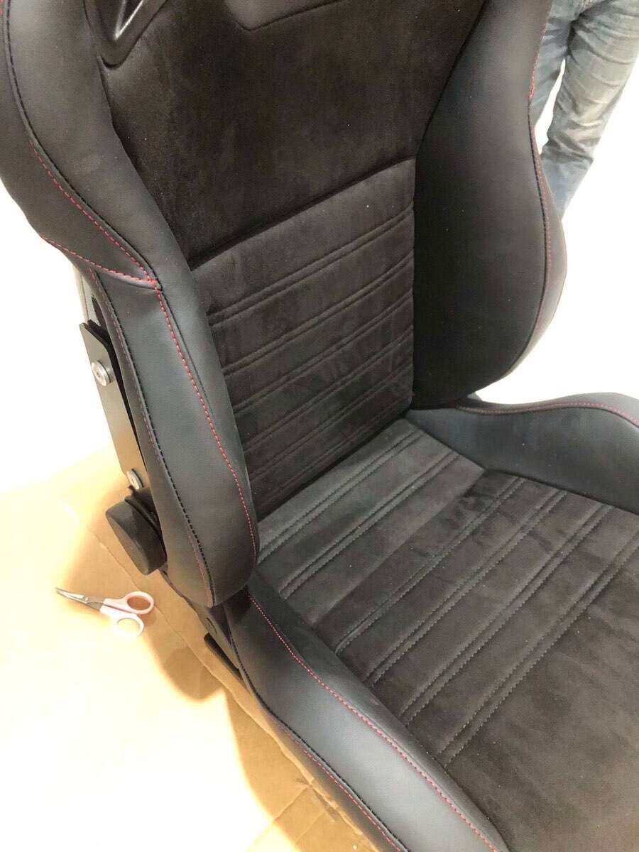

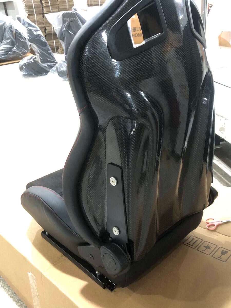

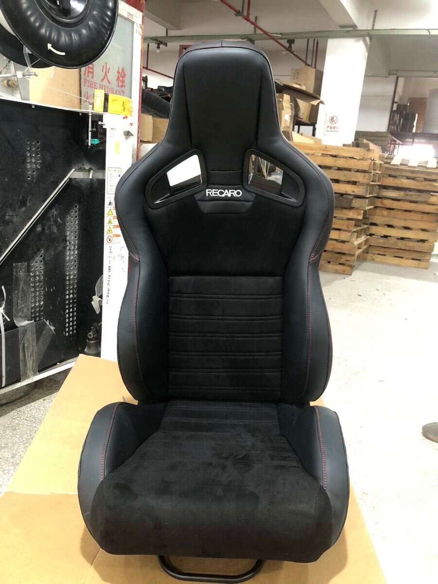

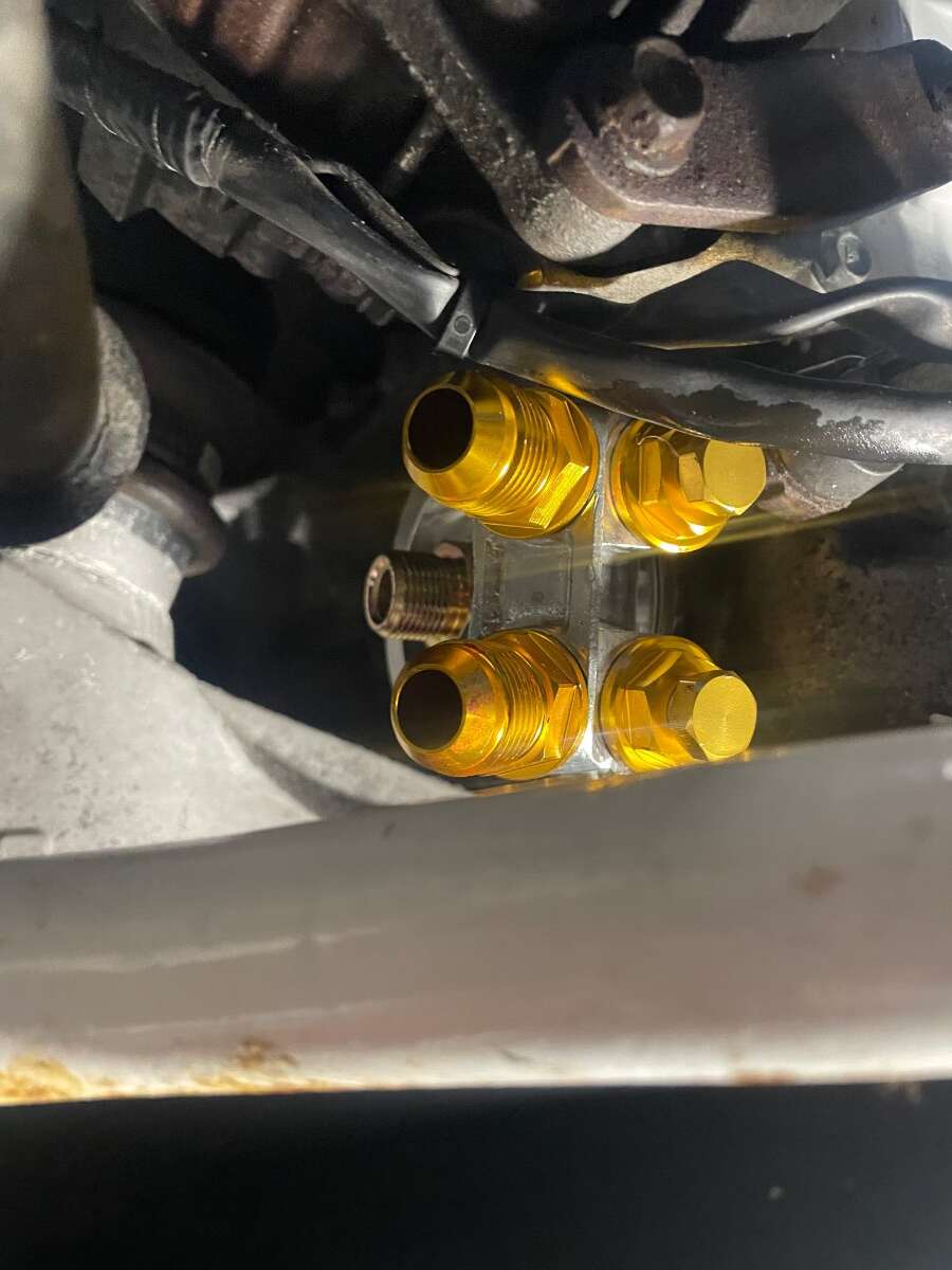

Hodgson Posted July 23 Author Share Posted July 23 Started to mock up a remote coolant reservoir. I got a Greddy kit online for a bit of a steal. I’ll need to change the fittings but the concept is there. I’m happy with the location, however, I want to rotate it 90 degrees to help con-seal the pipework. I just hate the large ugly OEM coolant tank, at the dying of the engine and want the bay as clear from wires, pipework and ugly stuff as possible. I’ve also started a custom oil cooler setup. After removed the OEM oil modine, I’ve fitted a thermostatically controlled sandwich plate. After a bit of searching I found one with ports for sensors as eventually I want to run an oil pressure sensor. I ordered a set of carbon backed Recaro CS seats back in May and they’ve just turned up. I didn’t want to go with the usual red Nismo seats as I prefer a dark interior and the red just doesn’t do it for me. I’m busy trying to source some base mounts, however, everywhere seems to be out of stock. Rather than separate sliders and base mounts, I’m thinking to go with a set of Bride runners and be done with it. I did consider fitting the OEM seat elements to the Recaro seat. I stripped the OEM seats down and took the heating elements out, but I couldn’t bring myself to strip down the Recaros 🙈. I’ve got a couple of 2.2ohm resistors on order for the airbag plugs, but need to work out how to bypass the passenger seat occupancy pressure sensor. ill get some photos of my progress up soon as soon as I can understand why every time I upload a picture it appears upside down. Quote Link to comment Share on other sites More sharing options...

Hodgson Posted July 28 Author Share Posted July 28 (edited) Parts arrived on Friday so I had an hour or so to fit done of them. Low temp thermostat, Alloy Rad, which I’m really impressed with the quality if I’m honest. They’ve clearly listened to feedback and upped their game. 25 row oil cooler which I’m going to make up my own custom lines. I’m also going to put together a fuel return kit but more detail on that to come later. I’ve got done bride subframes for my seats on order from Japan but it’s a 4 week wait. Edited July 28 by shiney bits Quote Link to comment Share on other sites More sharing options...
