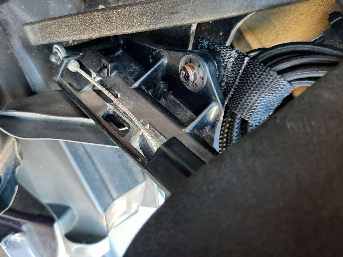

pintopete58 Posted March 26, 2022 Share Posted March 26, 2022 (edited) The old bungee strap was so weak and it only had 6 straps new one has 8. If you are poor with a spanner do not attempt Edited March 27, 2022 by pintopete58 Quote Link to comment Share on other sites More sharing options...
pintopete58 Posted March 26, 2022 Author Share Posted March 26, 2022 (edited) Hi all with 370 roof problems. Bungee straps replacement . started repairing my 370z roof yesterday . I might be able to help. Looks confusing I know The cramp Is to expand the bungee so it links up with the bolt hole. Managed it on my own Edited March 27, 2022 by pintopete58 More info Quote Link to comment Share on other sites More sharing options...
ShortPaul Posted March 28, 2022 Share Posted March 28, 2022 On 26/03/2022 at 17:25, pintopete58 said: Hi all with 370 roof problems. Bungee straps replacement . started repairing my 370z roof yesterday . I might be able to help. Looks confusing I know The cramp Is to expand the bungee so it links up with the bolt hole. Managed it on my own Fair shout sir, it looks a pig of a job Quote Link to comment Share on other sites More sharing options...
ZMANALEX Posted March 28, 2022 Share Posted March 28, 2022 Done a few of these on the 350, must say not my favourite past time. Can be a time consuming , tricky and frustrating job requiring considerable patience. Quote Link to comment Share on other sites More sharing options...
pintopete58 Posted March 28, 2022 Author Share Posted March 28, 2022 Hi Alex I think the 350 is slightly easier very time consuming but after 1st side it did get easier and yes you need the patience of a Saint Quote Link to comment Share on other sites More sharing options...
pintopete58 Posted March 28, 2022 Author Share Posted March 28, 2022 Just a bit Paul haha Quote Link to comment Share on other sites More sharing options...
