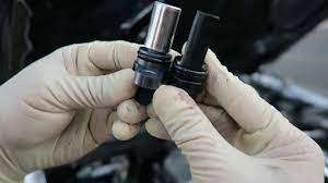

ZMANALEX Posted March 20, 2022 Share Posted March 20, 2022 1 hour ago, davey_83 said: https://h-dev.co.uk/product/hitachi-350z-de-cam-sensor/ http://www.clarkmotorsport.co.uk/parts/Camshaft-Position-Sensor-Bank-1/23731-6J90B Both these are the old style sensor and both have been superseded. You do not want to fit the old style plastic sensor, fit the metal cylindrical type. 2 Quote Link to comment Share on other sites More sharing options...
davey_83 Posted March 20, 2022 Share Posted March 20, 2022 17 minutes ago, ZMANALEX said: Both these are the old style sensor and both have been superseded. You do not want to fit the old style plastic sensor, fit the metal cylindrical type. Pretty sure those details from Hdev and CMS are for illustration purpose only, well I know they are as when I bought mine some years back from CMS the picture was a such however the later style sensor arrived. 2 Quote Link to comment Share on other sites More sharing options...
