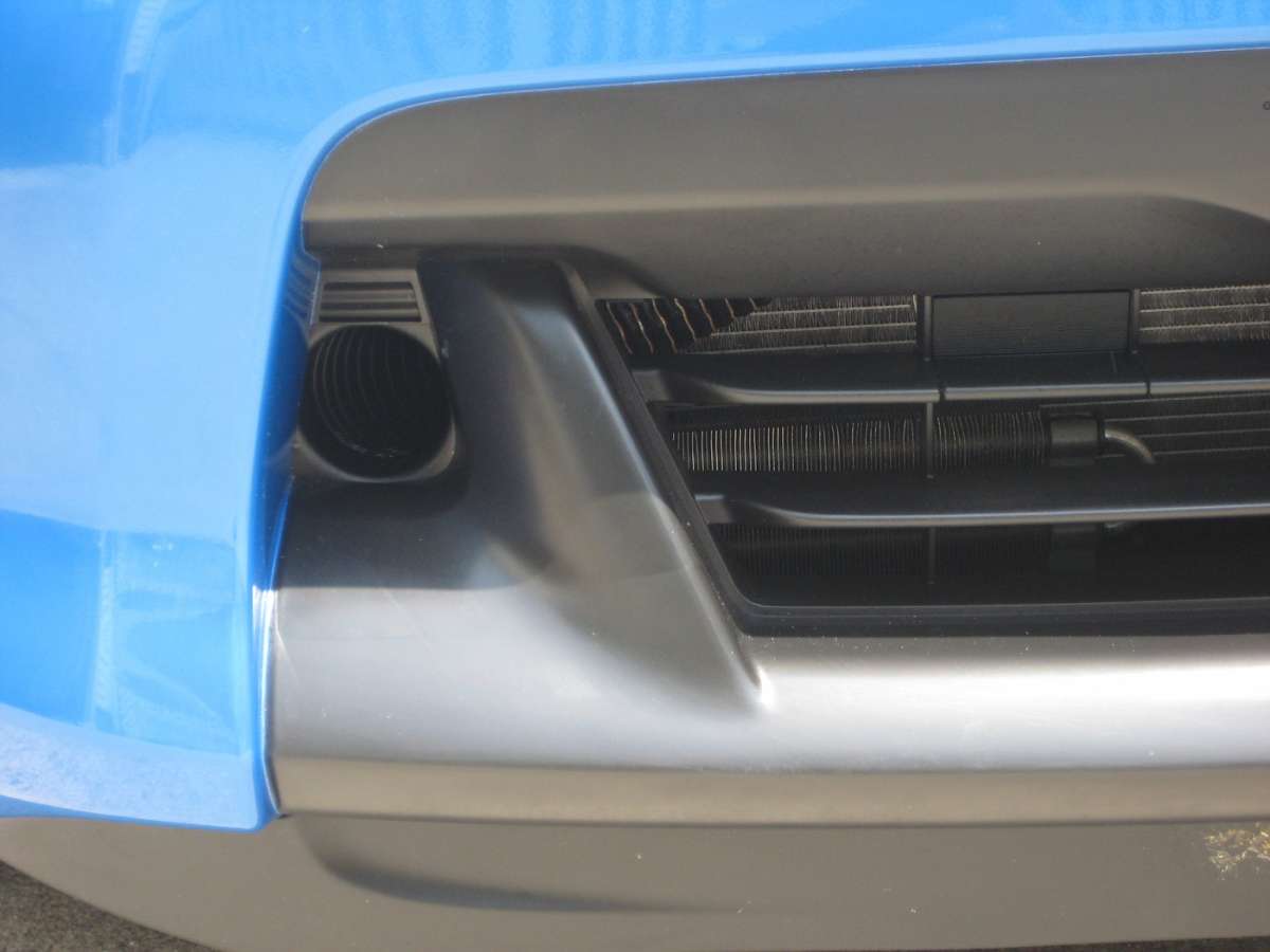

StormtrooperZ Posted February 5, 2022 Author Share Posted February 5, 2022 Been googling a fair bit on vents and ducting etc. Some guy in the state's did this - almost looks OEM 😎 1 Quote Link to comment Share on other sites More sharing options...
Willsy1980 Posted February 5, 2022 Share Posted February 5, 2022 That looks bloody good, less destructive than carving holes out the front too. Plus that flexi hose they used makes it much easier to get the air where you want it 1 Quote Link to comment Share on other sites More sharing options...
StormtrooperZ Posted February 5, 2022 Author Share Posted February 5, 2022 Definitely the way to go I think. Just need to source the flanges/adapters for the hoses now. 1 Quote Link to comment Share on other sites More sharing options...
