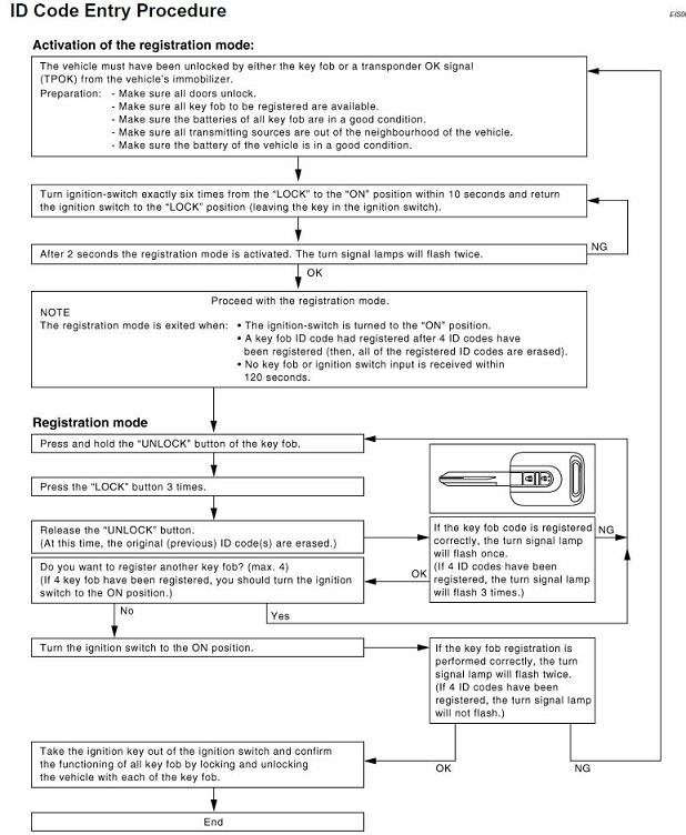

FraserKemp Posted January 21, 2022 Share Posted January 21, 2022 Hello, had my Z for a fair while now and wanted some better looking keys. I know you can get some 4 button style key fobs from America but I wanted to check to see if you can actually link them to a European 350Z. I've attached a photo of the ones I'm on about. I've heard keyfobs can be very fiddly with Z's. Thanks anyway Quote Link to comment Share on other sites More sharing options...
Coz@TORQEN Posted January 21, 2022 Share Posted January 21, 2022 Hi, Not sure in terms of using the US style key fobs, I suspect it would be absolutely fine. You can find the programming instructions here if you do decide to try it, this should be the programming procedure for it: Quote Link to comment Share on other sites More sharing options...
FraserKemp Posted January 21, 2022 Author Share Posted January 21, 2022 1 hour ago, Coz@TORQEN said: Hi, Not sure in terms of using the US style key fobs, I suspect it would be absolutely fine. You can find the programming instructions here if you do decide to try it, this should be the programming procedure for it: Great, I might give it a shot one of my mates has a spare so ill put it in here if it works. Thanks a lot for the reply ! Quote Link to comment Share on other sites More sharing options...
