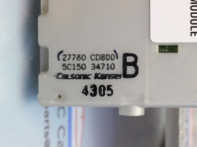

ZMANALEX Posted January 19, 2022 Share Posted January 19, 2022 As what Paul has said, it will be the Air Con Climate Control Module or Ribbon. You will require to match with the part number and code which is on the unit. I should have this in stock if required. Example image below of numbers referred to: Just drop me a PM if I can help further. Quote Link to comment Share on other sites More sharing options...
jedethridge Posted January 22, 2022 Author Share Posted January 22, 2022 Thank you all for the advise, I have gotten the PN and code and will confirm whether this fixes the issue when I source a new unit. Quote Link to comment Share on other sites More sharing options...
