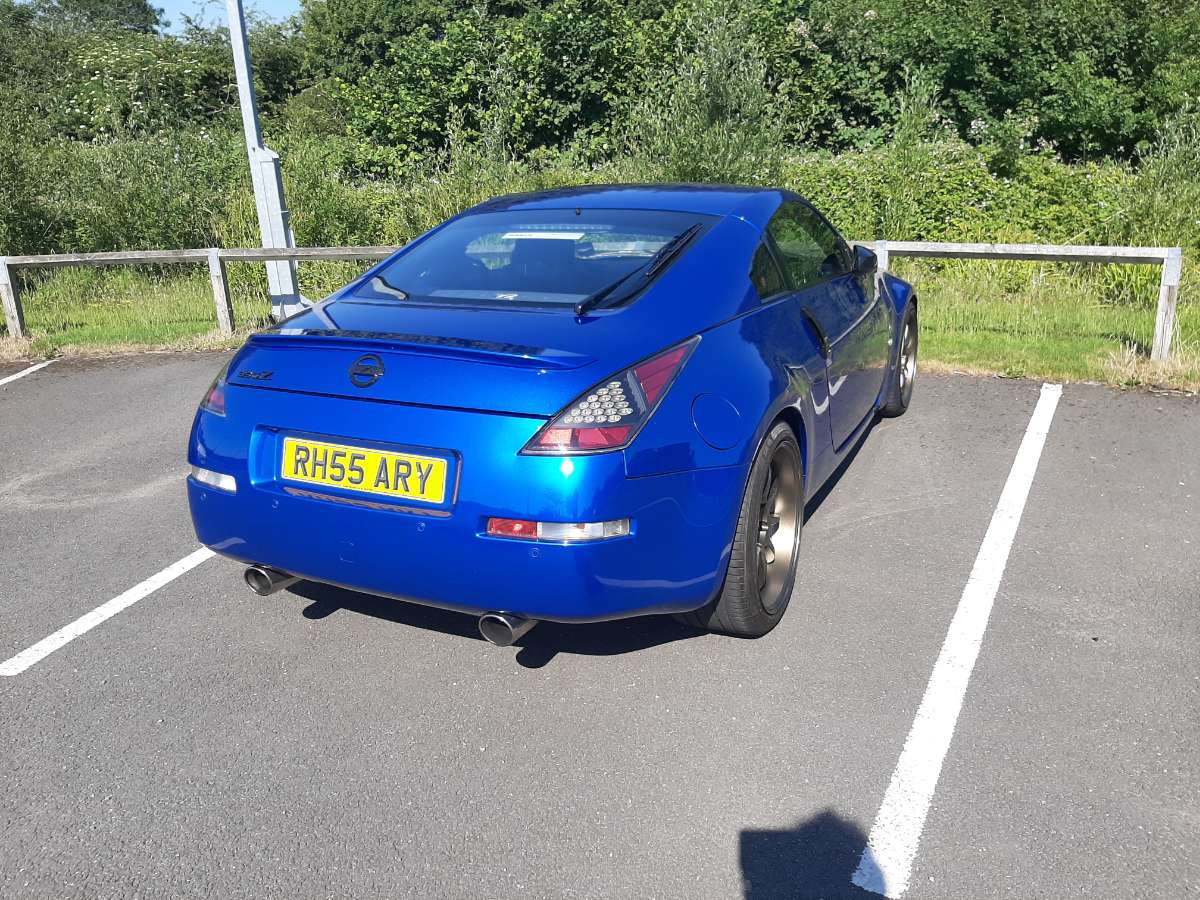

Azurez33 Posted January 5, 2022 Share Posted January 5, 2022 (edited) It’s all within the offset really, this is 9.5” front et 22 and rears 10.5” et18, also lowered but custom distance and can’t remember how far, @Monkey1983 has 3dsm 10.5s front and rear with spacers and lowered and we had some problems with touching especially over bumps Edited January 5, 2022 by Azurez33 1 Quote Link to comment Share on other sites More sharing options...
Monkey1983 Posted January 5, 2022 Share Posted January 5, 2022 24 minutes ago, Azurez33 said: It’s all within the offset really, this is 9.5” front et 22 and rears 10.5” et18, also lowered but custom distance and can’t remember how far, @Monkey1983 has 3dsm 10.5s front and rear with spacers and lowered and we had some problems with touching especially over bumps Since I fitted the smaller spacers they have been spot on really , it’s so hard to get it all exactly right , like most things when messing with cars 🤣 1 Quote Link to comment Share on other sites More sharing options...
