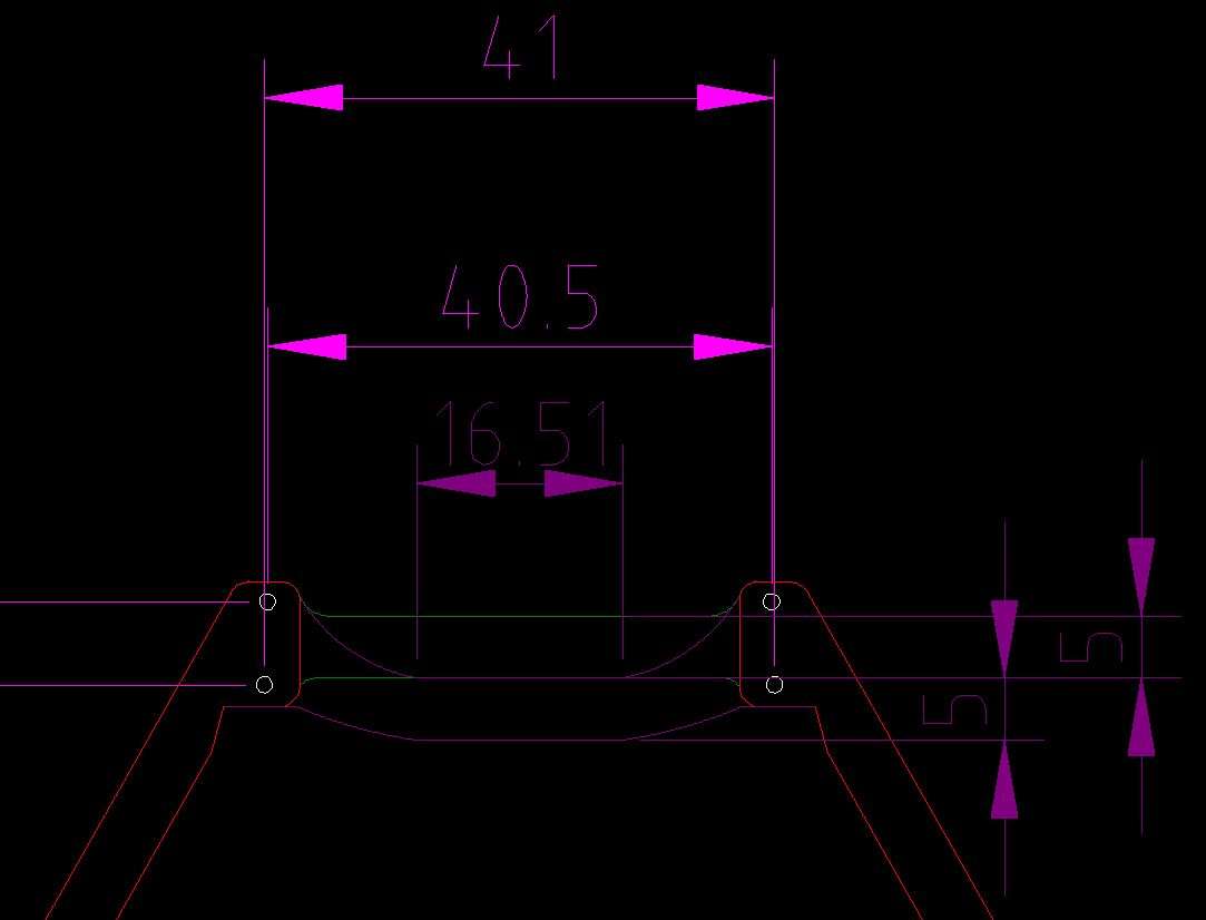

MicktZZZ Posted December 2, 2021 Share Posted December 2, 2021 (edited) Hi everyone following a post I made re my rotten W brace, I am looking at possibly fabricating a non-OEM alternative. Background is I purchased a TarmacSportz one but unfortunately it catches on my non-OEM exhaust which is 3inch diameter. I can probably return the TS brace and purchase an OEM brace but am considering having a brace fabricated for a couple of reasons, 1. OEM brace is expensive £200-ish 2. OEM brace seems prone to rot, whether that be the design being prone to collecting water etc. or materials used, or rust protection added or our climate or combination of all above So I have mocked up a design (see attached, dimensions are rough just for estimate purposes) that should fit my car main difference to TS brace being front edge moves back further approx. 30mm (to same position as OEM brace) to where exhaust curves up, and had a quote from a local laser cutting company, so a single brace made from 4mm S275 steel unfinished is £90+VAT plus delivery However price if ordering 10 drops to £50+VAT unfinished plus delivery, if you want finished I can paint (or my son can 🙂) for additional £10 using Black EM121 Epoxy Rust Proofing Paint from Rust Buster, so total finished inc VAT would be £70 plus delivery Lead times quoted are 3-4 days dependent upon material supply And delivery would be at buyers cost, or collection possible from Sheffield area Anyway before I go ahead I wanted to gauge if there is enough group interest to reach the 10 quantity, if there is I will do a bit more design work to consider other non-OEM exhausts to try and ensure brace would fit majority of after market exhausts (may need your help with this but if the OEM brace fits your car this design should), either way I will be ordering one as it seems simplest solution to getting a brace I know that fits that will be of similar performance and standard of non-OEM braces available 03/12 - Quick Update, brace will be 5mm same as TS one which has increased single price to £97+VAT but not effected 10 price, have added a couple of pictures of a prototype, I still think front edge needs to go further back maybe another 10mm, so will try a quick re-design Anyway if interested let me know and I will start a list off 03/12 - So far we have👍 Me 🙂 Andy_Muxlow Oggieteepo harrison140 06/12 Adding ballistic 07/12 adding zelda RavenDW 14/12 adding bluethermal Luigi350z Update 08/12 - Have mocked up a final prototype (one on left in picture) based upon my CAD model (that was fun learning CAD !), final design sees the front edge moving back 50mm from the TS brace position (shown in green in CAD image), the front edge is straight for about 16.5cms so should accommodate dual systems and gives me 12-13mm of clearance which I hope would be plenty, could go back a little further but I start to get close to my middle box, just going back to check quote with company, and as I'm getting close to numbers now so if you can check your system and let me know if this will fit your car, cheers Edited December 14, 2021 by MicktZZZ 1 Quote Link to comment Share on other sites More sharing options...

ballistic Posted December 3, 2021 Share Posted December 3, 2021 (edited) Ive got a true dual 3" APS exhaust. I have a feeling i would have the same problems with aftermarket ones as you. Im interested One question, is 4mm S275 steel thick enough? Bearing in mind that many aftermarket brace are designed to work alongside the OEM W brace. Edited December 3, 2021 by ballistic Quote Link to comment Share on other sites More sharing options...
MicktZZZ Posted December 4, 2021 Author Share Posted December 4, 2021 9 hours ago, ballistic said: Ive got a true dual 3" APS exhaust. I have a feeling i would have the same problems with aftermarket ones as you. Im interested One question, is 4mm S275 steel thick enough? Bearing in mind that many aftermarket brace are designed to work alongside the OEM W brace. Hi yes your right I've checked the TS brace and it's 4.9mm so 5mm should be OK, I have updated original post but this only effects single price by a few quid, cheers will add you to list👍 Quote Link to comment Share on other sites More sharing options...
MicktZZZ Posted December 4, 2021 Author Share Posted December 4, 2021 1 minute ago, MicktZZZ said: Hi yes your right I've checked the TS brace and it's 4.9mm so 5mm should be OK, I have updated original post but this only effects single price by a few quid, cheers will add you to list👍 Just read your question again I'm pretty sure the aftermarket braces are designed as replacement for oem brace I've read quite a few posts and watched the videos on TS and they show them replacing Oem brace Quote Link to comment Share on other sites More sharing options...

MicktZZZ Posted December 5, 2021 Author Share Posted December 5, 2021 Did think about it but seen people saying it wouldn't have the same stiffness plus material more expensive, I'm thinking the problem why the oem rots is down to the design being prone to collect and hold crap so I'm thinking a simpler flat bar design together with decent paint will see it last at least as long as oem one Quote Link to comment Share on other sites More sharing options...
harrison140 Posted December 5, 2021 Share Posted December 5, 2021 You are right . 5mm steel even if it rusts will last a lot longer than the OEM Quote Link to comment Share on other sites More sharing options...

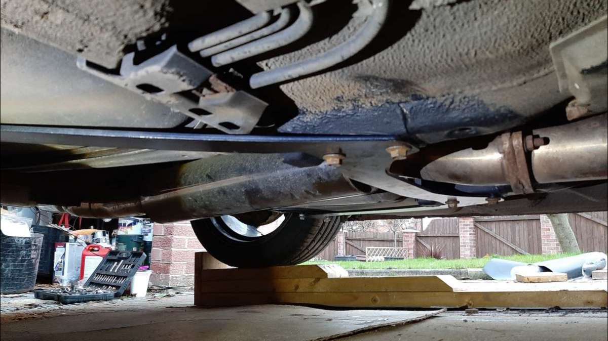

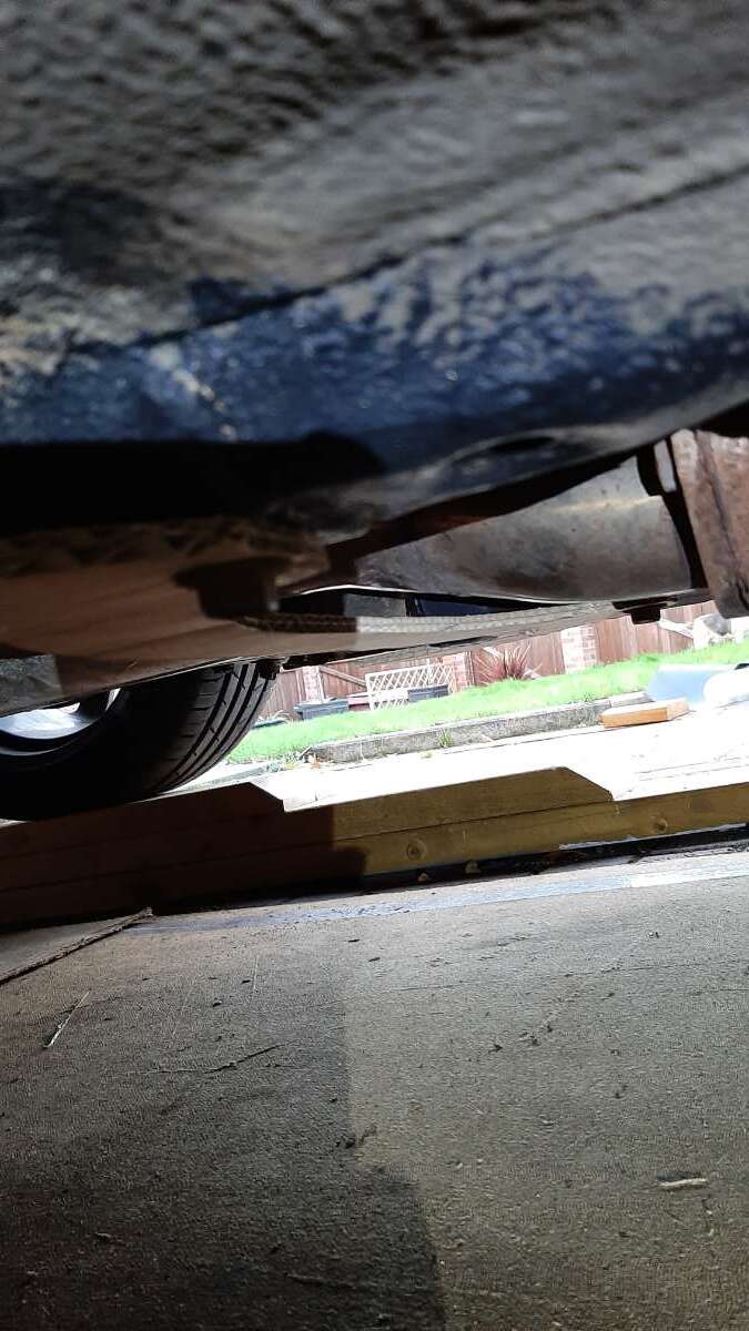

MicktZZZ Posted December 20, 2021 Author Share Posted December 20, 2021 Hi all well collected braces today, they look great or as well as a piece of metal under the car can look 🤣 Good news is they fit, I must have checked measurements 10 times but was still unsure until I got them back, and no long catches my exhaust Plan is to de-grease them and paint over holidays and then ship them in January to avoid Xmas post issues plus lets everyone get remaining cash together, unless anyone needs it urgent if so let me know. if you want to start sending your addresses I will prep the parcels, delivery will be £9 via Hermes next day Pictures of unpainted brace fitted (don't ask why they are upside down cos I don't know !!) 1 Quote Link to comment Share on other sites More sharing options...
Oggieteepo Posted December 20, 2021 Share Posted December 20, 2021 (edited) Great stuff... I don't know what's more Impressive the W-brace or your 'Ramps' 😂 Anywho, I'm off to chop some corners off some wood! Edit: added flipped image Edited December 20, 2021 by Oggieteepo Added image :) 1 Quote Link to comment Share on other sites More sharing options...
RavenDW Posted December 20, 2021 Share Posted December 20, 2021 Looks good, Mick. 👍 You've also reminded me I need to make a second 'ramp'. Time to go hunting for more scrap wood. 1 Quote Link to comment Share on other sites More sharing options...
