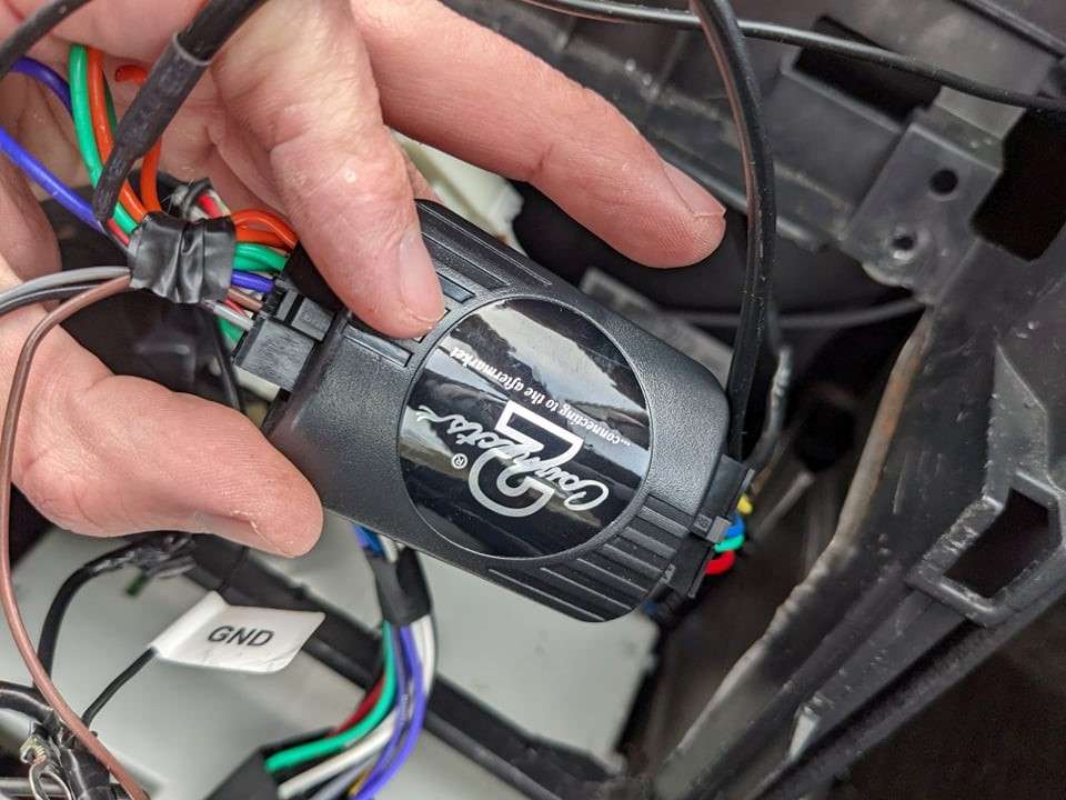

Lorenzo Posted December 5, 2021 Author Share Posted December 5, 2021 Bump... I have tried the manual reset on the aftermarket stereo, no change. I have also taken the stereo out and the fuse is fine on the back of it. The driver side sub is still popping every now and then and stereo not working. Any pointers on this one? Assume next is to check the sub wiring or such, it was a mess behind the stereo with wiring so potentially an issue there but I don't claim to be an electrician! And disclaimer I did not install the aftermarket head unit 😅 Quote Link to comment Share on other sites More sharing options...
Zoolander Posted December 5, 2021 Share Posted December 5, 2021 Is that metal loop on the black wire ground related perhaps? Connect 2 I would assume is for steering wheel controls so that you can you the buttons on the OEM wheel, doubt that would be causing you any issues. When I had a similar issue on another car I gave in and took it to a Car Audio specialist, those guys can trace faults so quickly generally speaking that it might be less of a headache. Quote Link to comment Share on other sites More sharing options...

Lorenzo Posted December 6, 2021 Author Share Posted December 6, 2021 Yeah the metal loop was bolted to the stereo holder frame through one of the bolts. And no, no power to head unit at all. But weirdly the speaker behind the driver seat pops every now and then (the most annoying part). I may just take it to an auto electrician like you say, there are a couple good ones in Bristol it seems. Cheers. Quote Link to comment Share on other sites More sharing options...
Sim Posted December 6, 2021 Share Posted December 6, 2021 4 hours ago, Lorenzo said: Yeah the metal loop was bolted to the stereo holder frame through one of the bolts. And no, no power to head unit at all. But weirdly the speaker behind the driver seat pops every now and then (the most annoying part). I may just take it to an auto electrician like you say, there are a couple good ones in Bristol it seems. Cheers. The reason for the pops is likely to be down to the separate amp being powered up but not the headunit, have you got access to a multimeter and the wiring diagram to see if power is getting to the head, it could just be a blown head sadly. Quote Link to comment Share on other sites More sharing options...
