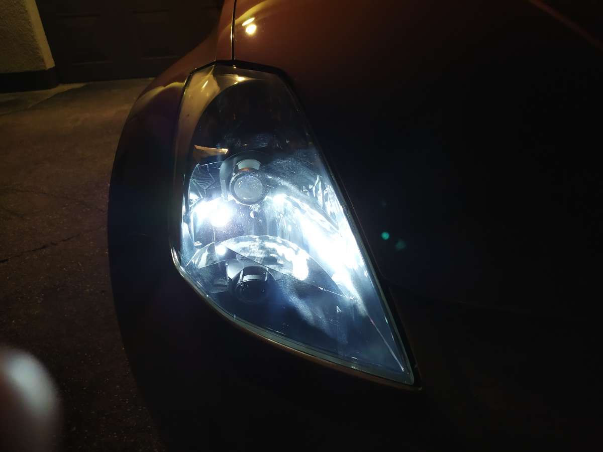

Azurez33 Posted October 29, 2021 Share Posted October 29, 2021 (edited) Yes mate usually a pain to turn as you can only get two fingers in (pahh) the little o rings get stiff (ffs how dodgy) so spray it with some lube on the way back in and shouldn’t be so bad! I’ve had these purple led ones for about 8 years now! Edited October 29, 2021 by Azurez33 1 Quote Link to comment Share on other sites More sharing options...
HEADPHONES Posted October 30, 2021 Author Share Posted October 30, 2021 Thanks for all the advice. @Jack94 the Philips bulbs are a gorgeous upgrade. Gone are the faint yellow candle like sidelights. New ones about 4x brighter in my opinion and match well with the main lights. 2 Quote Link to comment Share on other sites More sharing options...
