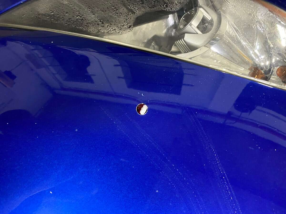

Azurez33 Posted May 3, 2022 Author Share Posted May 3, 2022 Need to get cracking on with these updates? So got some aero catches off a nice bloke in wales breaking his beauty! Let me just state- this was an absolute pain- I measure 4 times cut once and it still was a bastard! once the pins were fitted in the scuttle- used tip ex to mark where to drill- obviously drilled a little further back as the angle of bonnet would change where the pins would meet! once the holes were drilled there really wasn’t any going back! Quote Link to comment Share on other sites More sharing options...

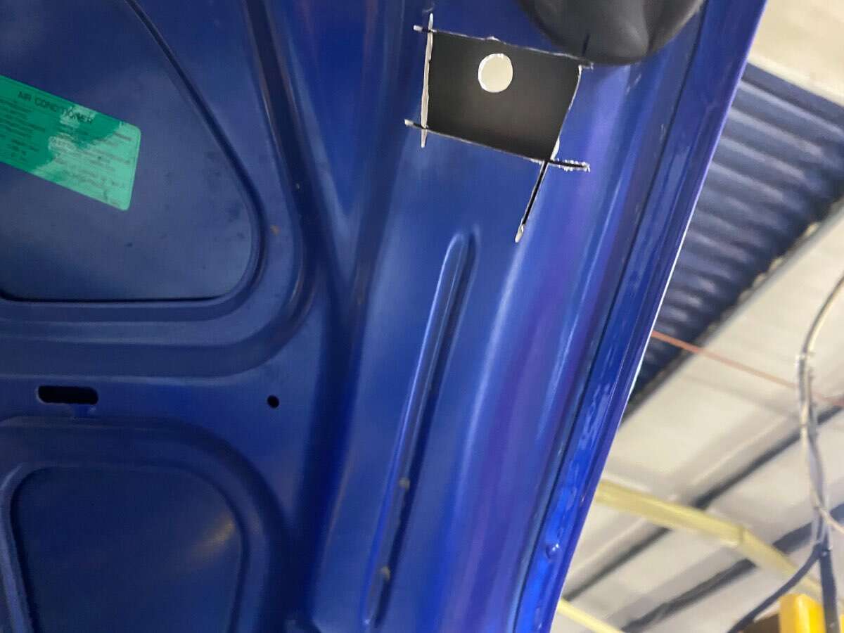

Azurez33 Posted May 3, 2022 Author Share Posted May 3, 2022 And now for the worst bit- actually cutting the catch inner shape and drilling out the holes! Using the templates was the life saver needed! However it’s making sure you get the angle right, I do think I got the near side one a few degree out compared to the offside! but hey ho! having to cut out the inner bonnet sheath to allow for the catch to sit in properly! I had to keep cutting a bit more on the side which wasn’t too bad as you can barely see it! once the inner housing was sat flush- used a scribe to mark the holes for the bolts! Once the holes were drilled, edges were smoothed off and pins were realigned! it was time to bolt them down! And check the alignment was atleast somewhat correct! Once the bonnet was down I could see the pins needed to be moved slightly and the height needed to be dropped so the close was good enough! and presto! ft horrible watery headlights Quote Link to comment Share on other sites More sharing options...

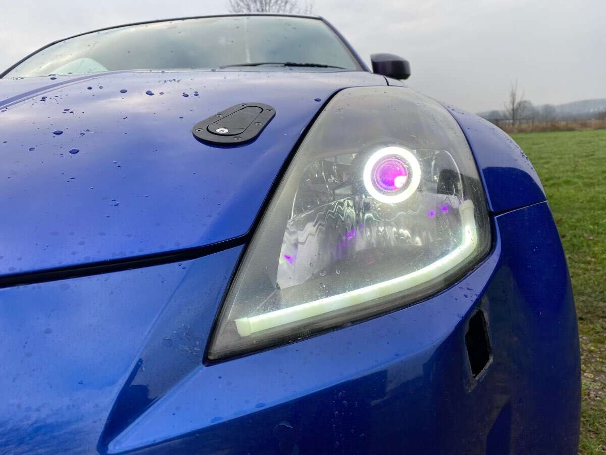

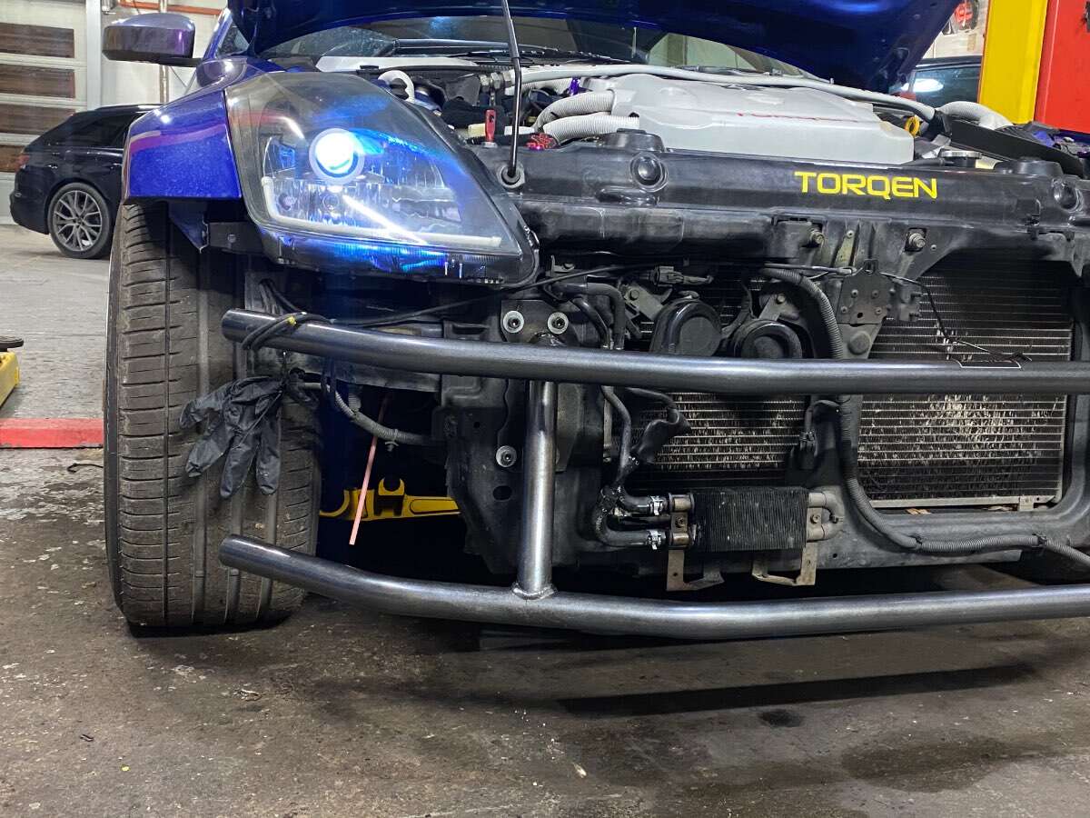

Azurez33 Posted May 3, 2022 Author Share Posted May 3, 2022 Zakustech bash bar! to replace the factory brash bar! Was really looking for a mean front look so felt that this would be the start! not sure how to work out showing it off at all! But we shall see! It did come a little damaged but nothing dreadful! turns out the Oem washer bottles don’t fit at all and have thus been removed! Lucozade bottle it is then! going to get a bottle made up! Here’s a few ideas/ attempted efforts I’ve made feat the new custome headlights from Dan! halos, rgb demon eyes and drls with a custom colour inside! really completes the look! Quote Link to comment Share on other sites More sharing options...
Azurez33 Posted May 3, 2022 Author Share Posted May 3, 2022 So a run down, Rgb demon eyes controlled via Bluetooth angel eyes drl strips graphite metal flake for the Bazel amber reflector painted over had to fix the bracket after Hermes decided to drop or damage the parcel covered in fragile tape! Cut and made new stabiliser brackets to add a bit of strengthening too! also ordered an underglow kit to fill in the the front whilst it’s dark for when I actually get the time to go to an evening show! headlights all polished and UV protected! 2 Quote Link to comment Share on other sites More sharing options...

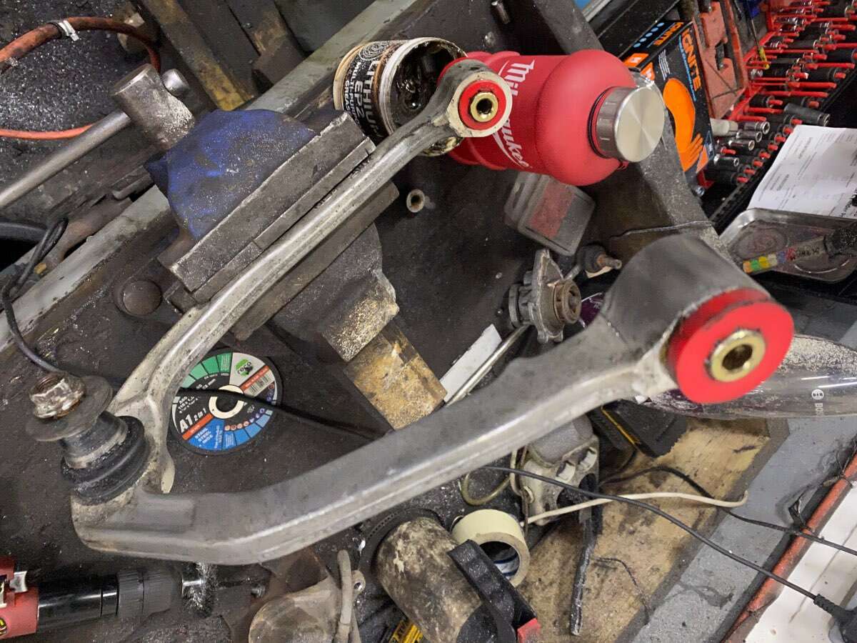

Azurez33 Posted May 3, 2022 Author Share Posted May 3, 2022 Bought some upper wishbone arms off @vroom811 so I could faff around putting the polybushes in! after removing the old ones which were actually in really good condition! the balljoints were also in good nick too so double win! unfortunately the press slipped and mangled one of the arms, so I will have to give it a go on my current arms! I cleaned up the arms whilst I was there! 1 Quote Link to comment Share on other sites More sharing options...
